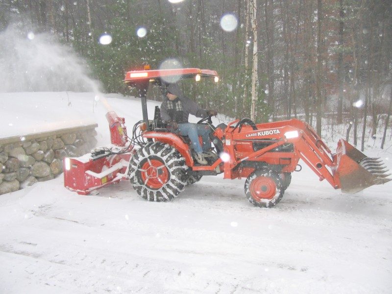

Both the Meteor and the Blizzard are good blowers. I have a 64" Puma which, based on my observations of the Blizzard, is a little bit more heavy duty.
As for whether or not you'll need a blower, let's see how your back blade handles the 8"-12" heavy wet snow that is coming down now. You still have to pile it up and use the FEL to move it out of the way. With a blower you just blow it away.
I have both back blade and blower and the back blade stays in storage for the winter while I use only the blower. I can do my 250' x 15' driveway with 75' x 55' parking area and in front of the road in about 30 minutes not counting time to move vehicles. My driveway is gravel. I would not even think of using the back blade and FEL.
Your mileage may vary.
