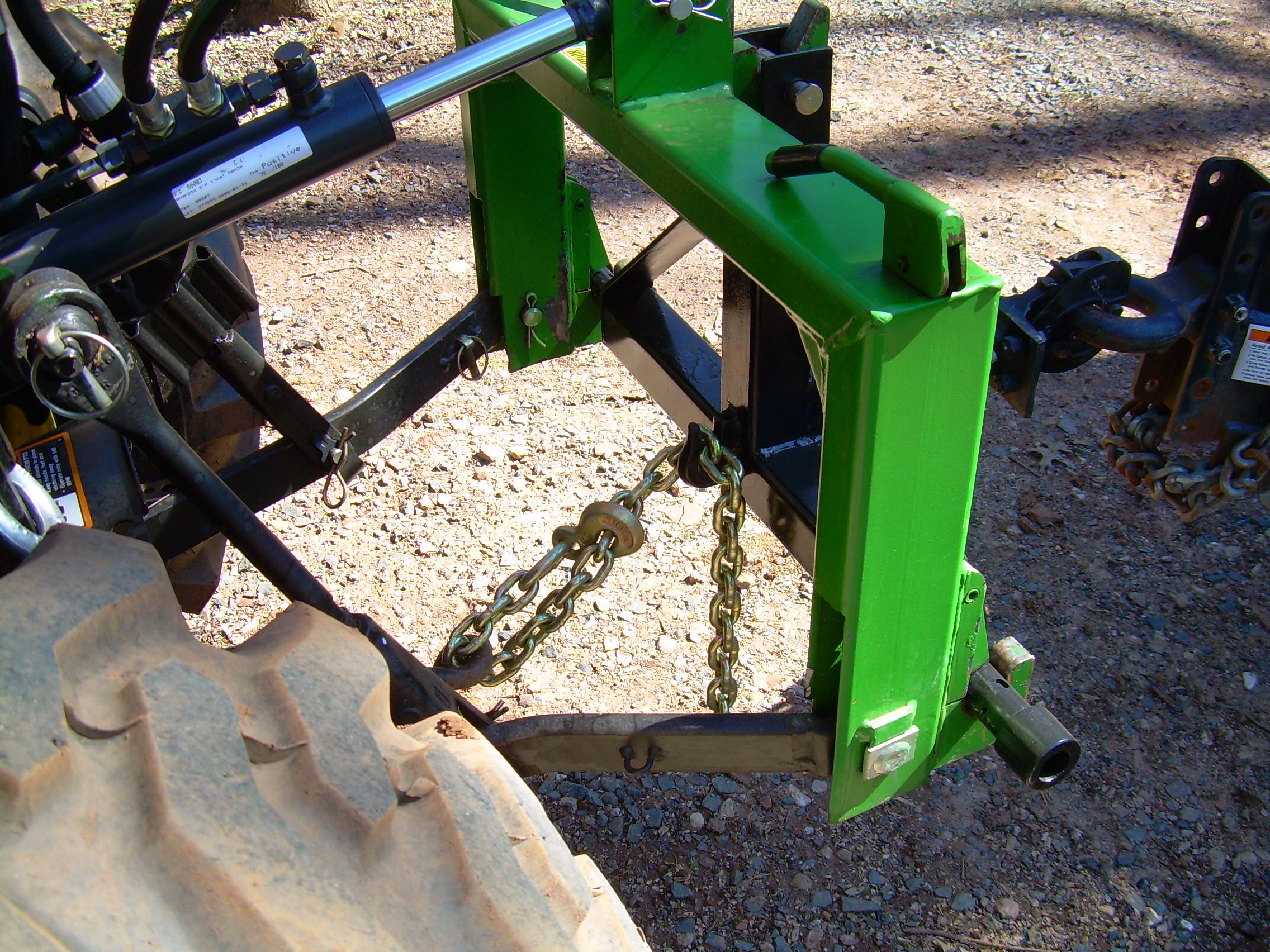

Finally finished up my 3 pt. receiver hitch. I have a gooseneck ball on top and have standard ball hitch and military pintle hitch that can be inserted in receiver. I think I may have over-built this a little (weighs approx. 175 lbs) but I guess a little over kill is ok. LOL. If I built another one, I would probably use 3/8 stuff instead of 1/2. Anyway, I will be using it on my large tractors (Cat II) I really think I nailed the dimensions because I can easily get under a gooseneck trailer that has been un-hooked from a truck and lift it higher than you would ever pull one. Also, in normal running height, my receiver hitch is just above the draw bar. Im planning on painting it a little later. Also gonna go over all the sharp corners and edges with a grinder. Vertical height between pins for arms and pin for top link is 15" (much lower than I initially imagined it would be) Horizontal distance between clevis' for arms is 32". Space between ears for both eyeballs and for top link is 2-1/2".

Looks good, but as I mentioned in your other thread you need a way to secure a chain from the draw bar to somewhere on your new hitch to limit the free, uncontrollable upward travel.
Not just my opinion, but a known issue.
Unless your larger than CUT tractor has 3pt down pressure, check valve etc ???
JB.

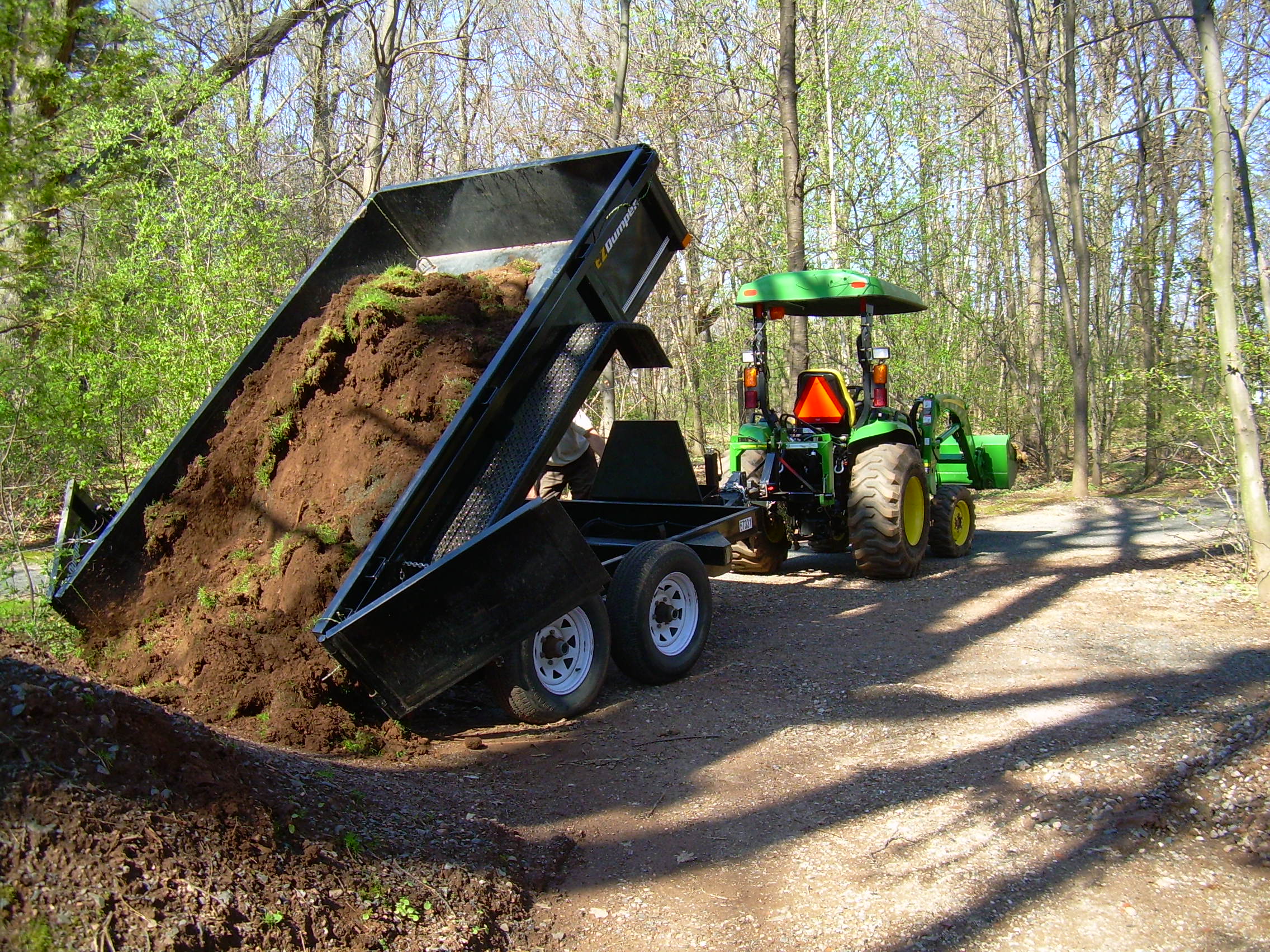

Yes it's attached to the draw-bar, you do have to be aware not to over lift so you don't bend your bar when you lift the 3 pt.
Never thought of the trailer coming off the ball, but I guess that could happen too, You definitely don't want that thing free traveling upwards especially with a heavy trailer coupled.
Braking down hill, backing up hill or dumping a heavy trailer like in my pic can cause a violent upwards force that can potentially cause damage, but certainly put you in a less than "in control" position.

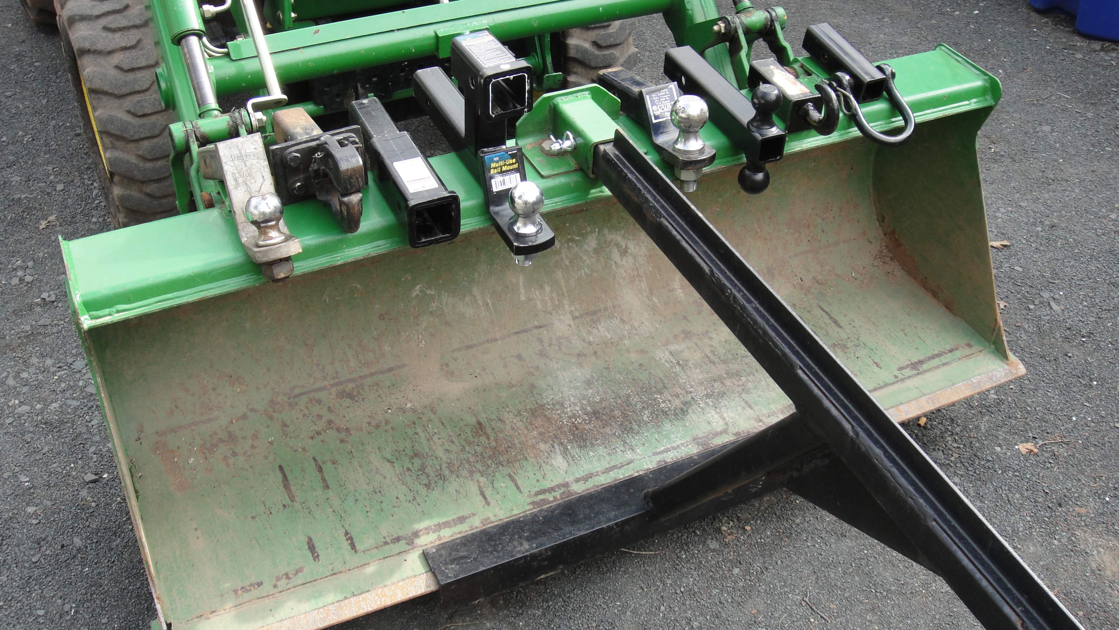

Don't know if the pintle is any more secure or not, in that situation neither is designed for to much upwards force. Probably lean towards the pintle since it does have a solid latch, especially for the dump trailer scenario. Before the load slides out there is tremendous upward force on the tongue.
As far as the bucket receiver goes, I think I'm one of the first to mount one in that position (bragging) now it is pretty common to see.
I had this one made to my specs and installed it myself. You can get the perfect match at Harbor freight for like $20.00 now.
5000 Lb. Capacity Step Bumper Receiver
