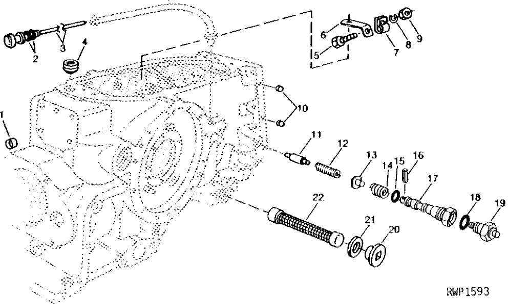

If 3 pt control lever stays at the bottom of the quadrant but 3 pt raises up then either the control valves are leaking/out of adjustment or the load & depth control mechanism needs adjusted according to a JD service manual. Where is the L/D lever under the seat set at L or LD or D? On 3 pt trembling: how long since hyd filter was changed and sump screen(parts key #22) cleaned????????

I just bout this tractor couple days ago and I'm not sure of the last time the hydro filter and screens been changed I guess I should start there first. This is my first Deere so now I'm trying to find where everything's at in the tractor filters and screens. If u don't mind where can I find the filter and screen. Thanks
   / 3 point problems #6
Good luck on the 2840. Their hyd system isn't one of JD's better ideas. The screen location is shown in the parts schematic I posted and the hyd filter is on RH side of trans close to plug that holds screen in.
Caution: you'll need to drain trans to check screen. It holds about 10 gallons.
