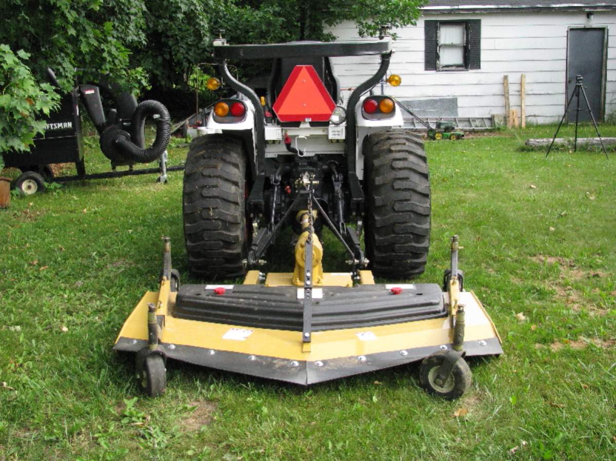

I agree w. the 3pt. as well. I have a 72" landpride, rear discharge and I really like it. Luckily, I don't have a lot to mow around, but I can mow about 4 acres in an hour and a half with it.

I went with a 3 point also. I bought a 72'' king kutter rear discharge. Way easier to pull the blades off for a sharpening.

Do the tire tracks cause much crushing ofthe grass or do the mowers do a pretty good job of lifting the grass back up to be cut?

I run a First Choice 84" rear discharge 3 point mower ( same mower as the Kioti 3 point mowers) on my DK 35.
Nice mower, very nice cut.
It lifts the grass up very well before cutting so it does not leave uncut grass where the tires run.
When I mow very wet grass or mow in the rain the grass will be mashed down in the tire tracks where it doesn't cut well.
