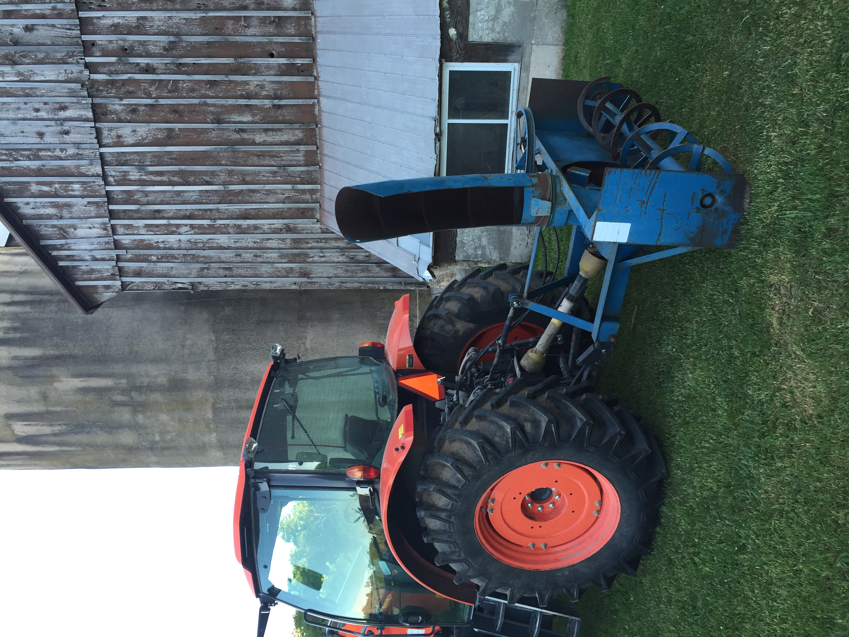

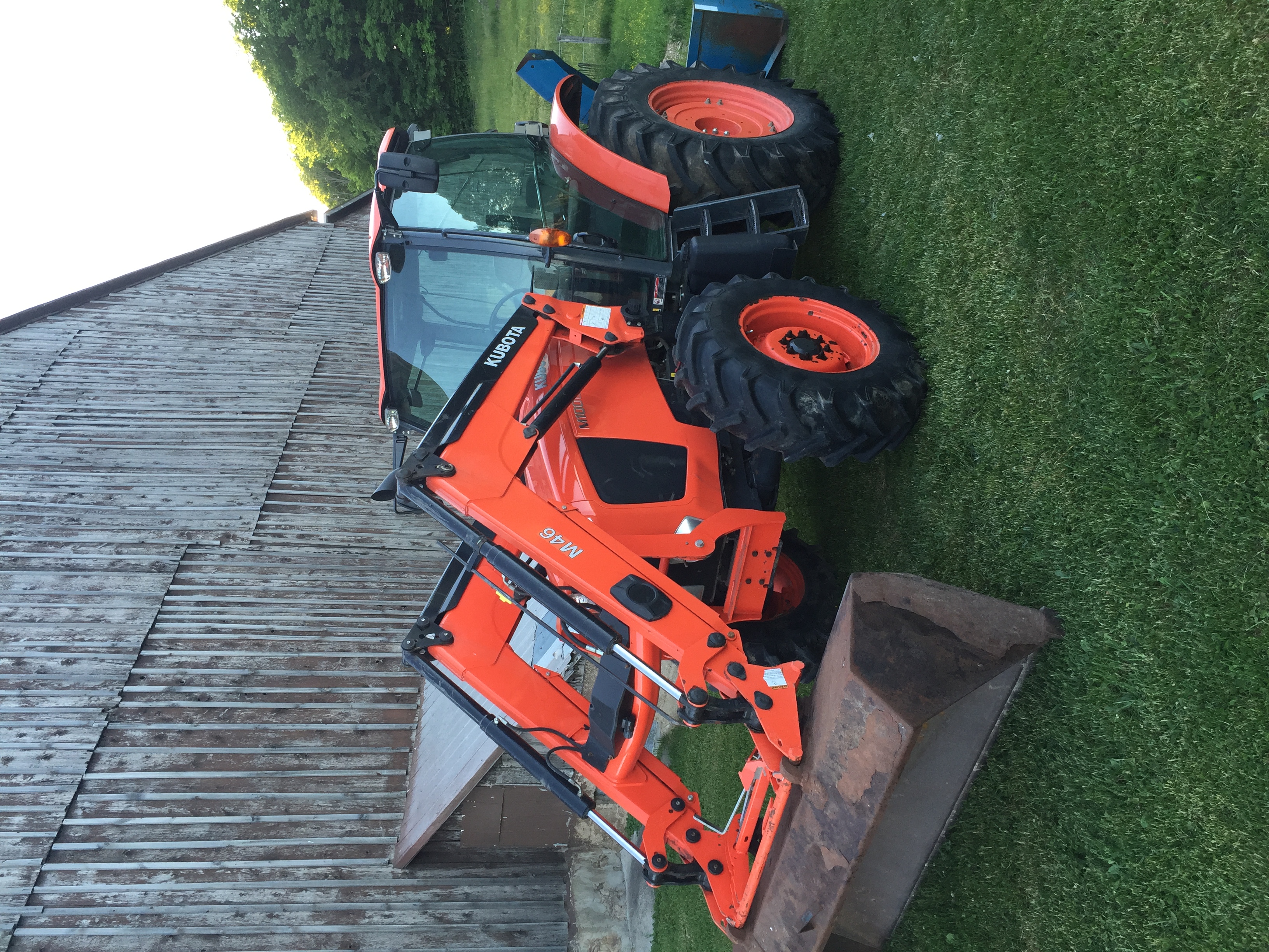

Hey all, new here and new at the whole tractor thing. Fast and steep learning curve in progress. Lucky I did not kill my self yet. LOL. So my question is, I am going to buy a brush cutter. Looking at a 7 foot wide 3 point Bush Hog and also a 6.6 foot wide WOODS D80 hitch type cutter. My property is some what hilly and some off camber. Sort of like rolling hill golf course. Will be making walking trails around the perimeter of my fields and towing through the woods to clear trails. Good amount of up and down action on hills. So which one is better, easier to use and some pros and cons of each. Both are used and around the same price. Thanx few picks of my rig.
7 ft lift type seems about right for conditions you describe and maybe 10 ft pull type on the drawbar. The 3 point would more maneuverable in corners and backing under tree limbs and such. Ken Sweet
