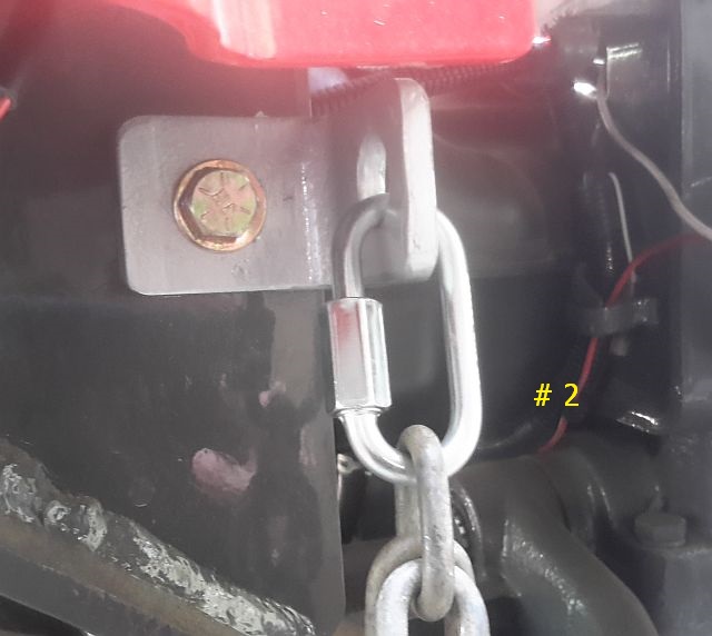

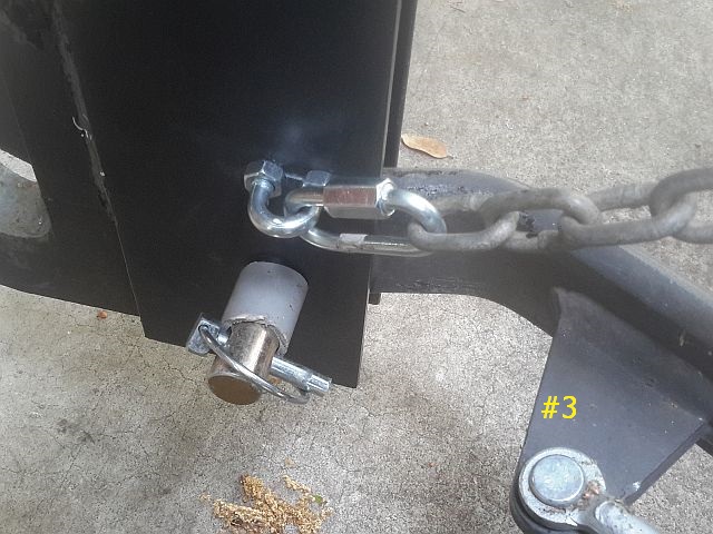

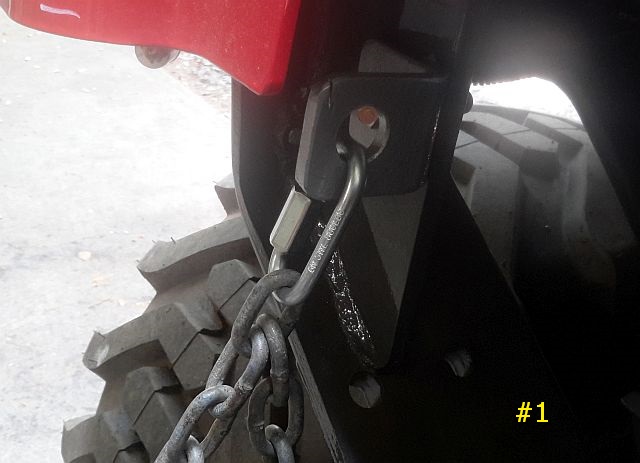

My solution was to add check/limit chained to control implement height...

Where do you pin your chain at? Top link on tractor to lower arms?
   / 3 Point operation on a new GC1705 #5
I drilled sub frame at top and used homemade tab with hole and custom set of chains and used as "threaded link" at top to adjust length and used "U" bolt at quick hitch end.... Not totally happy with way I did it.... I would just use "mower deck stabalizer kit" if I had to do it again...

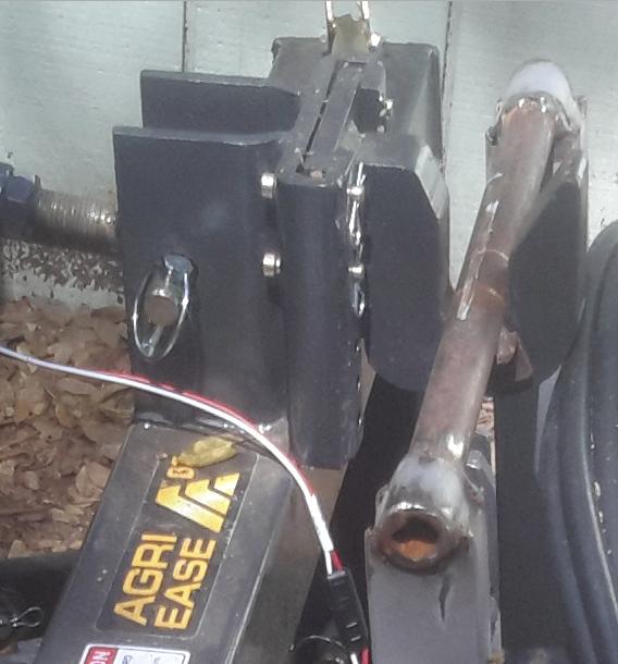

Your link is dead but I get the gist of it. Good, smart, practical thinking on your end. Which quick hitch brand did you buy? Those look like altered connection pins at the bottom?

Quick Hitch is Cat I by BE AG & Industrial (QH1G).. Went this way because of different securing of adjustable top hook.... All the "other" cheap Chinese QH seem to need different top hook or some sort of "fix" because bolts for top hook interfere with top link on attachments (read/research numerous articles on QH's)...

I read much of the same stuff and ended up getting the harbor freight QH using a 20% off coupon ($79.99 out the door) and then I bought a new top hook ($45.01 thank you amazon) that addressed the hangup issue. All told I dropped $125 for a perfectly functioning setup.
