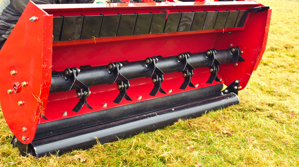

Flail mower

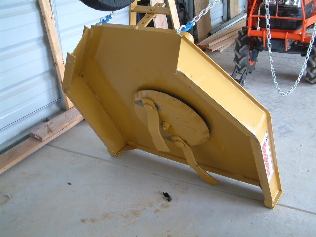

Going to be mowing pasture for hire....I'd get the rotary AKA bushhog.
They will do the job the quickest, and are the cheapest to own and operate. And can handle more abuse than a flail or finish mower.

If you remove your mmm, make sure you protect the transmission fan. I'd go with the bushhog style.

At 17.5 Hp you will be very limited in size. Also you 3 point is not that beefy either. You probably will not find much that you can run that is wider or faster than your belly mower. A brush hog could work, but they do leave clumps of grass around. There are some small flail mowers (read the flail mower thread entirely) that could work with the proper knives/hammers. Flail mowers mulch the grass. I am in the process of choosing one.

Probably go with a 4 foot rotary mower. It is the cheapest, most durable route. Should be able to find one for under $1000 new or half that used. I can't see the advantage of a flail mower for you since you have a mid mount finish mower already.
