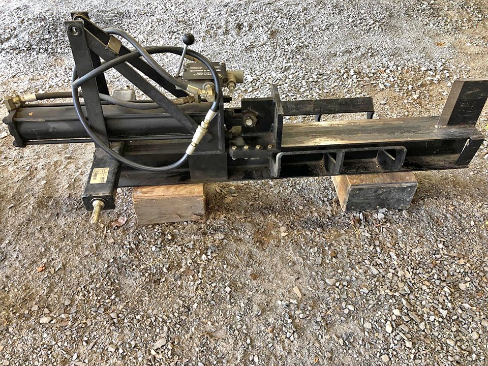

I am contemplating the purchase of a used 3 pt mount log splitter that would run off of the tractor's hydraulics. I have read that the flow rate per minute of the hydraulics is important. From the specs on my JD 2840 it states that the pump flow is 23 gpm. I am thinking this would be a good setup. Can anyone help me confirm that? The log splitter I am looking at right now (unless it sells) is a North Star (1102?) for $450.00.

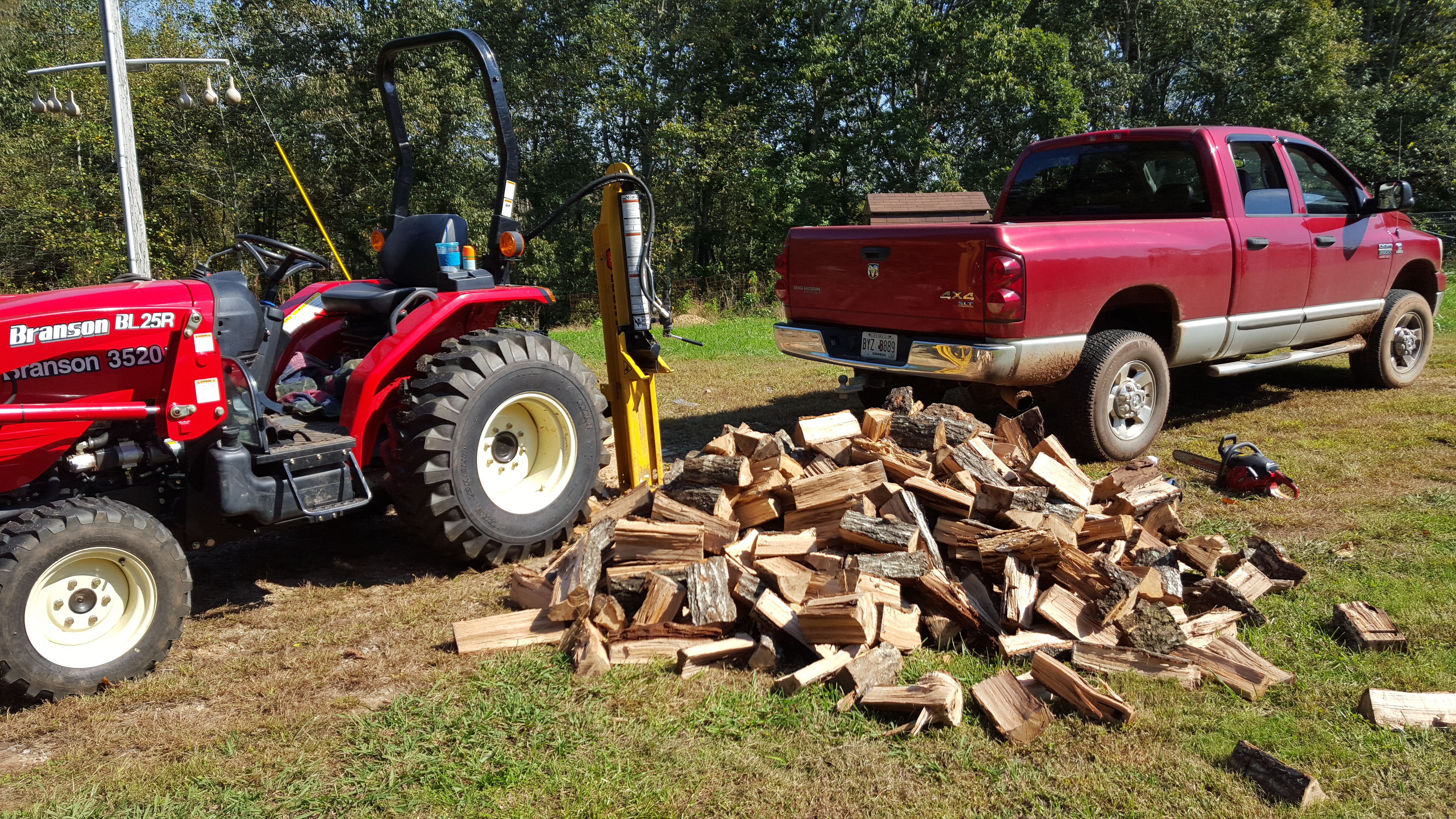

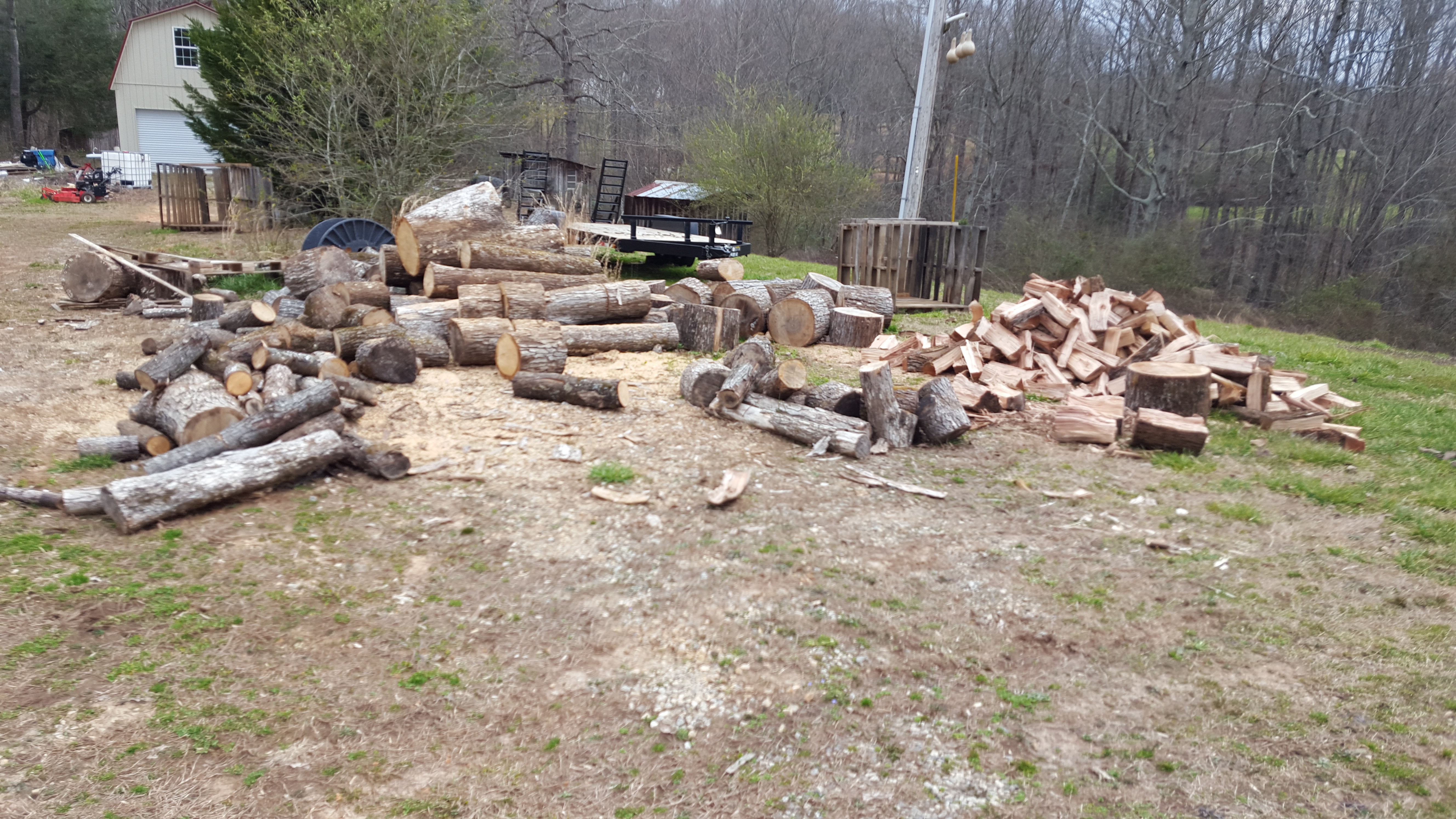

I use a 3 Point mounted log splitter from Tractor Supply. Used it on my little Kubota at first @ 6 GPM - it ran slowly - but had more than enough power for the knottly stuff. I upgraded to a 35HP tractor now the GPM is 11, and it simply runs faster - on both tractors NEVER had an issue busting any log. That 2 stage - not sure if it really matters much... I have not found anything20151016_131940.jpg20141231_130738.jpg20160301_151145.jpg I could not bust... 20151016_131940.jpg20141231_130738.jpg

Thank you Gafn! Thanks for sharing the pics too!

You may have to modify the splitter's valve to work with closed center. Modern CUTS are open center so the valve will be set up for that. Many valves have a part that can be added or removed to switch between open and closed center. Some do not. If it was me I'd look up the valve and make sure it can be adapted.
23 gpm will be plenty. How large is the cylinder on the splitter? Cylinder size determines the amount of force (since pressure is in the same range on most systems).
