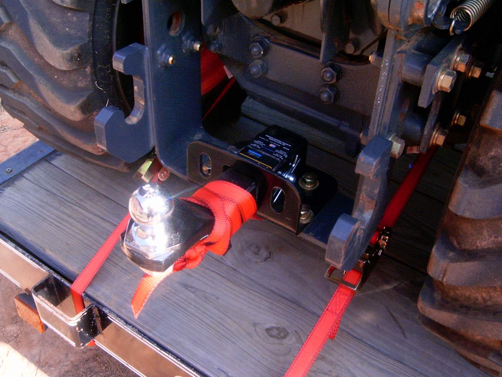

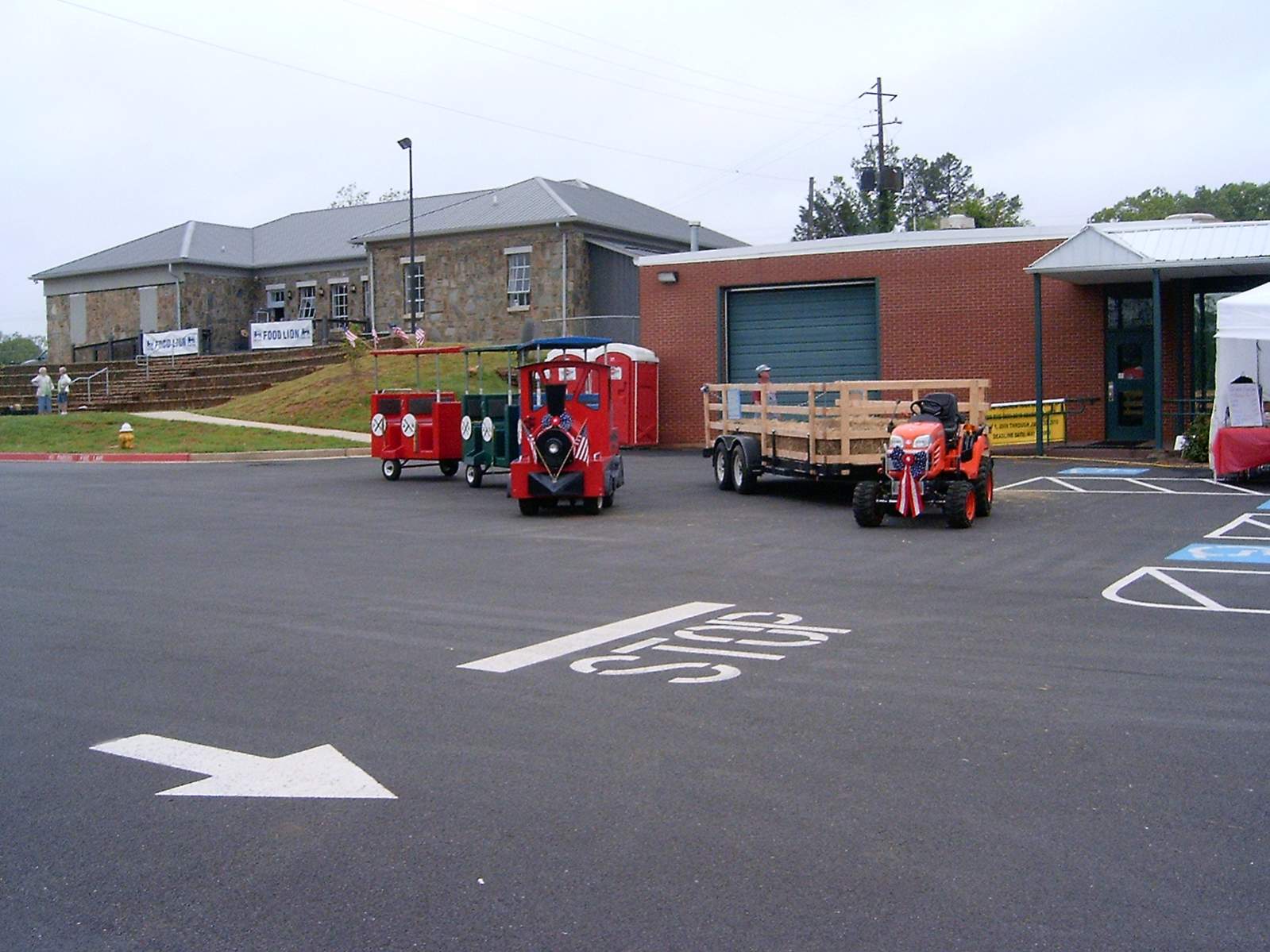

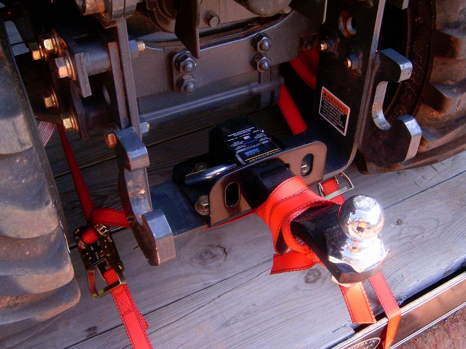

Hi Gruntdoc, to do some serious towing with your Bota, I'd suggest what I did with my BX24. Go to your local aftermarket auto parts place and buy a step bumper mount receiver hitch, Reeces makes one. Remove the rear center plate, don't remember if I used original or 1/2" longer bolts, and install the receiver. I had to elongate the two most rearward holes (in the receiver, not tractor) outbound with a dremel to make the bolts fit. With no ballmount it clears the backhoe no problem. Then you can pick the ballmount with the proper rise or fall for your trailer height. I use 2" for the train cars and 4" for my 18' car hauler. Here is some pics. The train is pulling about 3500 lbs of coaches and people. The hayride is over 4200 lbs. I've had it heavier on flat ground no problem, but it's at the max for paved hills. Oh, the little red engine is a Craftsman GT5000. Good for flat pavement only at these weights.
