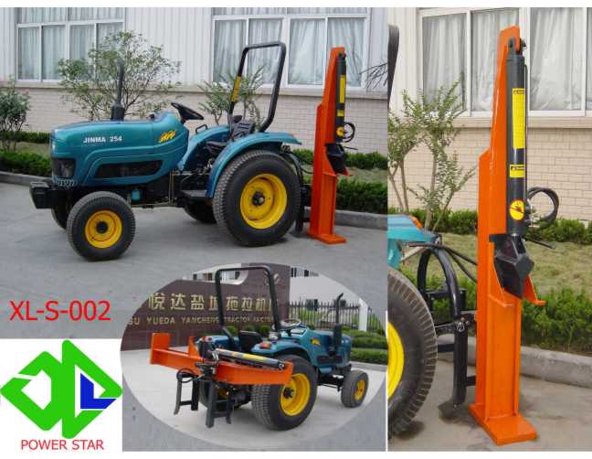

   / 3 point log splitter pictures #4
Picked up this web page somewhere recently.
Seems to be a nice idea for upright or horizontal working

   / 3 point log splitter pictures #5
Other than the leg shape and the color of the beam it looks just like the one I got from Tractor Supply Co yesterday.

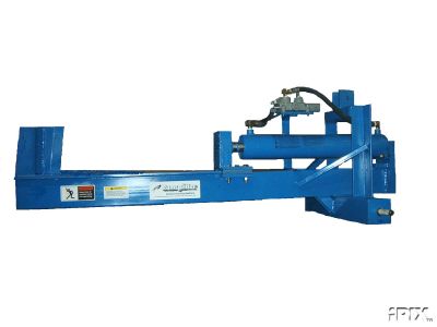

   / 3 point log splitter pictures #6
Check out this one i found the other day i'm building one similar to this as we speak will poast pictures when i'm done.

   / 3 point log splitter pictures #7
Another picture
