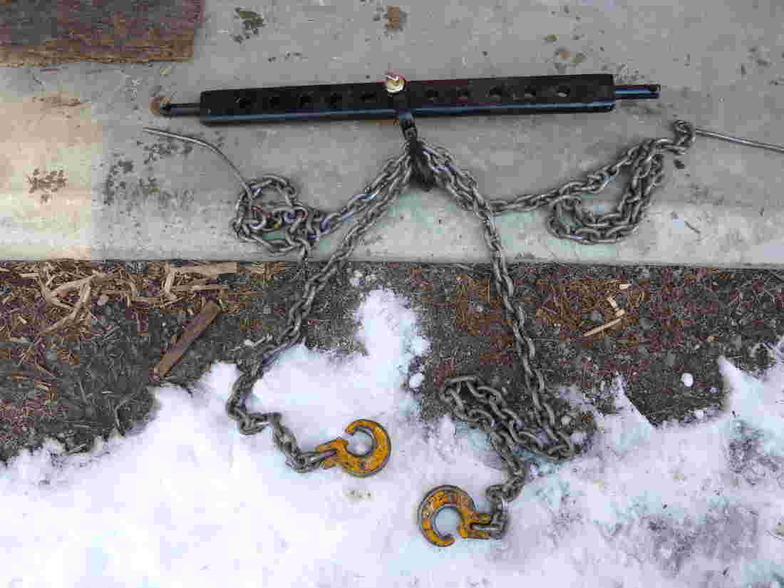

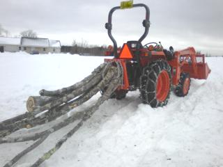

The simplest I know is a cross draw bar and one or more tractor hooks with a few chockers. All available from TSC if you have them up there. You can put two chockers in each tractor hook if you want. Pick the log(s) off the ground with your lift arms and go.

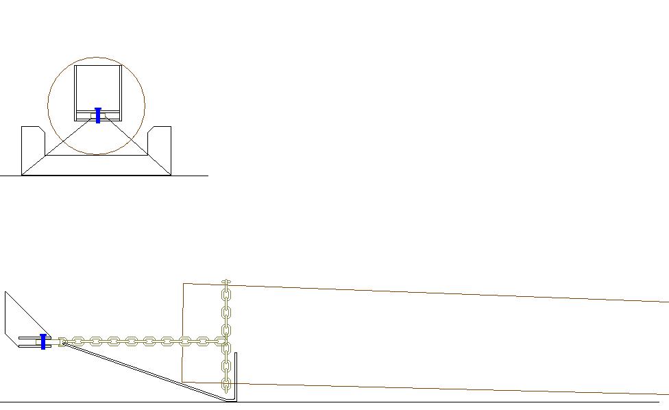

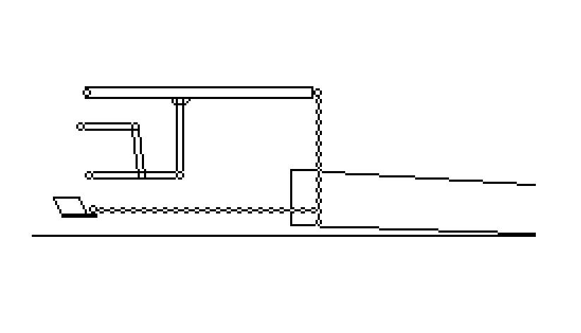

Well however you hook it up, don't forget to have the lowest attach point connected back to the drawbar. I have seen some pretty nice hydraulic log grapples on booms, and they are great for hooking onto and lifting the log. The problem lies in the geometry if the log should hang up while dragging. If it does, the pull force suddenly gets applied to the toplink attach point. That is a bad place to pull from, unless your intention IS to wheelie the tractor over backwards. Pulling should always be done from the lowest point possible, which is usually where the drawbar is located:)
If I were lifting the log with the 3PH in some fashion, I would incorporate a short tight chain back to the drawbar so the pulling force comes from there like in the first attached drawing.
Another option would be a purpose built log drag like in the second drawing. You kick this thing under the end of the log, like a hand truck, then fold the end of it down to lift the end of the log off the ground. The log gets chained to the drag, and the whole thing gets attached to the drawbar. This provides a smooth angled skid to pull the log along the ground. Same theory as a log arch, only simpler... You could also use a 3PH boom to lift the log and get the skid under the log. Whichever way, but the important point is that ALL the pulling force should come from the drawbar.
Good luck

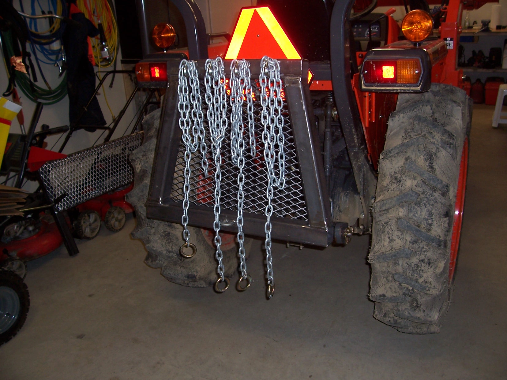

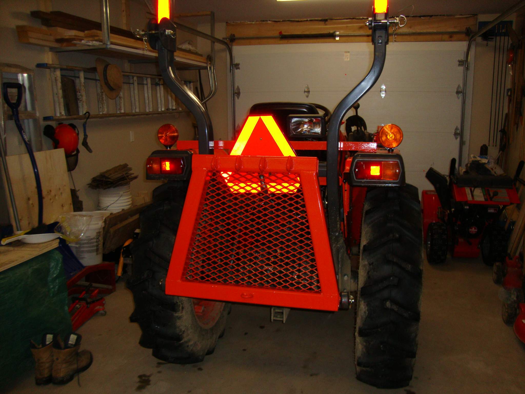

If the end of the log is hidden behind the "skidder" plate, it can't hook on anything. This is how they build skidding winches commercially. I built mine from 3" square tube and expanded metal. 4 hooks on the top to hook chokers into.
If I had to do it over again I'd build it a bit wider and higher, other than that it works fine. Allowing room for a hydraulic winch would have been a good idea too.
As with any equipment, you need to be careful using it, nothing is foolproof.
Sean
