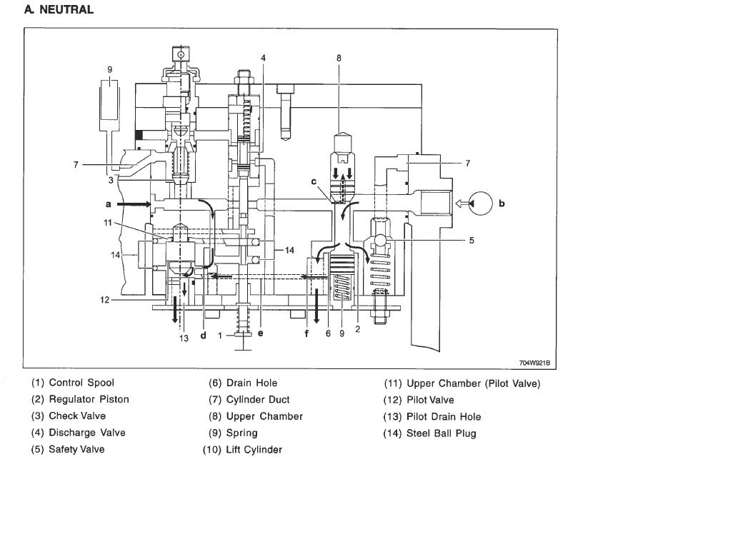

/ 3 point lift has 5 second delay #25
Does this help
#27
Here is what I found. I tore that MLS apart and had it so unbelievably clean so many times I could do it in my sleep. My dad (who used to be a mechanic), the local tractor mechanic, or myself couldn't find any problems. So after getting good and frustrated I starting driving it out of the shop with the snowblower dragging on the ground and the 3 point lever in the up position to put it away in the other shed the snowblower just went up and works perfectly. It appears as though after rebuilding this valve it takes awhile to prime that circuit with oil so that it will work again. The manual should note that someplace.
Thanks for the help and encouragement everybody.
(BTW, the day that tractor broke down the oil pump seal blew out of my camry, and I shifted my 4 wheeler with less than 300 miles on it into first gear and the shift arm inside the transmission broke...... all that within 36 hours :confused2:)
#31
Take the valve apart and slide the spool valve (the bigger spool valve) in the bore back and forth until you can just drop it in and it falls right to the bottom of the bore. Probably takes 5 minutes of rapid back and forth movement, then clean it really well and it should fall right in there.
