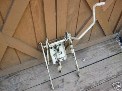

There was a couple of sears garden tractor ones on Ebay a while ago such as this one.
