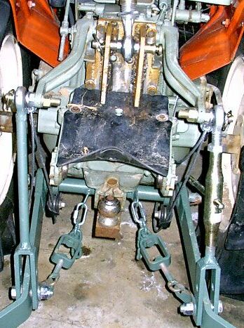

I built my own 3pt hitch for my YM1301D. It seems to work OK, but the only implement I've used is a potato plow. And even it just barely cleared the ground when lifted to the highest position. These are small tractors, and sometimes the normal cat 1 3pt implements don't work so well. I've attached a photo of my 3pt. You can see more on my web page.

   / 3 POINT HITCH #5
Built very similair 3 pt hitch for B6000. Also came with 2 point tiller from Japan. Lift height will always be limited. I built a single furrow plough, which in transport position is only 2" above ground.
The other problem with this configuration is the crank in the lower lift arms to suit the narrow width. It prevents any serious "pushing" in reverse. Push a blade rearwards for example, hit a stationery object and the arms bend sideways. Has happened me twice so far.
Afraid it is probably the case of accepting the limitations of the machinery geometry. All my equipment for B6000 had to be home made as only Cat 1 equipment was direct from Kubota dealer at inflated prices.
   / 3 POINT HITCH #6
The closer to the tractor that the uprights (solid and adjustable) connect will make the attachment lift higher.
