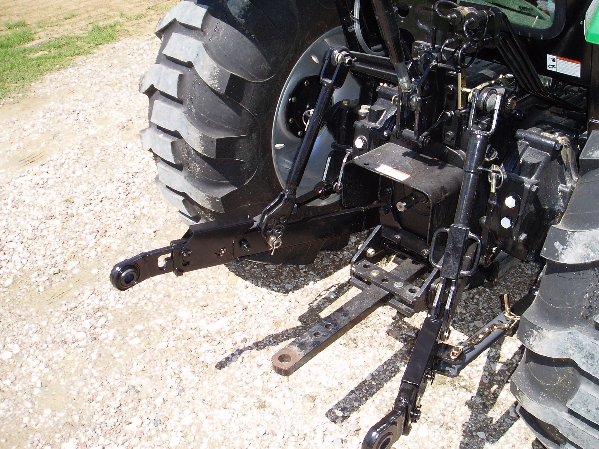

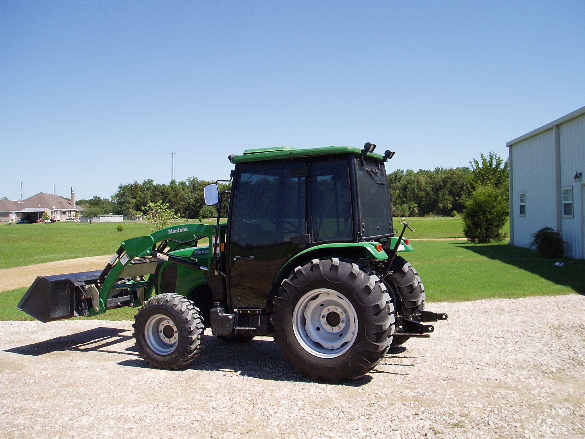

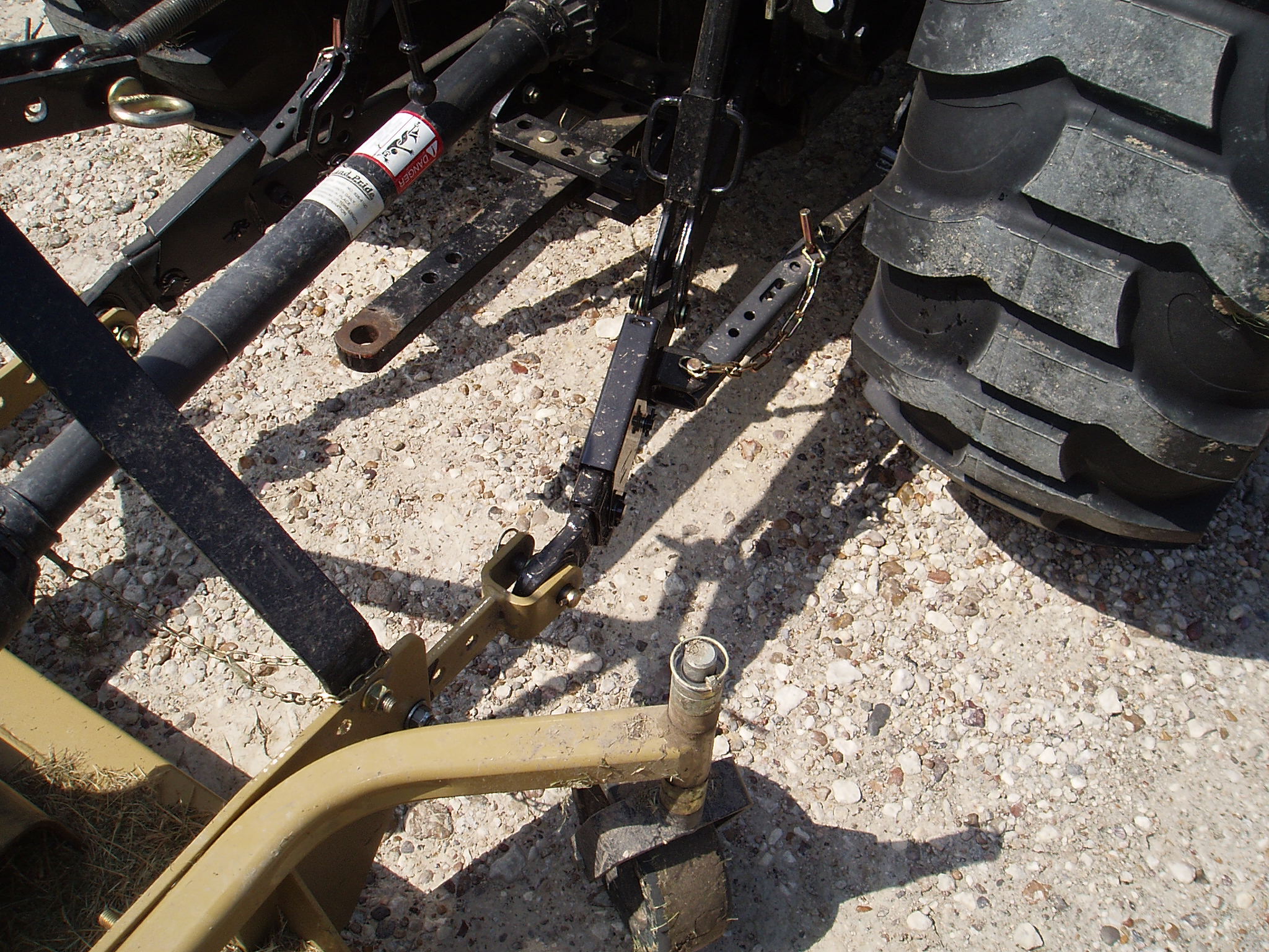

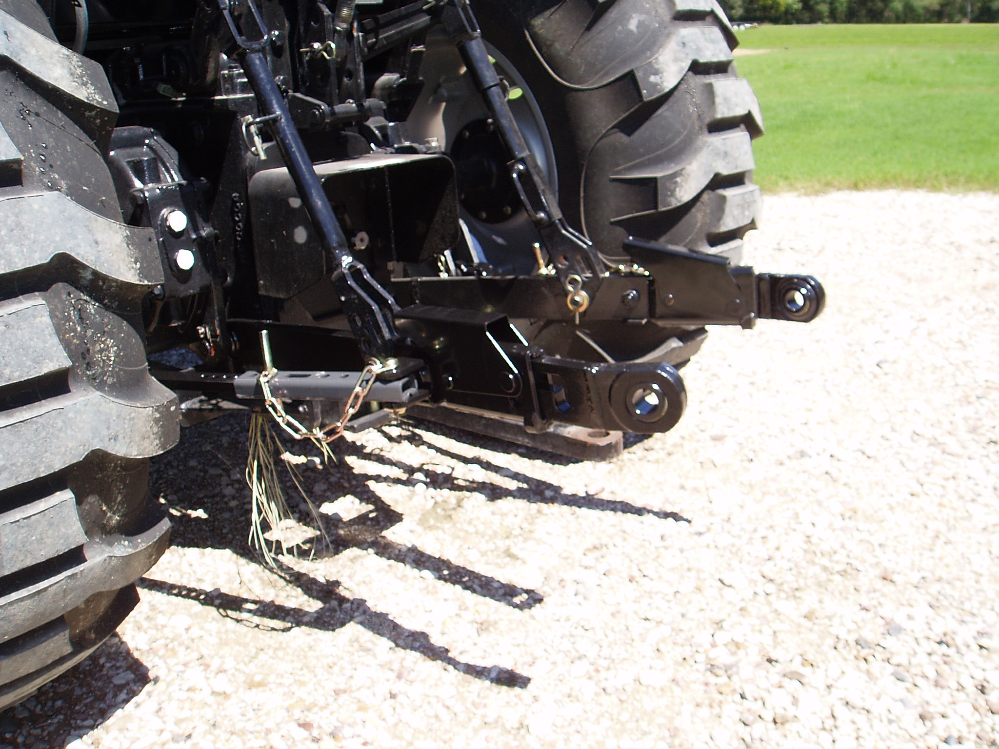

I changed out my side stabilizers bars and lifting arms on my 4940C with Kubota parts. The Kubota lifting arms and side stabilizer bars are the ones Kubota use on their M5000 series tractors. Your looking at $800 for all the parts needed to do the changeover. Im very happy with the changeover. I can hook up to implements in a flash now. Some cutting and welding was needed on the side bars, but for the most part it all fit very well and it works.
