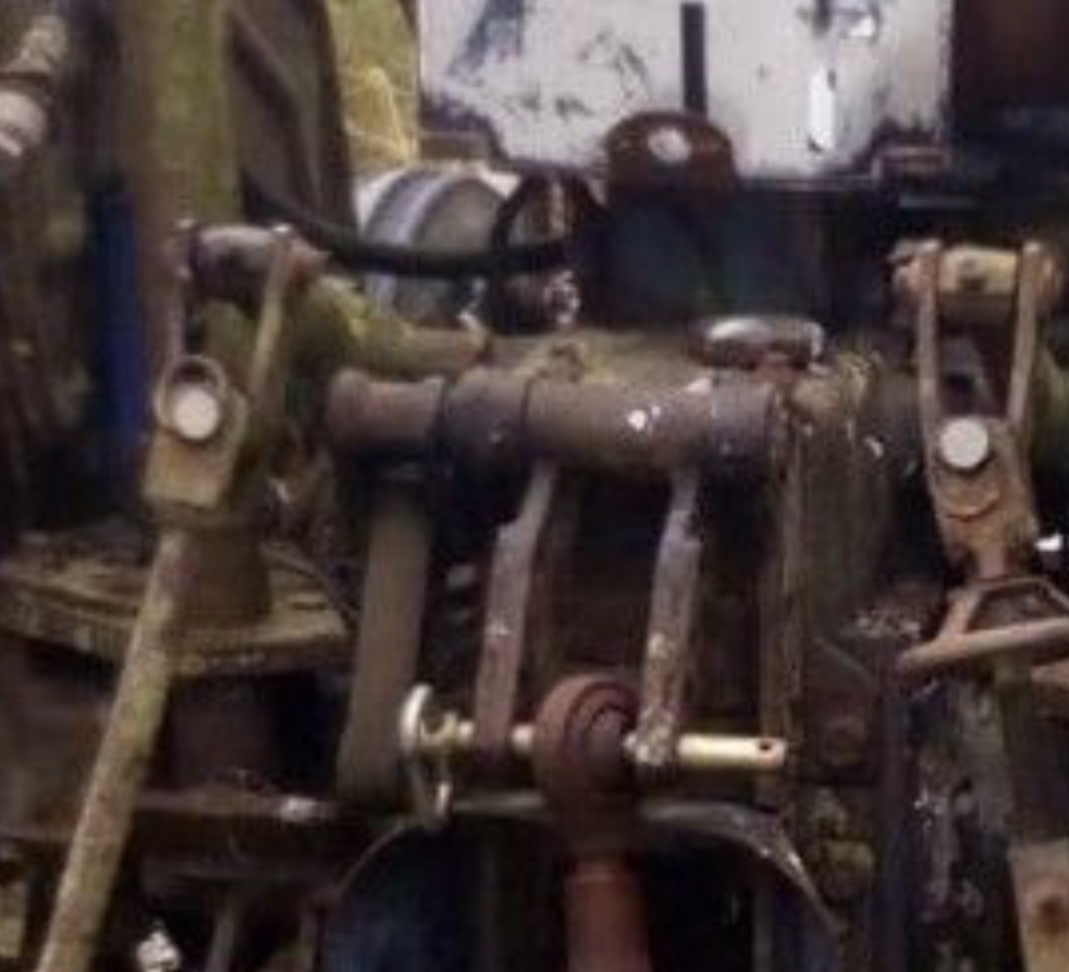

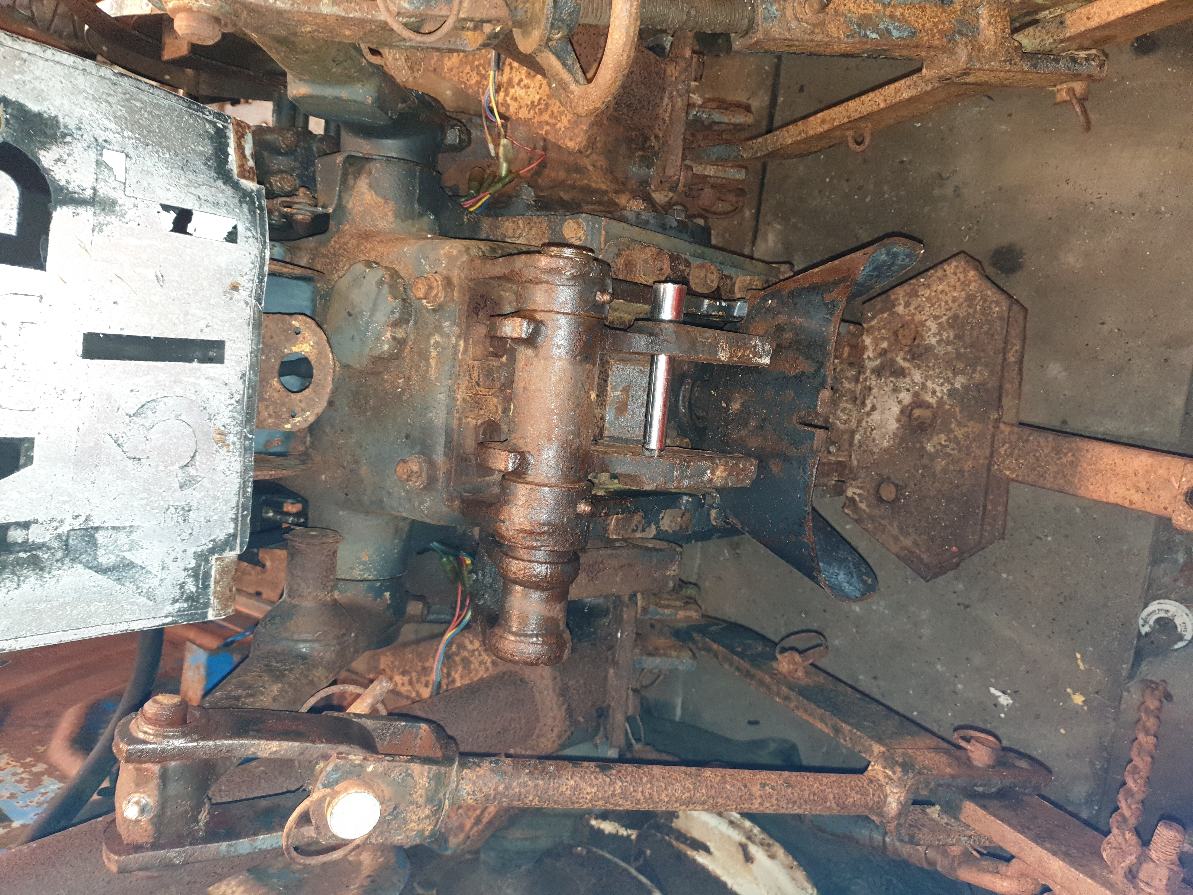

Hi Guys.
I have an Iseki TS3510 Tractor that i am curently restoring. The theree point hitch seems strange (well to me it dose). The top link is connected to the upper lift arms and it changes the length of the top link as the arms are moved up and down from what i can see. As the previous owner has disconnected it as he asaid he couldnt get his mower or tiller to sit right wit it connected. So im wondering is this a 3 point hitch for specialist applications or attachments. As to be honnest it the first one ive seen like thism As im thinking about removing it and fitting a standard top link bracket.
Kind Regards
Miky

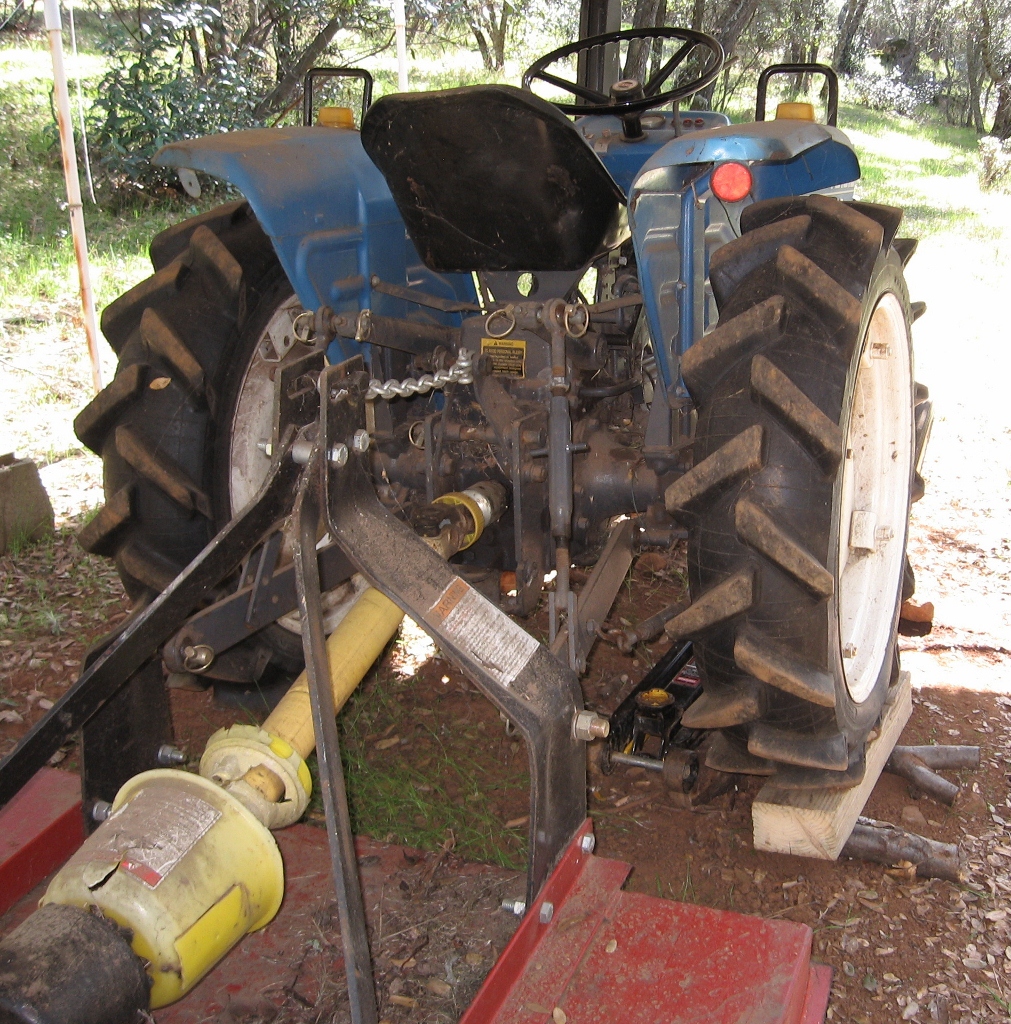

I think you're missing a part, the only picture of an Iseki TPH shows another bracket for the top link to hook to. Enlarge this picture and you can see the bracket above the point yours is attached.Iseki.jpg
After I looked at your picture again, I'm not sure.

That bracket in the picture you sent looks like one that can be fitted in place of the one I've got. As the one on mine when the arms are raised it pulls the top link it towards the tractor. And when it is lowered it pushed the top link away. It's like automatic top link tilt so when lowering it would lower the back off the attachment more then the front. An the opposite when raising
Regards
Miky
