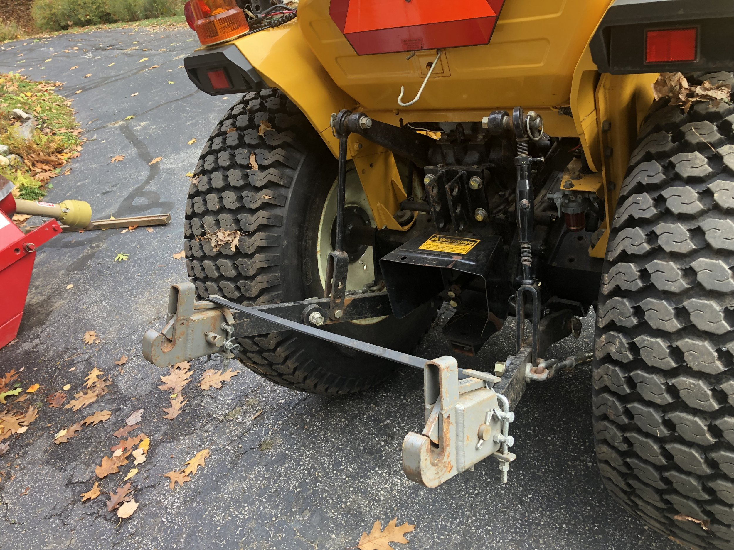

I have one of the older Cub Cadet 7234 models with just under 700 hours. It has the Mitsubishi 23 HP, 3 cylinder engine and drivetrain. I rarely use the 3 point hitch. When I went to put it away yesterday I realized the two upper arms of the 3 point hitch were only lowering part way and not going all the way down. There is no implement on the tractor I just had the arms raised because I was pulling a trailer around on th drawbar and the arms were in the way. I tried moving the control valve that adjusts the rate at which the arms move up or down but that didn't have any effect at getting the arms to lower all the way. The hydraulic fluid is full.

Thanks Duffer for the reply. Yes, I have the same knob, same location, called the “Hydraulic Flow Control Knob” on the Cub. I cycled that a few times twisting it fully open and fully closed and then tried raising and lowering the hitch but it didn’t help. The arms lower to about the parallel position to the ground and stop.

LD1, I stood on the lower arms but they stop at probably a foot or so from the floor/ground. I know at times you need an implement or some weight to help it move down but they have always dropped easily to within 4” or 5”.

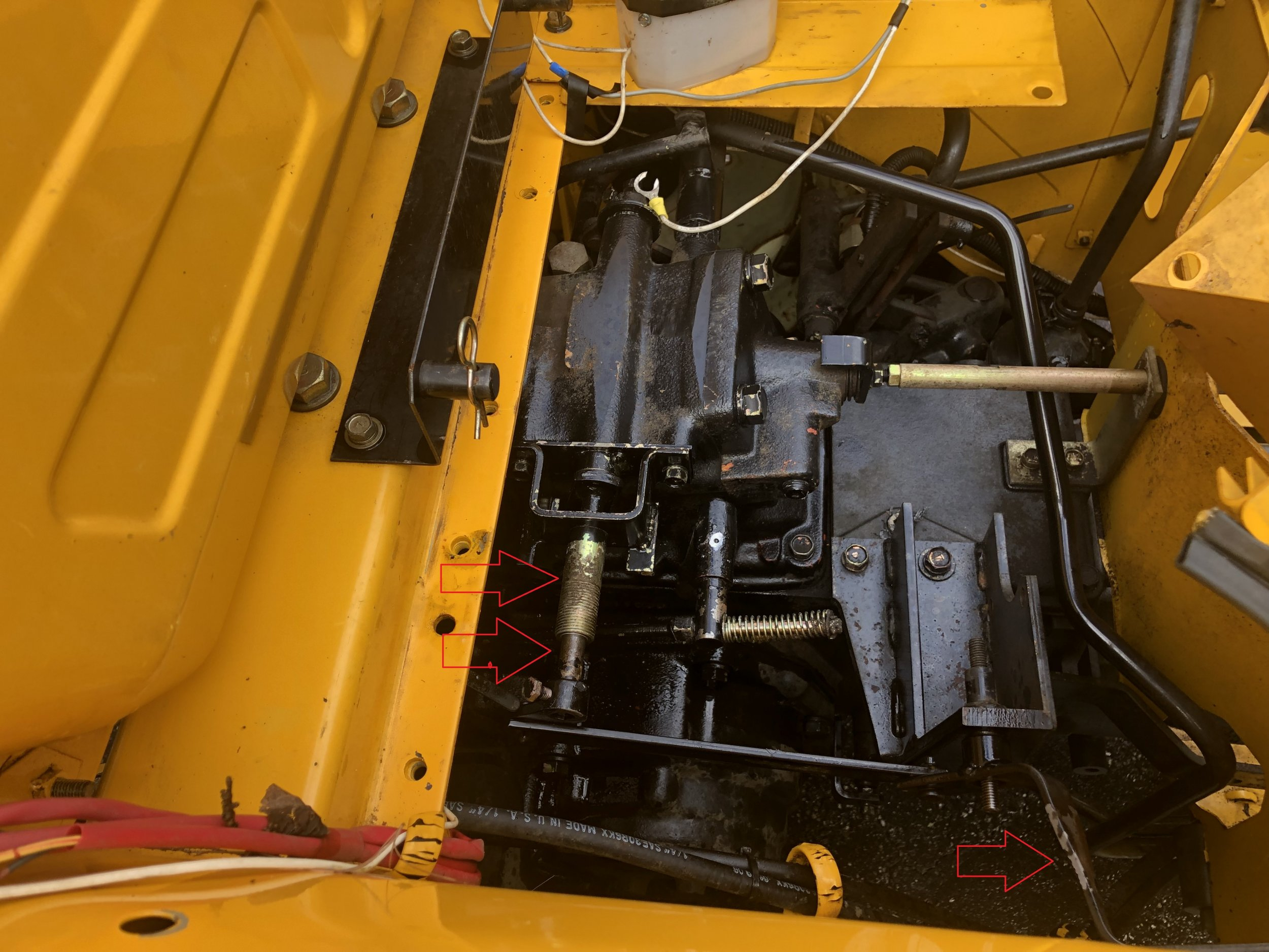

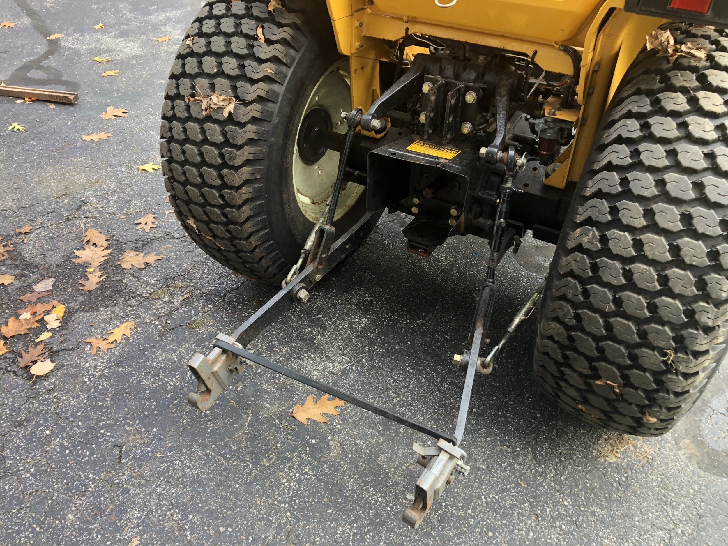

Well folks it’s fixed but I think it was a couple of factors causing it. I got to thinking that the lever that controlled the 3 Point Hitch had been somewhat hard to push and pull for awhile now. When I looked at the linkage for it the other night, I thought I probably should look to see if I needed to lube anything but to do that, I had to pull the seat and pan beneath it to get to the linkage. When I got everything removed it had a lot of dirt and grime with old oil and 25 years of dirt and dust. So I cleaned up all of that off with kerosene and Greased Lighting, washed it down with hot water and then blew it dry.
I oiled up all of the pivot points with WD40 and also re-bent the control lever that activates the hitch. Quite a while back I was picking up rocks or moving a tree and I had bent the lever. I couldn’t really get to part of the lever until I had the seat and sheet metal removed. The lever looked like the bend in it didn’t allow as a positive throw of the linkage as it should have. There is a couple red arrows in the last picture that shows kind of a bushing one of the rods pivots in in the center of the photo was tight and causing some tightness. The lower arrow shows a bend in the control lever. I also removed the lower stop for the control lever that gives me better movement.
So the hitch moves much better, drops as it should and the lever moving it is much looser now.
