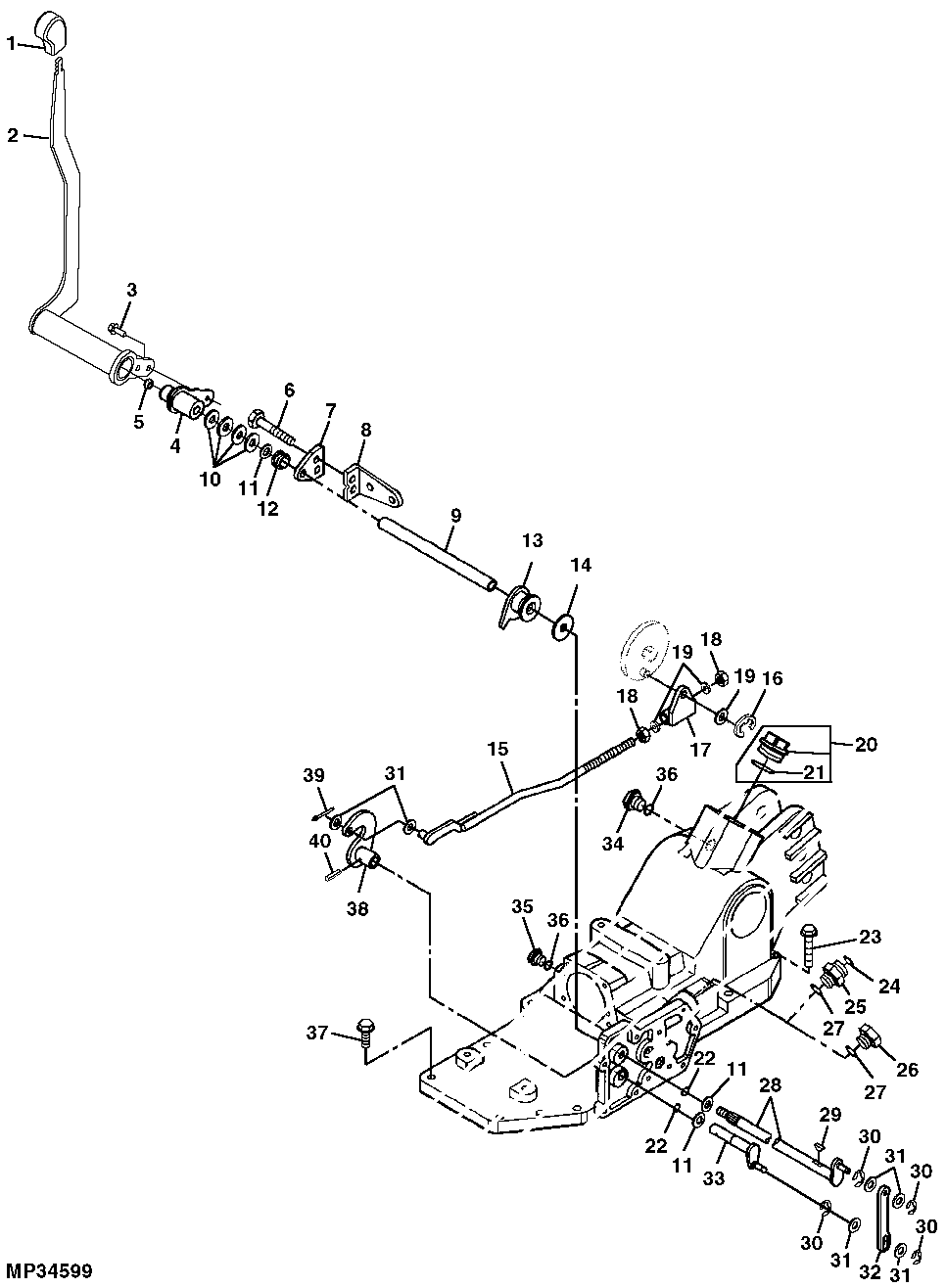

It's winter and I'm bored so I'm trying to think of questions to ask about tractors. Anyway I was out last night using the FEL on my 4310 to make a snow mountain for the kids to climb on and I had the rear blade on the 3PH. I wasn't using the blade and I noticed that it would occasionally drop down for no apparent reason. So I would pull up on the lever and get it back up off the ground and continue on.
Sooo I got to thinking that I really have no idea what makes the 3PH work and wondered if there was some sort of an adjustment on it. As it is now, and how it worked on my previous 850, if I pull the lever all the way up it goes into bypass (I think that's what it's called) and I can hear it hissing along with a loss of power. So I lower the lever just enough to stop the hiss and go on for a while until it drops down again.
It's really quite touchy too, which I was also wondering about. I can pull the lever up to the number 4 or so and the 3PH won't move, but I move it another hair and it raises up almost completely.
Anyway I was just wondering if that sounds about normal and also if there is an adjustment on it somewhere. I do know that the knob under the seat will keep it from bleeding down but I never seem to remember to use it.
Thanks
   / 3 point hitch: How to keep it raised? #2
The 3 pt control lever should have resistance to keep it where operator set it. Friction washer(parts key #14) and spring washers(parts key#10) perform this task on your 4310.
If you 850 went into relief when 3 pt was fully raised the linkage needed to be adjusted to eliminate this problem. Most tractors have a feedback rod that can be adjusted to eliminate going into relief at the top of lift

Is the "feedback rod" number 15 in that parts diagram? It looks like it should be fairly easy to adjust if it ever warms up around here.
I went out and played in the snow again today and it may be the lever slipping just a tad that is causing the 3PH to drop down. I adjusted the "stop" to set behind the lever so I could raise it up without it going into relief and I noticed that when the 3PH would drop it appeared that the lever was no longer touching the stop. It moved down maybe 1/4" so I bumped it back against it and it raised back up.
In case I'm wrong though, is there a picture of the seal that may be going bad?

Is the "feedback rod" number 15 in that parts diagram? It looks like it should be fairly easy to adjust if it ever warms up around here. Thanks
Yes feedback rod is parts key #15. If control lever is moving during operation then 3 pt hitch will also move.
