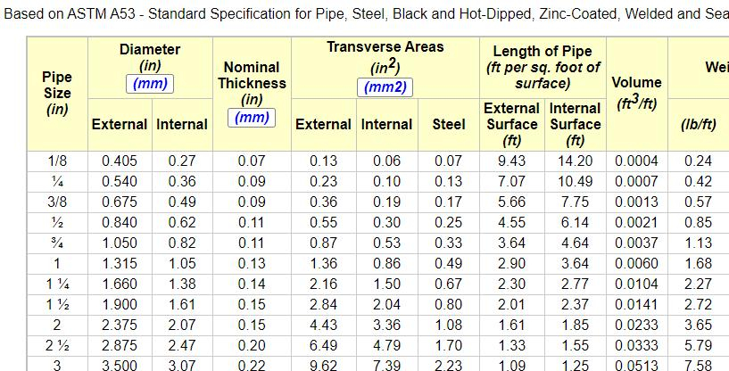

   / 3 point hitch bushing #6
3/4 inch water pipe?....
