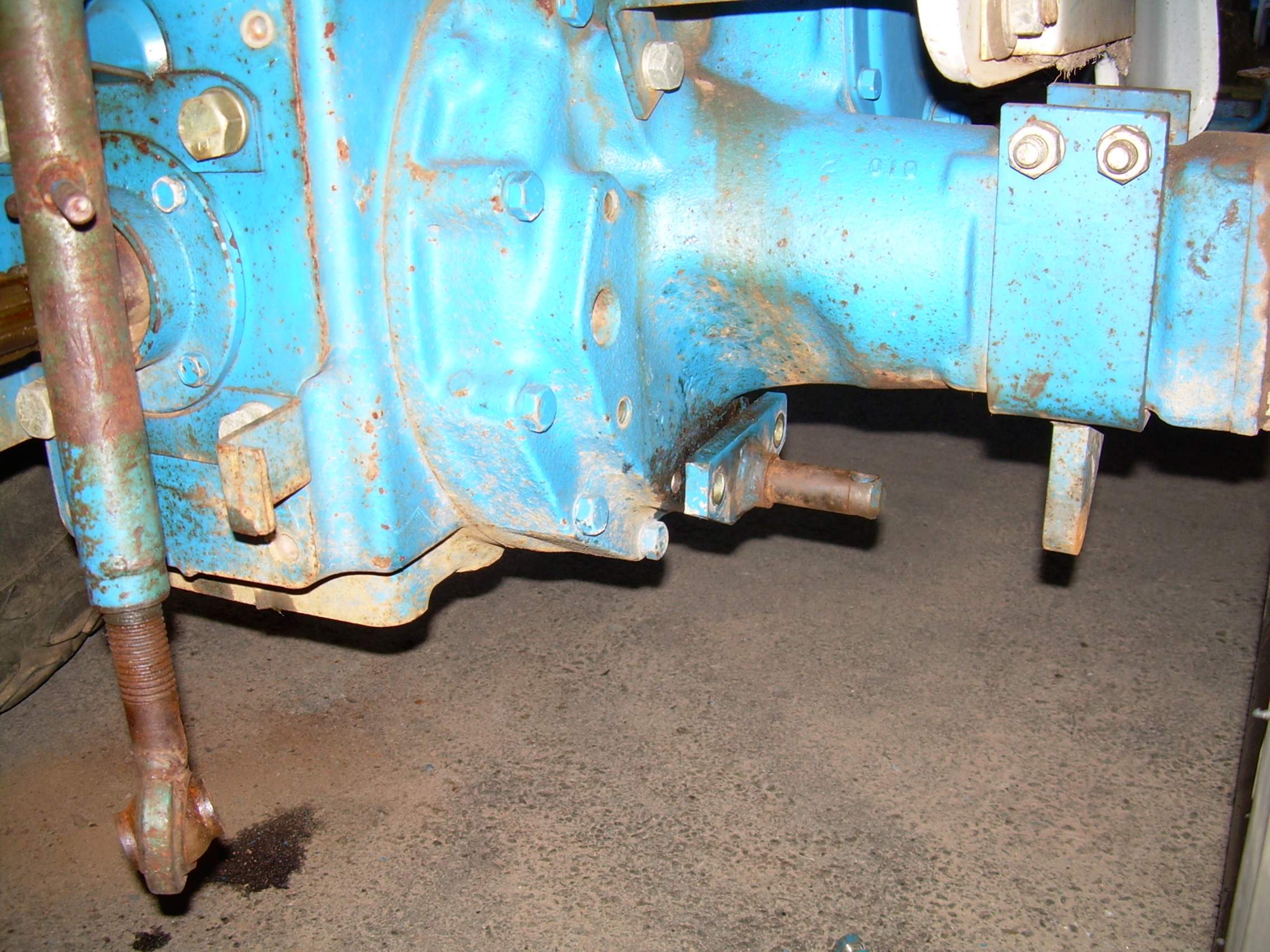

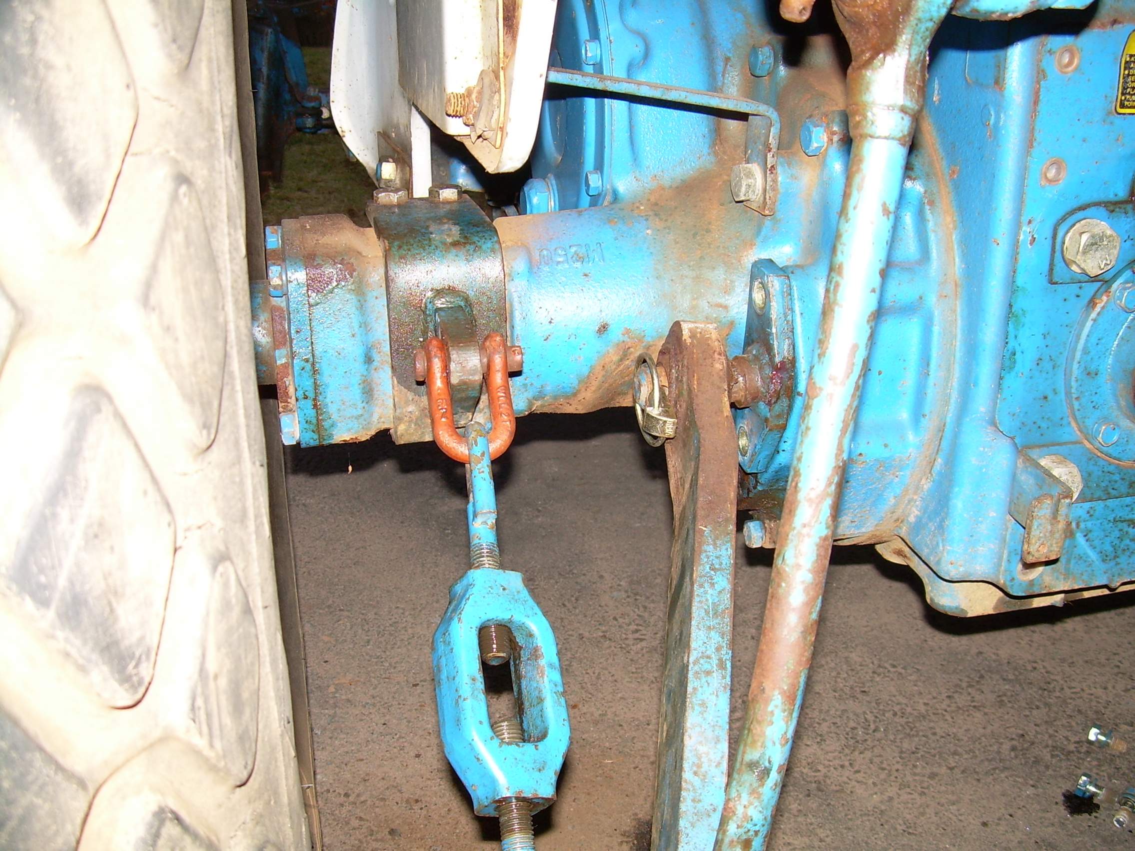

My Ford 1700 does the same thing, if I have it snug at the lower setting on the 3pt then it gets very tight when lifted, at some point there is the tightest point then loosens again, I've not broken anything yet, I have threaded rods and turnbuckles to adjust.
I just thought that's the way it is and there's nothing that could be done, but now I'm thinking that I might be able to move those brackets on the axles just a little to get the geometry just right.
I plow with mine in reverse sometimes and want it to be as tight as possible.

JB, Mine are on the bottom as in you second pic. Where are yours mounted. The ROPS goes into the holes in the housing you are using in the first pic.
Bill
   / 3-point hitch anti sway modification #5
No ROPS on this machine, I tried it in the upper position which extends the arms, you also have to rotate those brackets on the axles, I needed it like that to make a pto generator shaft compatible with this machine as well as another.
I've since gotten a QH so I reinstalled them on the bottom since the QH extends the connection length.
This thread got me thinking with a little tweaking to those axle brackets position, I may be able to get it snug through the whole travel path.
