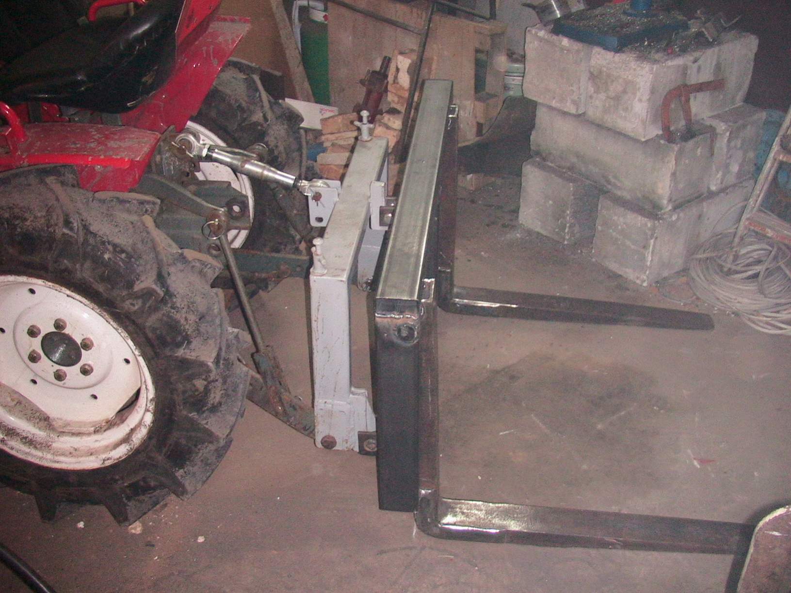

   / 3 point fork lift anybody build one? #5
I made mine using reinforced channel steel for the forks. i documented my process in a tread that you can find from my signature. i use it to move fire-wood, dog houses, and implements. It seems to work well.
Mike
   / 3 point fork lift anybody build one? #6
That helps and covers the forks on the 3 ph.
Similar to MJPetersen's, I adapted mine to be picked up by the iMatch quick hitch. It goes easily on the FEL or the 3 ph. The hydraulic top arm makes it perfect tool for whatever needs doing. Even will grub out boulders.

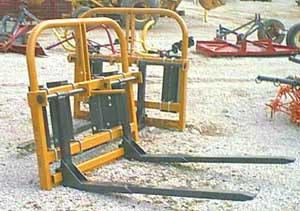

   / 3 point fork lift anybody build one? #7
I'd like to build a fork lift for my 3 point hitch. Anybody out there done this? Show me your pics please. :licking:
Here is a picture of a new one. Can be used on front loader or 3 point hitch. $595. Ken Sweet
