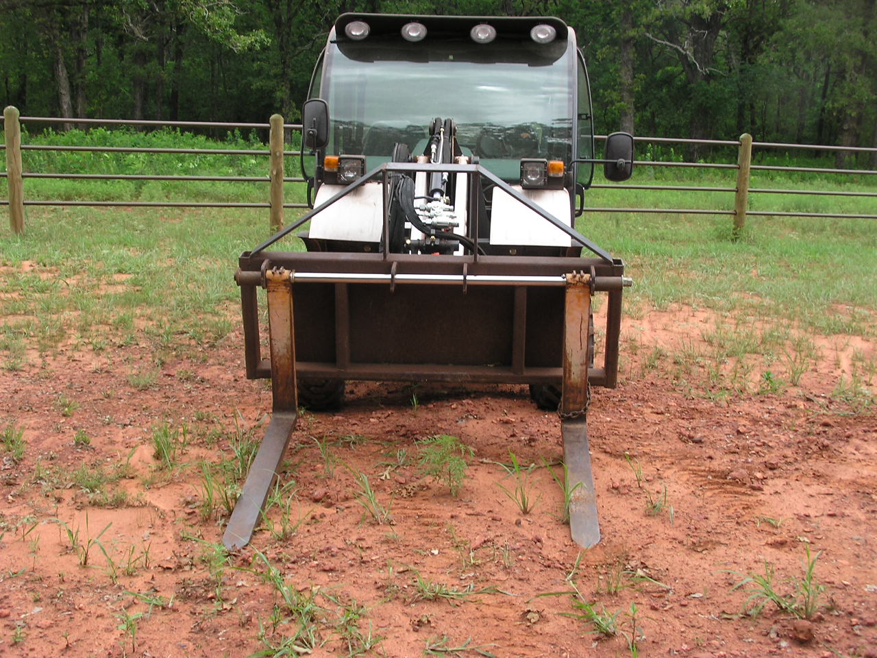

I wouldn't weld the 2" bar. I would leave it about 1" long on both ends and pin it in place. That way you could remove the forks, because it seems kind of a waste to use those forks on a 3 point.
   / 3 - Point Fork Attachment #3

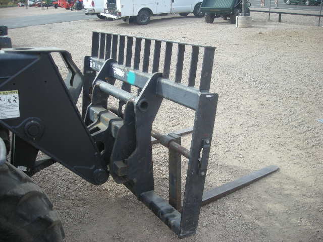

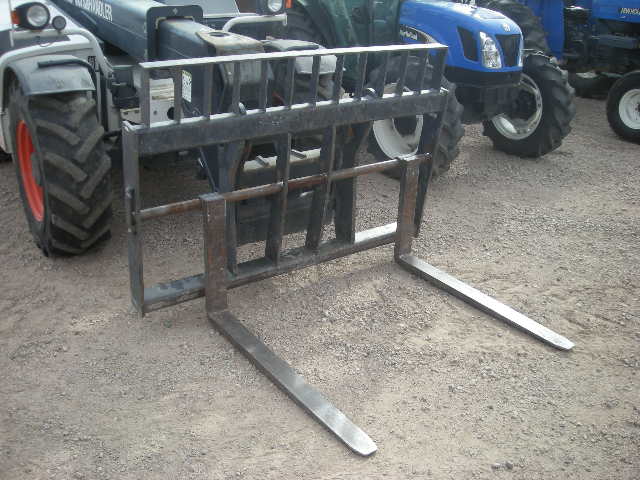

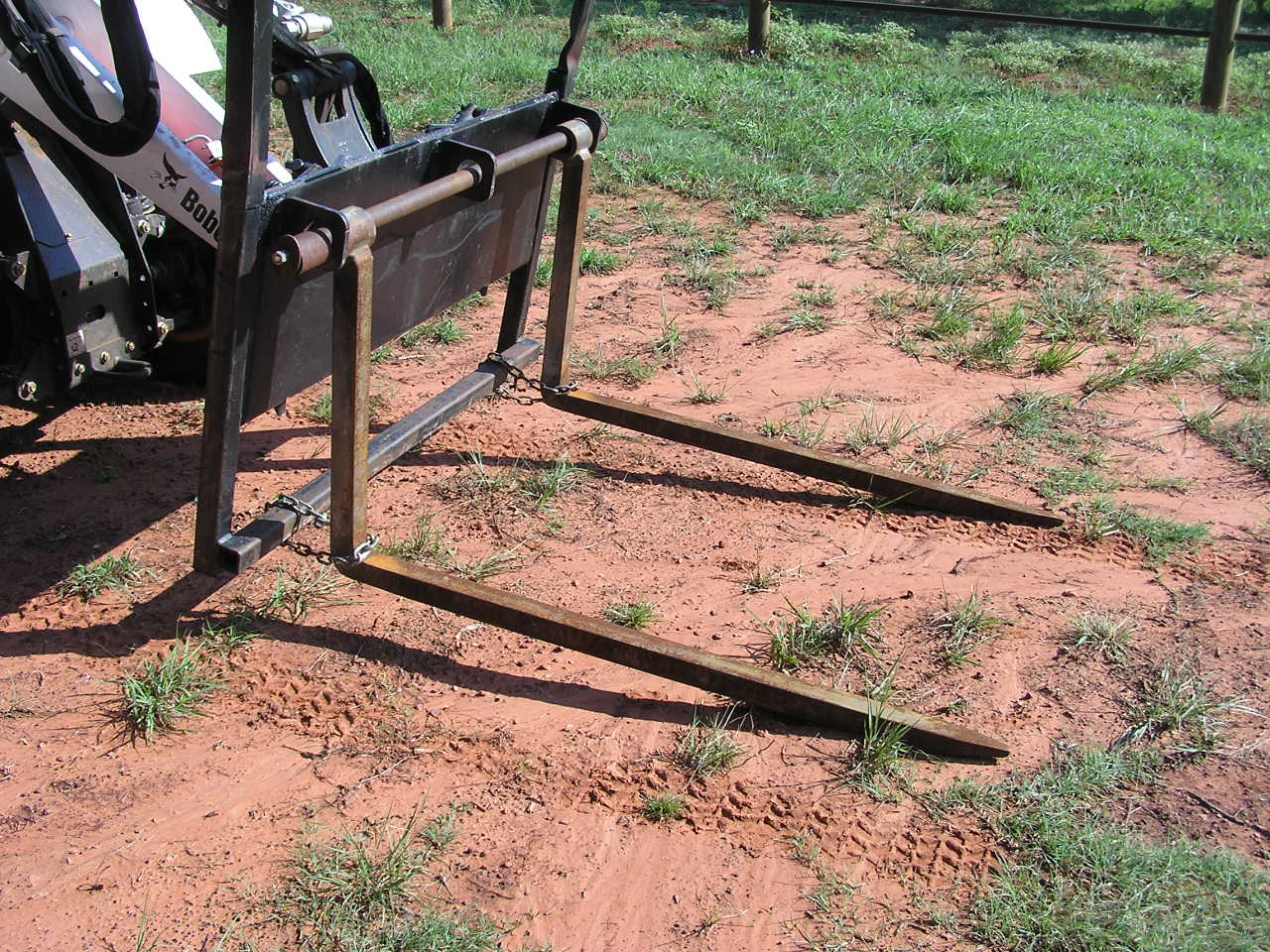

I agree, don't weld the bar. All that I have had were removable.
Not 3 point, but the frames might give you some ideas. If you want to get creative, make it fit both ends.
attachment.php
attachment.php
This is the first one that I had, note the bar is in a vertical slot. The forks will set flat if the pallet is not on the same angle as the machine. Unbolt the plate to remove the bar.

I think it's definitely strong enough, but since you asked, there is a good chance that the frame is too heavy for the assembly to stand upright when it's off the tractor. This will make storing and re-mounting it more difficult.
And since you are starting with a clean sheet of paper, take Xfaxman's suggestion on making it fit the loader too.

Thanks for the input folks. I will keep looking at the bar retention and size. And the owner already has a nice QA forks for the loader, so these will be just for the 3-point.
jmc, I was looking at the balance of the unit. I think it will be stored with the sprayer on it most of the time, but I was thinking about some sort of kick stand on the back of it to keep the unit upright when off the tractor.

Not sure I've ever regretted "overbuilding" something. Looks like a fine design there.:thumbsup:
As mentioned, make the 2" bar removable (replaceable) I've bent one before, and in a "slot" several 3 inches tall to allow for movement aligning up with your load on uneven ground. I would be suprised if it only get's used for that sprayer tank.
