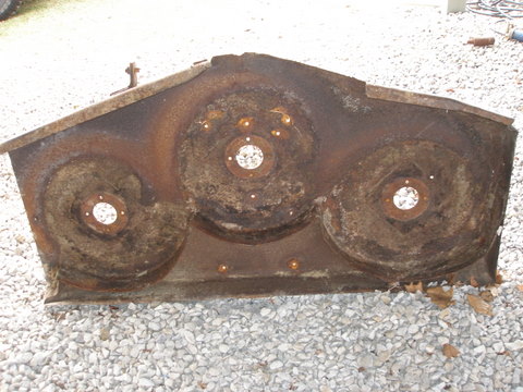

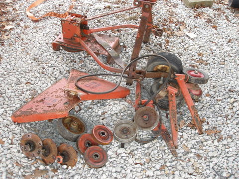

I've got pieces to a 5 ft. Befeco finish mower that's seen better days. The original deck is a side discharge. After reading some posts about side vs. rear discharge, I decided that the new deck will be a rear discharge, without baffles.
and so the project begins...

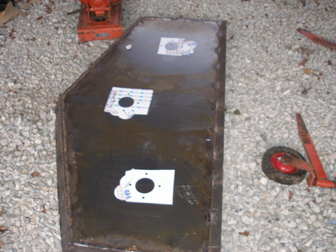

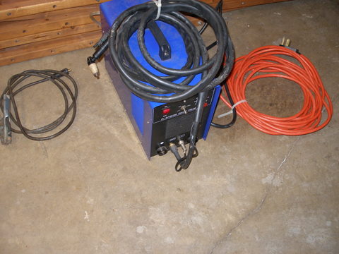

I started with a new piece of 1/8" x 4' x 8' steel. After taking some rough measurements, I cut out the new shell for the deck with my trusty "china made" 3 in one machine. I don't have the tools to bend the skirts, so I'll just weld them on and finish grind before paint.

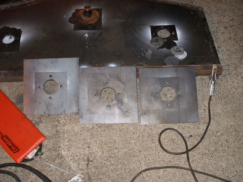

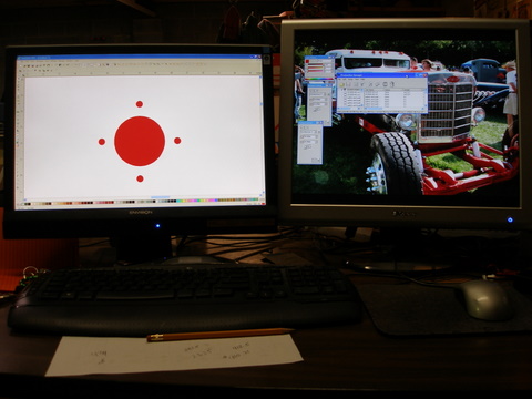

Next came the holes for the spindles. I drew them on the computer to scale and plotted them out onto vinyl as a template sticker. After applying the sticker to the metal, I painted over the template and cut out the holes. The three plates in the last picture are to beef up the spindle area.
more to come tomorrow...
