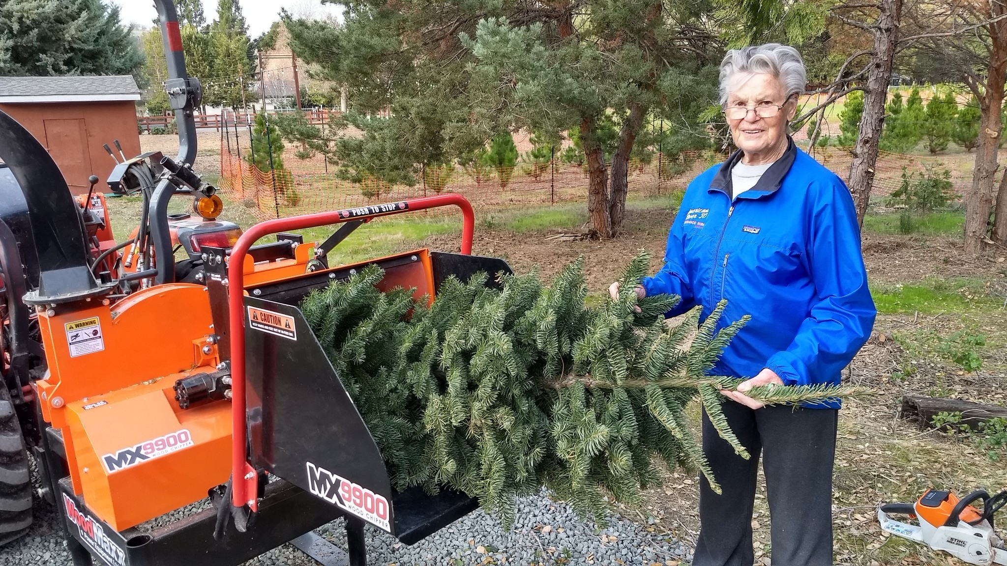

A lot of chipping might make these smaller units not the best choice.
I was set to buy a used Bandit 65 which is small commercial but could not get there fast enough with my $5500.
Mom chipping at the farm after Christmas behind the L3800
