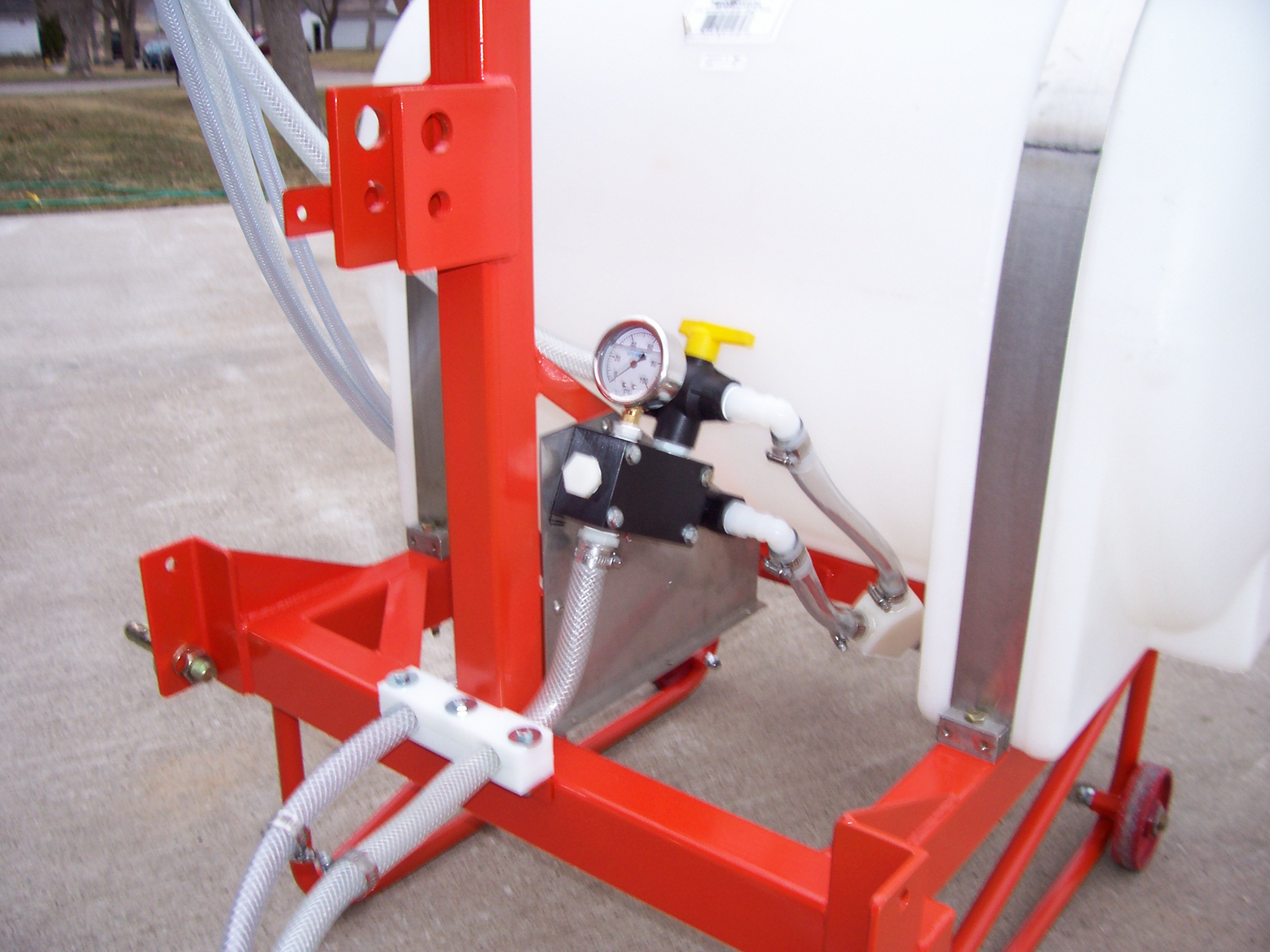

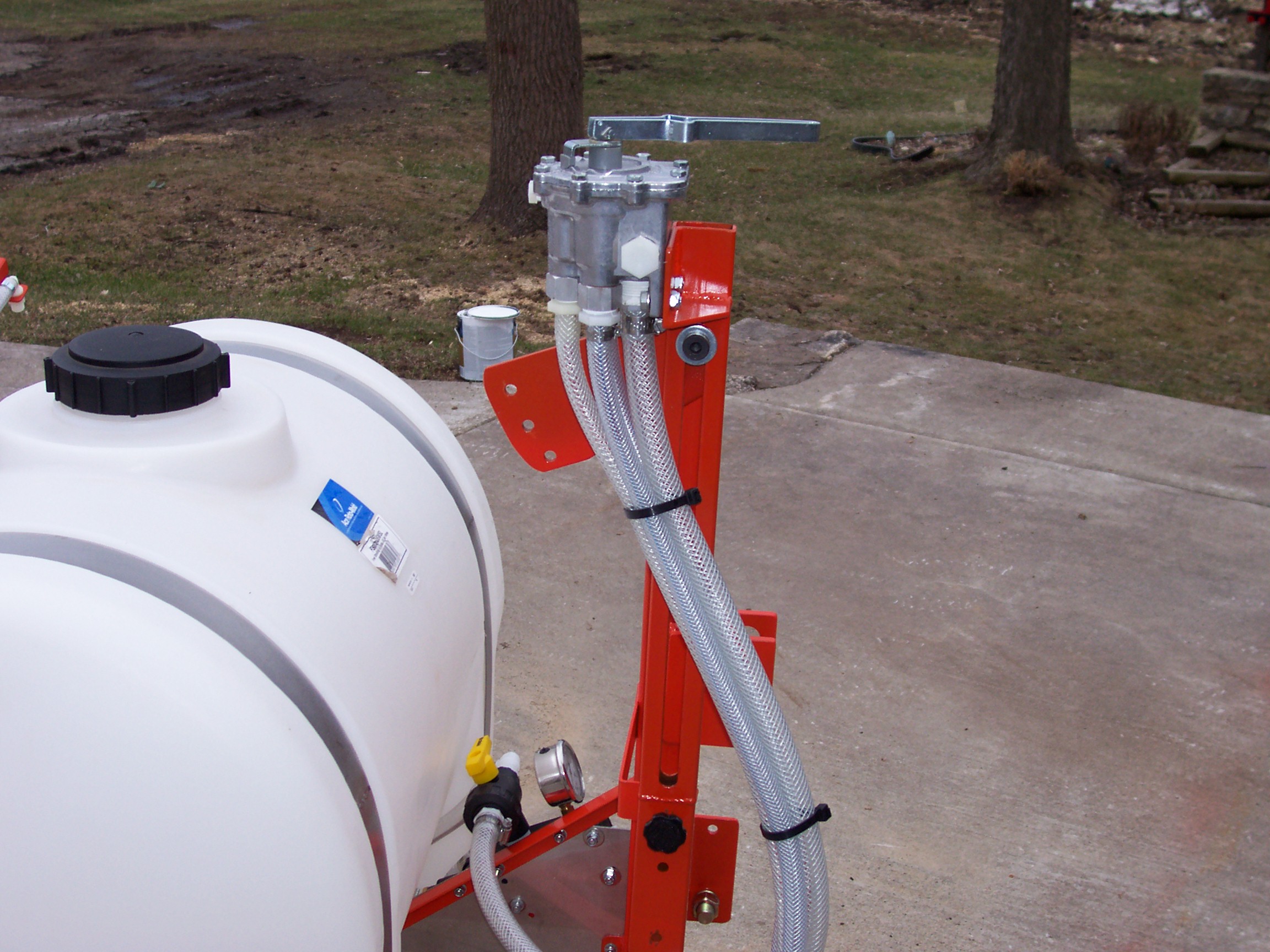

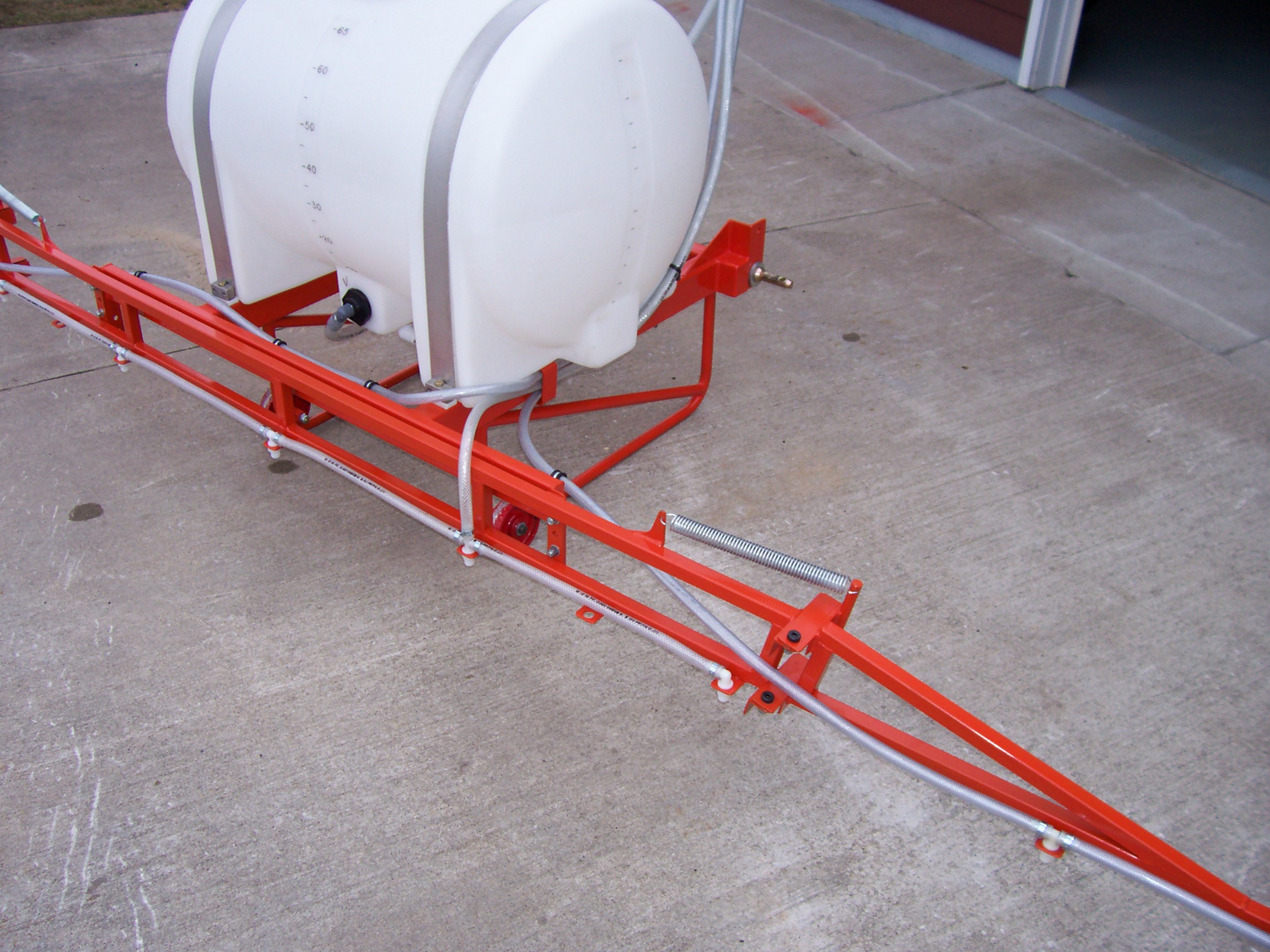

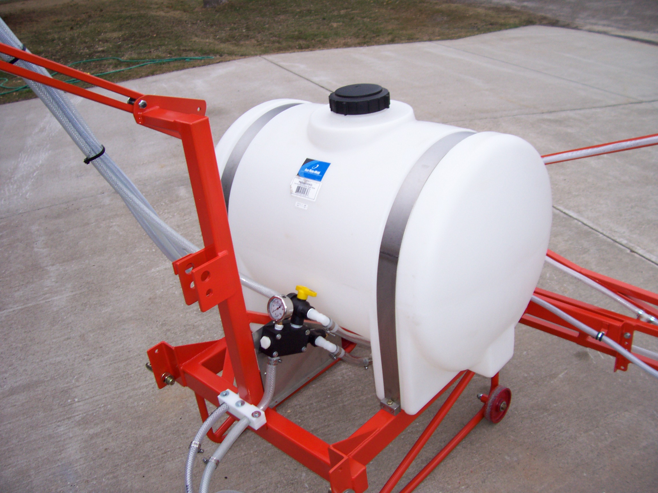

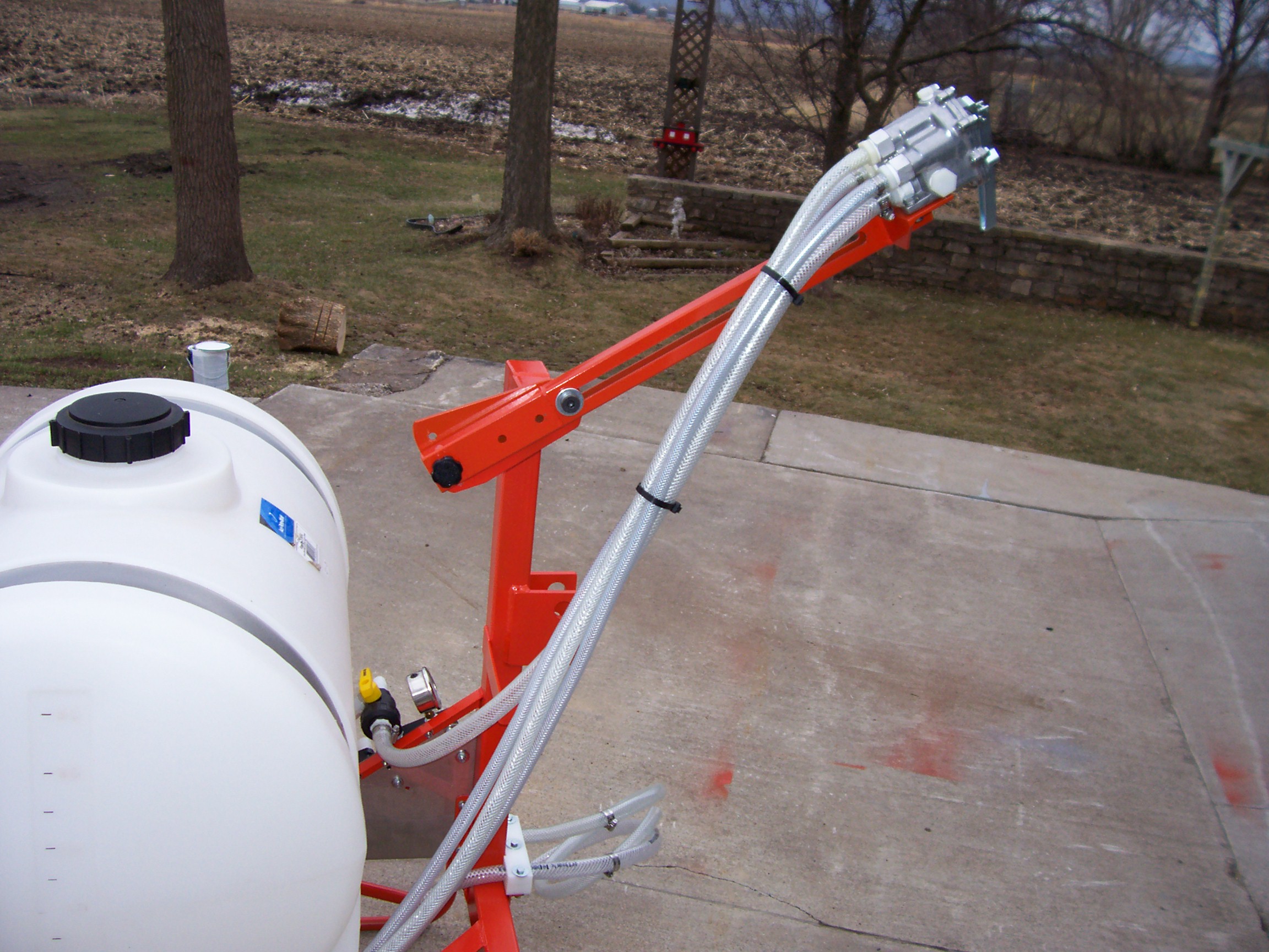

finished it and decided to post pics and thanks for the help.

The boom covers 20',hinges are at a 10 degree angle so they naturally always "want" to return to the strait position. Control arm is adjustable so I can reach it whether I am using a borrowed 4310 J.D. or 5510 and then can put it down in a stored or transport position. Small wheels are for moving it when it is to be pushed into a corner for storage. All orange parts were fabricated by me. All components were purchased off the shelf at the local fleet farm store.That makes it easy to service.

Could you tell me about the sprayer control that points back to the seat?
   / 3 point boom sprayer THANKS!
I have an "estimated" 350 dollars in this sprayer. Time I have no real idea. I work in a manufacturing facility "custom job shop type stuff" so I have access to metal and saws and welders and a good manual mill.I used a mill to machine the boom hinge holes so they would be nice and tight.I also milled the slot in the movable control arm, If I was to do it again I could do it in maybe two eight hour days. I don`t put value on my free time because I love building things.
The control for the booms is mounted on that arm because early on I realized that on most newer tractors, if the control was mounted on the top link post it would be unreachable from the seat. I made it adjustable to fit the two tractors I have access to. J.D.4310 and a J.D.5510 When not being used I can put the arm in a down or "stored"position. The bypass valve and pressure relief valve are located down by the tank because I felt that with the control arm being movable it would get pretty busy if I mounted them on the boom valve.(there are enough ports for the gauge and relief valve but again, I did not want all those extra hoses up top) The aluminum spayer control is available from most farm supply stores (about 60-70 dollars)If you dont want to control the booms separately a on off valve would do
The booms are made from 1" 14 ga steel tubing. The hinges are from 1"x1"1/8 angle.The two angles should be the same or when closed they won`t match. One of mine is off by about a half of a degree and it shows in one of the pictures. Most of the components here are plastic because Roundup/glysophate is pretty corrosive.

I thought I would bring this thread back to the top and post an update. I ran about three tanks full through the sprayer this past saturday. Everything worked great. I used a handheld GPS unit taped to the hood of the tractor to maintain a steady 4 mph. I sprayed off about 12 acres of old hay fields in preparation for minimun till corn. A foam marker system would be nice as its easy to overlap too much or miss and leave a streak. Vegatation is now showing that it is dying off. Its been five days. Break away booms got tested at that edge of a field and worked as designed.
