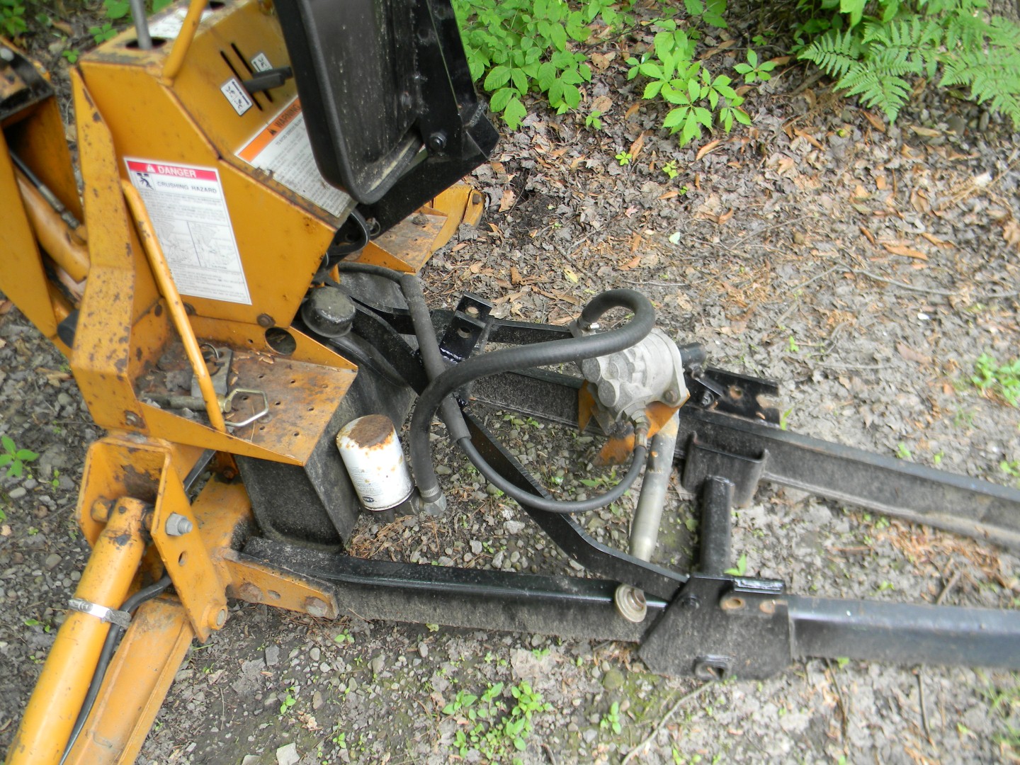

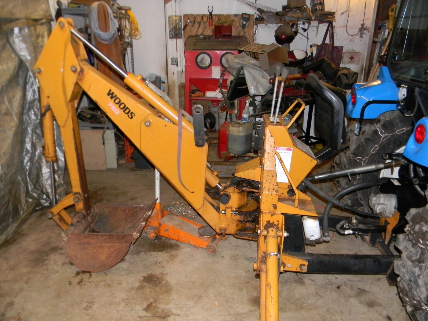

I have a Woods BH750 with sub frame and the tank is level with the pump.
I would suggest you build a sub frame to attach the BH to the tractor. I've never seen one but I have read of people breaking compact tractors using it just on the 3 pt. There are some that say it will work fine but I think a BH puts a lot of stress on the tractor, especially on the top link.

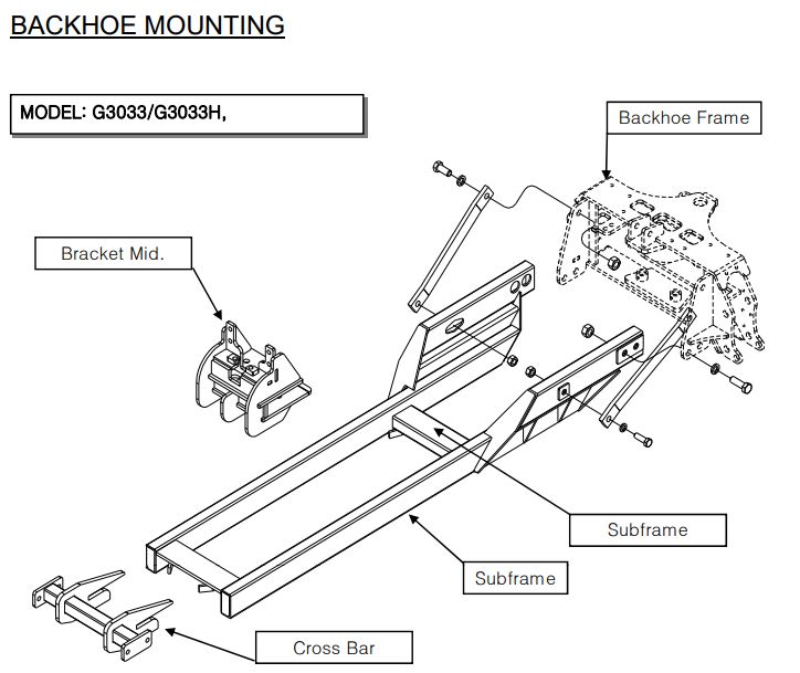

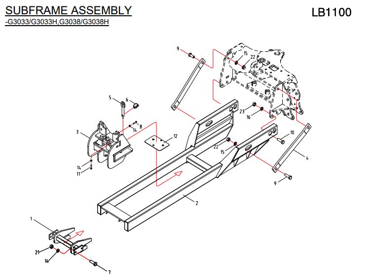

I really suggest you read the thread I shared. Dave is a remarkable fabricator and he is a CE so everything he does is well thought out. It is a long thread but I know if I was going to build a subframe I would read it all as there is much to consider. It is really not a difficult fabrication job but the thinking must be well done and Dave has done much of it already.
Thanks, FW. (Not a CE here, but EE and physics are what I studied.)
In your drawing, there is 2x4 tubing used, which can work well, but you really have
to weld both sides of it to make a good structural connection. Failure to do so resulted
in a major headache for Kioti with their FELs last decade. That is why I prefer
channel with 1/4" thick (min.) webs.
