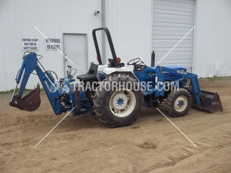

Today I bought my first tractor - a used New Holland 1920 with loader and 3 point back hoe. Being a complete novice, I had no idea that a 3 point back hoe was not a good thing until I just happened upon reading it on the internet just now. So now of course I'm kicking myself but what's done is done. What did really concern me, however, was hearing about people being seriously injured using them. Is this a real concern or is it something that can be avoided?
Also, I hear they are not for heavy use, but I really have no idea what constitutes heavy use. Where I live we have sandy loam soil and some clay, and no rocks at all. I am planning to dig a lot of 2 to 3 foot deep trenches. Is this considered heavy use? I'm not ready to get seriously injured over some trench digging but at the same time I really can't return it and I'd hate to turn around and sell it just to buy another. Please advise :)

Actually I probably spoke too soon because honestly I have no idea if it's 3 point or not. The tractor hasn't been delivered yet and I just assumed the worst after reading the warnings online. Can anyone tell from the picture attached if it's 3 point or not? Please bear in mind that until a few hours ago, I didn't know there was more than one way to mount a back hoe, so excuse my newbiness :)

Looks like it has it's own sub frame mounted to the tractor.:thumbsup: It will dig your trenches no problem. When people talk about heavy use, what they mean is that it is a farm duty backhoe and not a heavy duty industrial backhoe. Don't push it too hard and let the hyd's do the work and it will give you many hours of dependable service. It's not designed to go flat out for 8 hours a day, 7 days a week. Don't skimp on greasing all the pivot points. It looks like a very handy unit to have. Read the manual on it and start off slow. It will take some practice to get used to.

Yep, looks like a sub-frame to me. The 3PH arm appears to be doing nothing.
Some shallow trenches in sandy soil I wouldnt consider heavy use.
Digging out stumps, digging basements in rocky soil, demolition, etc is what I consider heavy use.

Sub Frame . Look in front of the rear tire and you can see the " Frame " of the B.H. Coming forward were it attaches to / pins to posts that come down were the F.E.L. also attaches to tractor . Those " Posts " can also be seen coming down from FEL. .
Not sure what size / model BH it is , I have a 757C on my TC 30 , But if you ever need to take it off , I can walk you through it . Takes me maybe 5 minutes to put it on or take it off . Pretty easy , just need to follow a routine to aid the process .
