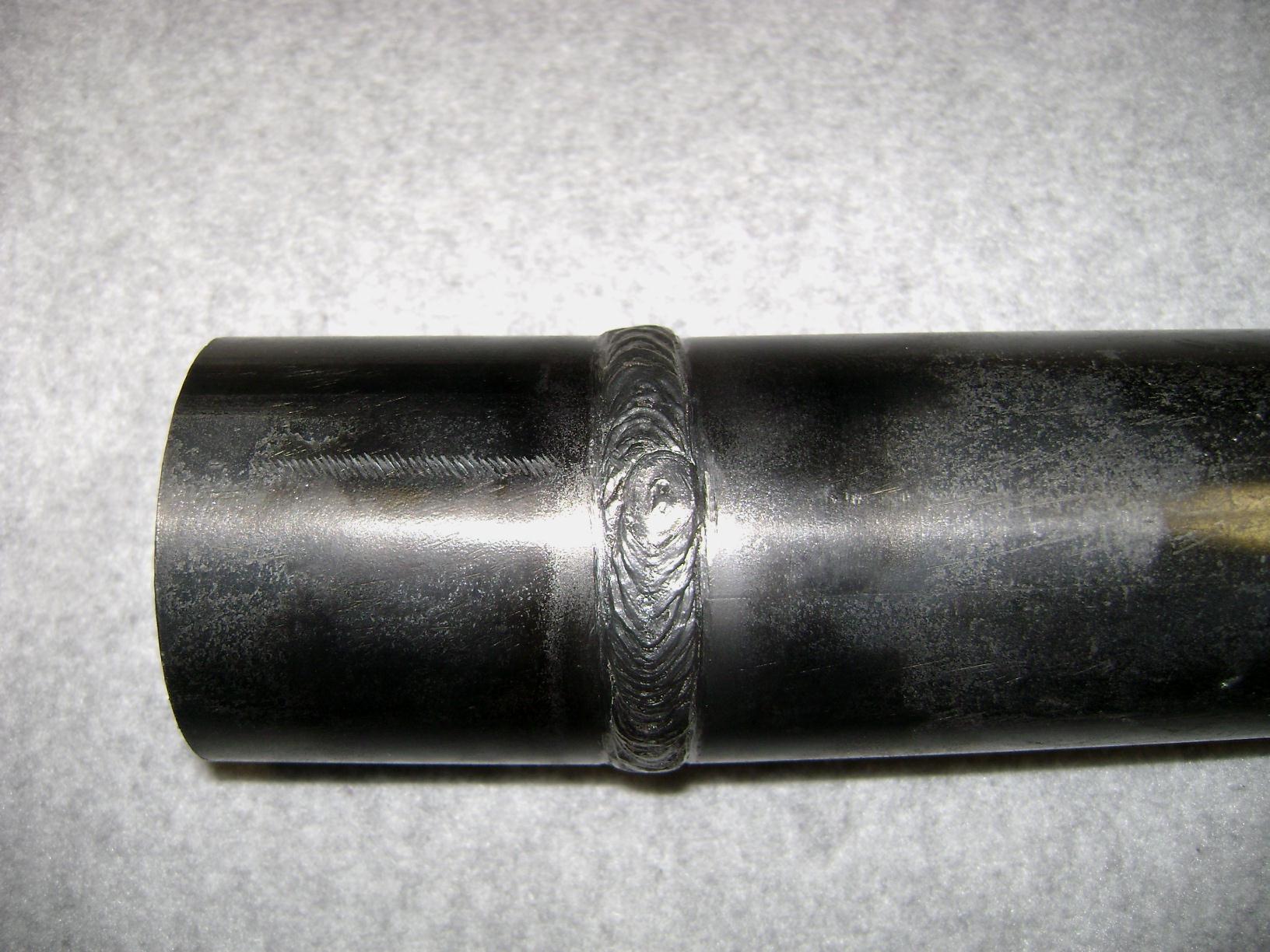

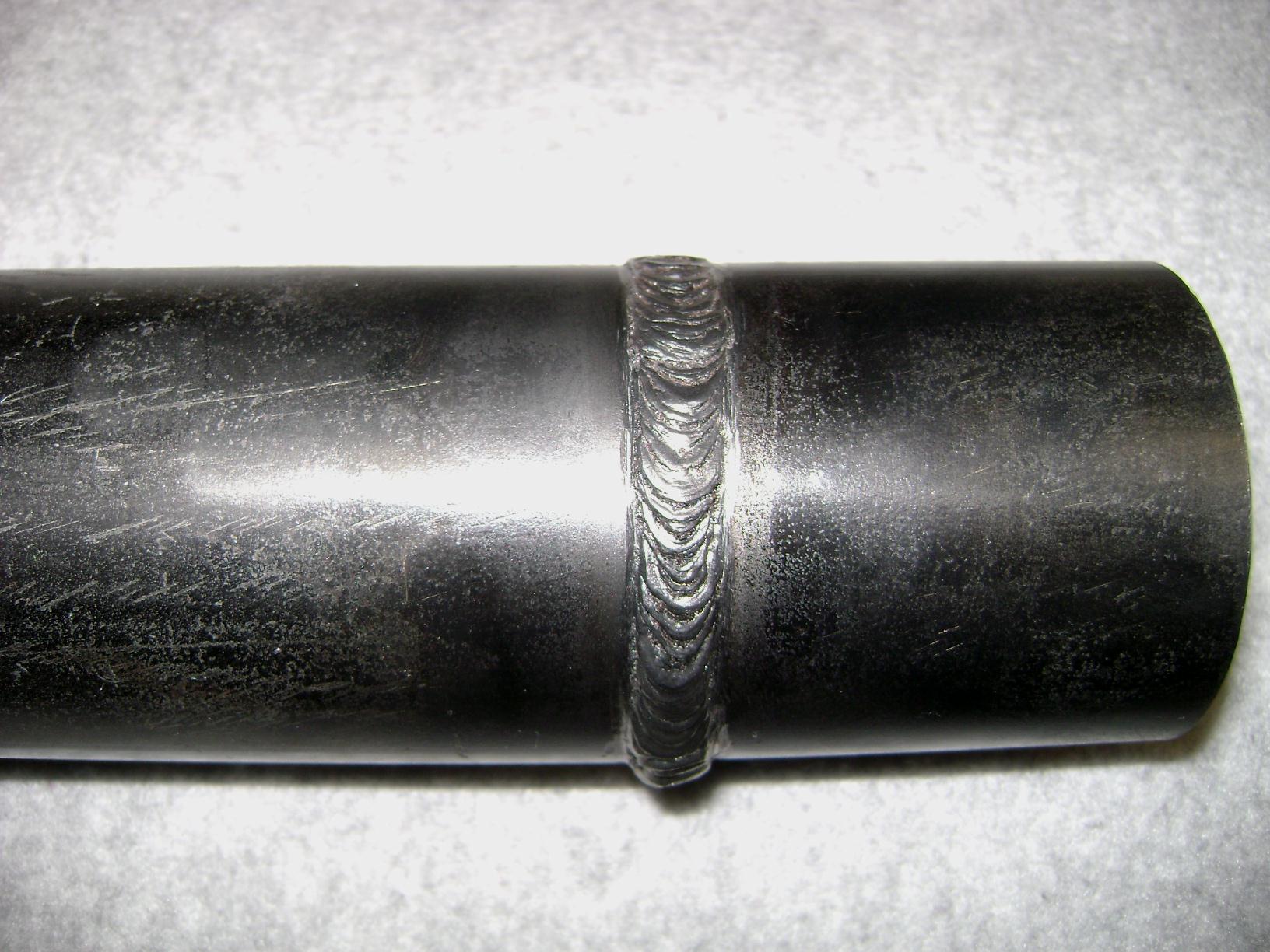

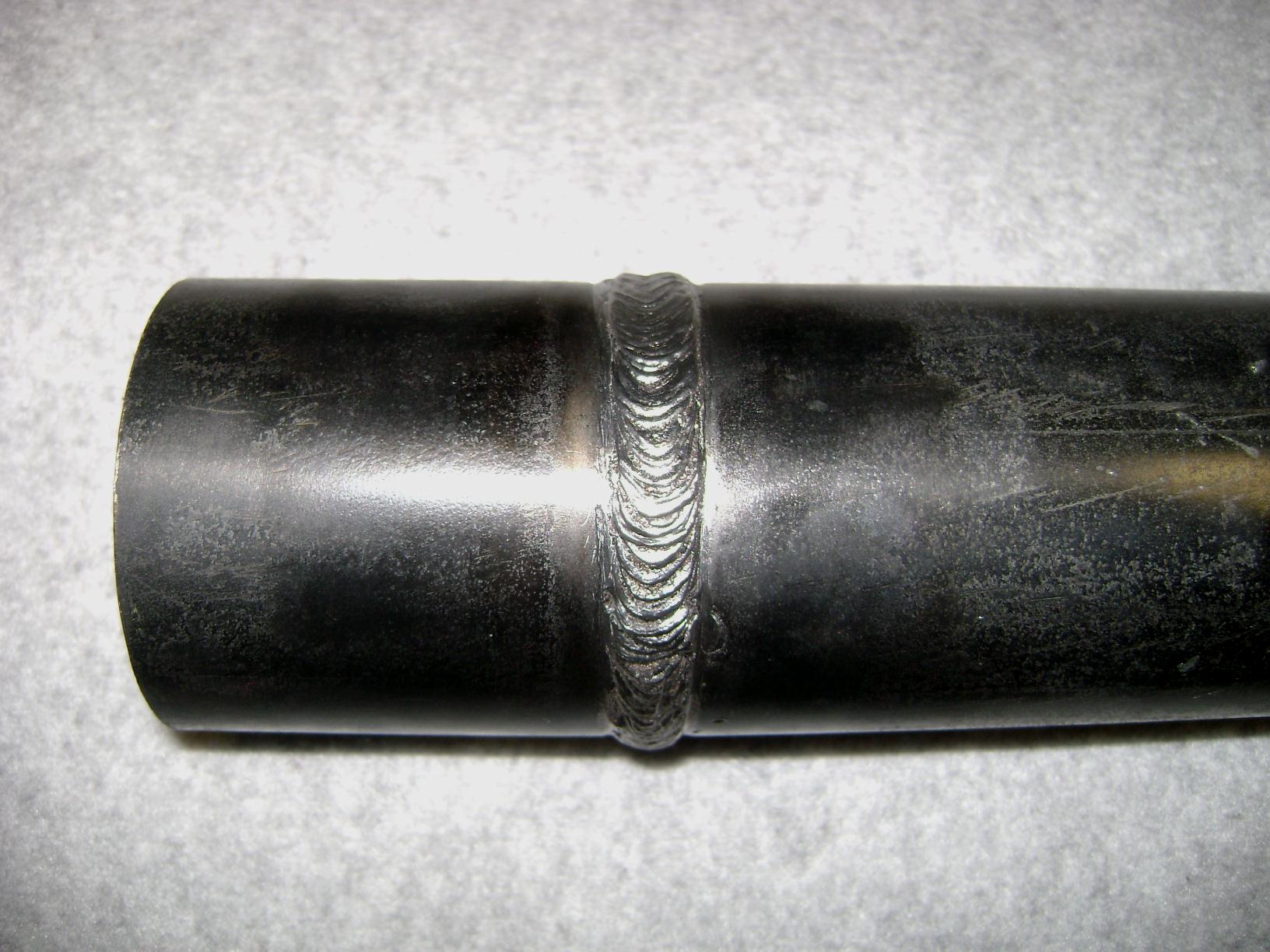

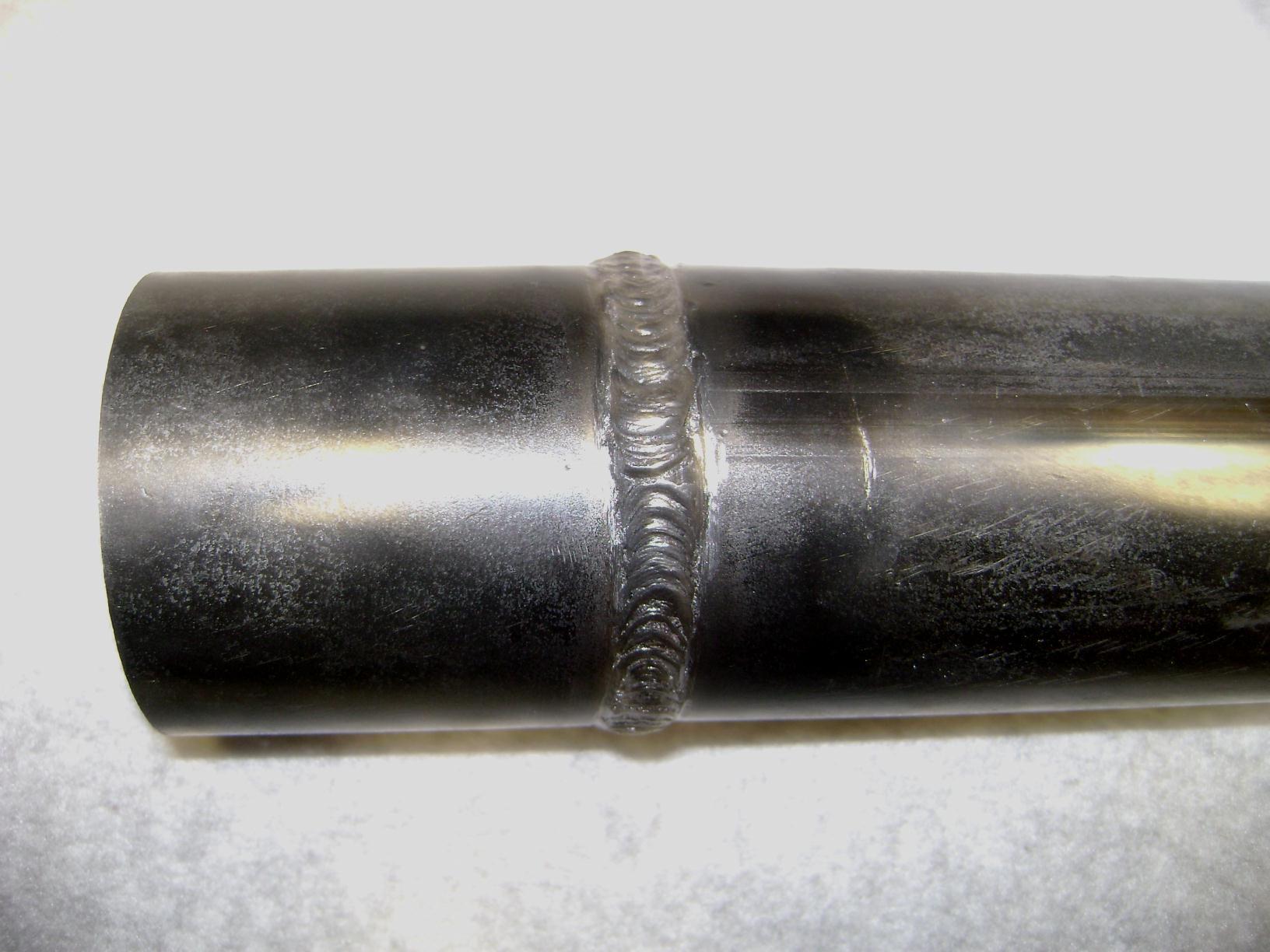

I whip my 6010 / 11, but I was reading a thread on another site where pipeliners were saying they do not. They run 6010 just like 7018. I need to try that, I might like that better! :laughing:
