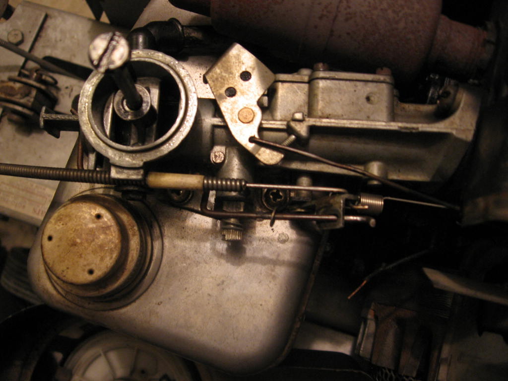

I've enclosed a picture hopefully this helps

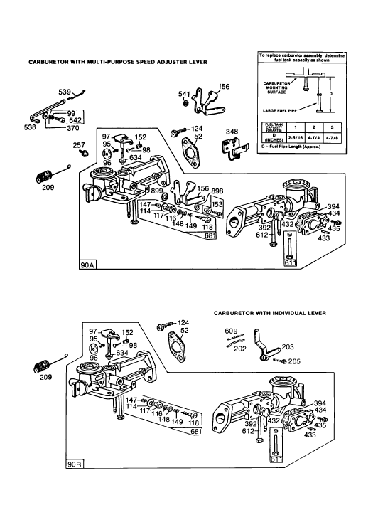

Diagram nuber 348 is the stop switch. The new part number is 691941. Briggs carb.gif
