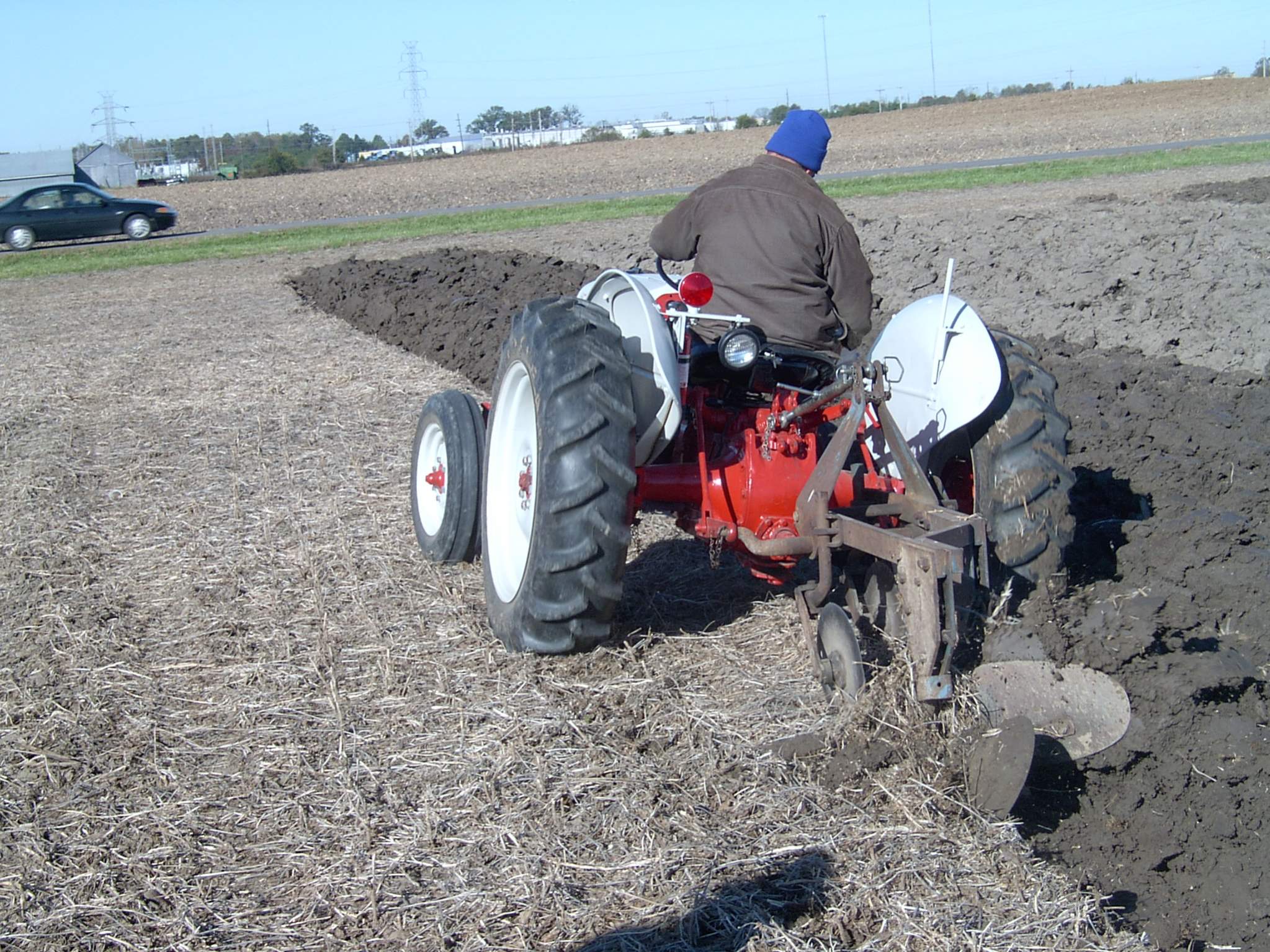

Have you ever plowed before? Takes a little skill and experimenting to set up tractor and field. Plus, you still have to disc, do you have a disc? A tiller does a very nice job at loosening up the soil in one pass. Got this old 2 bottom Ford trip plow for $100 and it works great. Philip.
