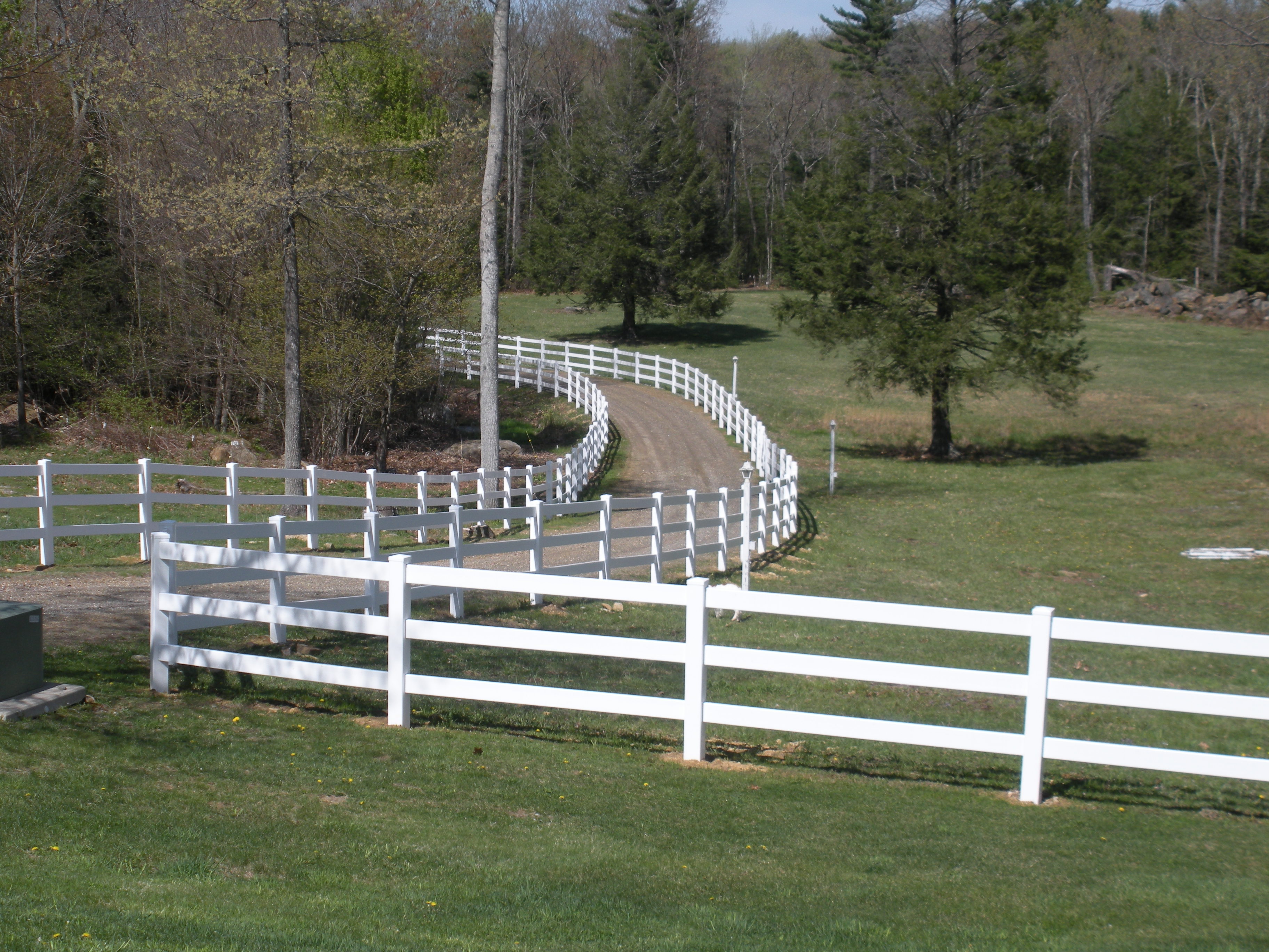

Wondering if anybody has any experience with installing 3 board white vinyl fencing. I am getting ready to put up a bunch of it and would like to do it myself.
Can this be a 1 man project? Looks a lot easier than panel fencing but I do not want to bite off more than I can chew.
Have tractor, FEL and PHD.

Anything is possible, just takes more time. Anyway you could recruit a helper?

I don't see why not, though it will be much quicker with an extra hand. My GF and I put in a bunch of six foot fake rock panels, and some white vinyl fence (with vertical pickets, each one separate). Except for the holes—we used a two-man auger for them—I could have easily done the whole job myself. So install and plumb a post, when it's solid in the ground, install the rails and the next post, plumb it, etc. Not a big deal for 40 or 50 sections; if you have a mile or two to do, hire someone to help!

I put in about 2,000 feet of it at my place. Over half of it was by myself. It's faster and easier with a helper, but sometimes also more frustrating. I was a huge fan of it from seeing it other places, but after about 15 years of it, I'm not such a fan anymore.
It installs pretty easily. I use a 12 inch auger and mark all my spots to drill with either orange flags, or orange spray paint used for marking the ground. I hve a 300 foot tape that I anchor in the ground with a long screw driver, then stretch it tight to mark a straight line. Once all my holes are marked, I begin drilling. I'm on my third brand of auger, and really like how well the Country Line brand works from Tractor Supply. Just be careful of it digging too fast and burying itself into the ground.
Even with everything lined up perfectly, the auger will move on you while drilling and you will have to adjust the holes manually with a clam shell digger to get your posts perfect. You will need a string line to make sure you stay straight, along with a post level. Once you get your posts set, installing the railing is fairly straight forward.
For gates, I prefer using steel square tubing the same size as the vinyl posts and welding on the nuts to the posts, with a hole in the post so the gate hangers can screw onto the nuts and into the post. Then it's easy to hang a gate and adjust it. Paint it white and it blends right in.
Overall, it's a nice looking fence.
The negatives are that it's not very strong. If you have any animals that will lean on it, or use it to scratch on, it will break. If you mow near it and through out a rock, the rock will go right through it. If you're rails are not perfectly centered inside the posts, when the ground moves in winter, the rails will pop out of the posts. I have two spots where this happens on my fence. My spacing was off an inch, and my rails are not quite inside the posts far enough for the factory notching to hold them in place. I've modified the notching and it's been working for quite awhile now, but I wouldn't be surprised if it happened again. Green mold, or algae grows on the shadow side of the fence. For me, it has to be washed with bleach about every five years. It's an easy process, but very time consuming.

Thanks for the advice. I have several sections that I need to install. I will try the smallest area by myself and see how it goes. I have put up miles of field fence by myself so I might as well give it a go. Ultimately, I want 10 acres fenced.
I pretty much have to use the vinyl. This is an equestrian community with a few basic rules. One is that all of the fencing is the same.
No issue with movement in winter. This fence is for our place in SW Florida.
