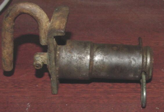

When I got my 2pt tiller, there were no pins through the pivot point near the pto. Anybody have some pics showing how this pin works or what it looks like?

Tim, the attachment is a photo of one of the pins from my YM1110D. I loaned my tractor and tiller to a friend for a summer, and he lost one. I have never replaced it. If you like, I can take some measurements for you so you can have some made, or try to get some from a dealer. The pins for my YM1301D work on my YM1110D, but the larger diameter section is longer so they stick out a little bit.

I presume the loop is there to pull the pin? What about that little bend to the plate, is it to keep the pin from roating? I just sent a e-mail to Ernies to see if they had any in stock.

You are correct. The loop is for pulling it out, and the bend in the plate is to keep it from rotating - though I'm not quite sure why. I guess it is just so that the pin doesn't rotate so the zerk is inaccessible.

Is it possible to turn one from a hitch pin? The handle would be built in then. We wouldn't need the tab to keep it from rotating and the groove for the hair pin could become a simple hole. Maybe use a lynch pin instead so it's easier to install.
