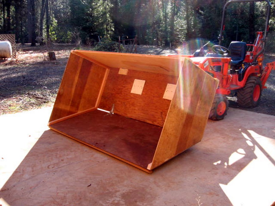

Got a lot of leaves to move? Got a scut or cut? This may be the answer. A two yard dump bucket! The trial run was fantastic. See it in action at Kubota Owning/Operating forum.
This may not fit your needs but it works great for me. Five acres of Black Oaks and Ponderosa Pines make huge fall clean-up. This is sure an improvement over a pitch fork and trailer! The main purpose was to get all my scattered leaf and pine needle piles gathered to one or two central burn areas instead of having a dozen burn piles around the property. And now all those Oak leaves that I want to mulch can be carried over the gravel drive to the garden instead of raking and introducing a bunch of gravel.
Bear in mind: This is a large volume - small weight capacity bucket. No heavy loads allowed!
This is a prototype of wood to see if it would work and to trouble shoot any bugs. The prototype worked so well that with only the addition of a stiffener behind the lip attachment and a pair of metal forks this prototype may stay in service until I break it. That way I can get on to building other things!
All the prototype materials were scrounged from supplies and scraps on hand. My out of pocket cost was zero and took one day to build. If all materials were purchased new cost should be $100 to $150 (for the wooden bucket).

An interesting design feature is that the bucket sides (ends) are removable. The top then hinges down against the back and the pair of these hinge down against the bottom. This knock down feature allows storage in a very minimal space. For my prototype I need to unscrew the ends. With metal construction these could be quick pinned together.
For this bucket the bottom is 3'-0" x 6'-8", back 2'-5" x 6'-8", top 2'-3" x 6'-8". The back to top forms a 90 degree angle. I don't remember the bottom to back angle but I think it was around 119 degrees. "Struck" volume is 1.97 cuyd. These are "rough" dimensions to fit a bx23 bucket. Your dimensions would vary to fit your bucket.

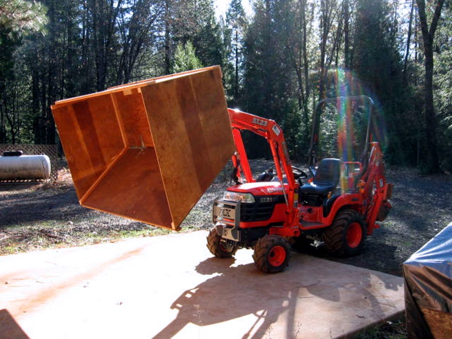

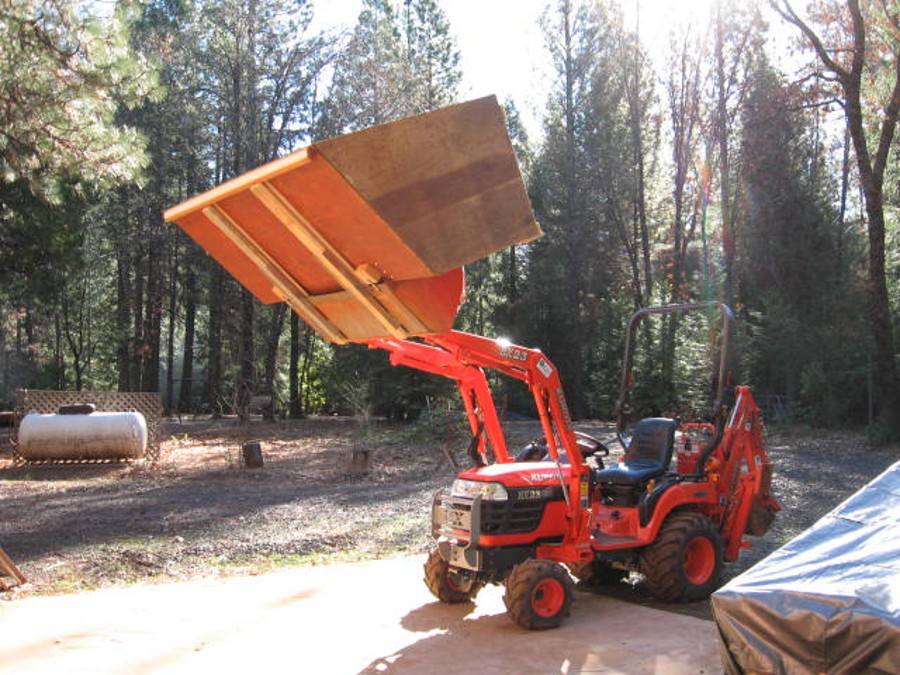

Well, it lifts

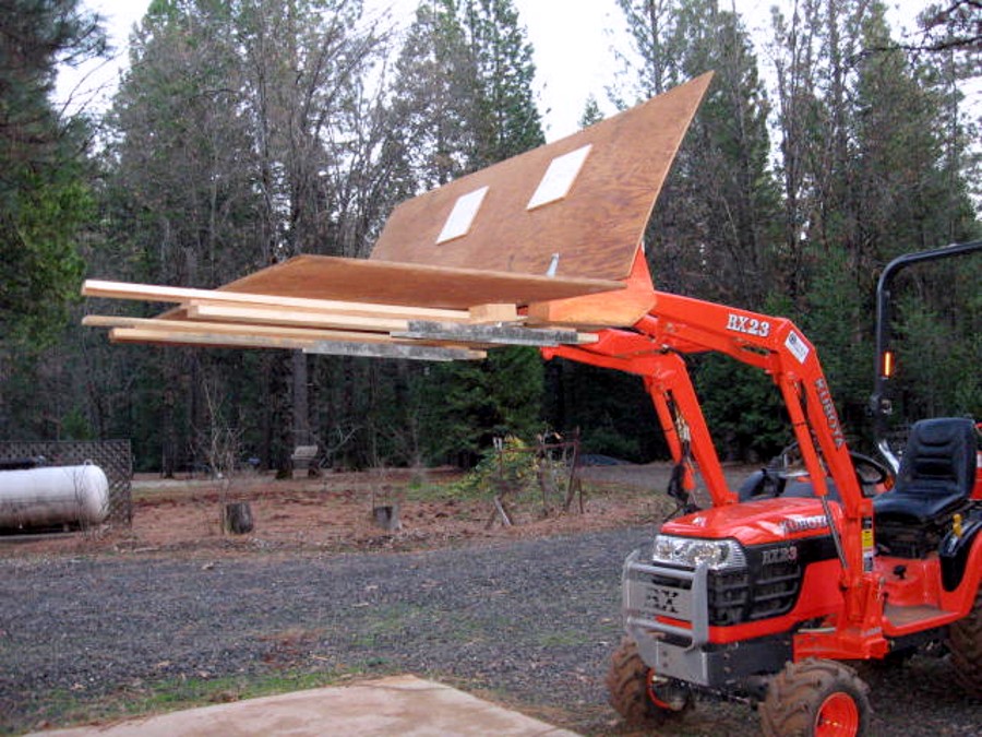

And lifts high

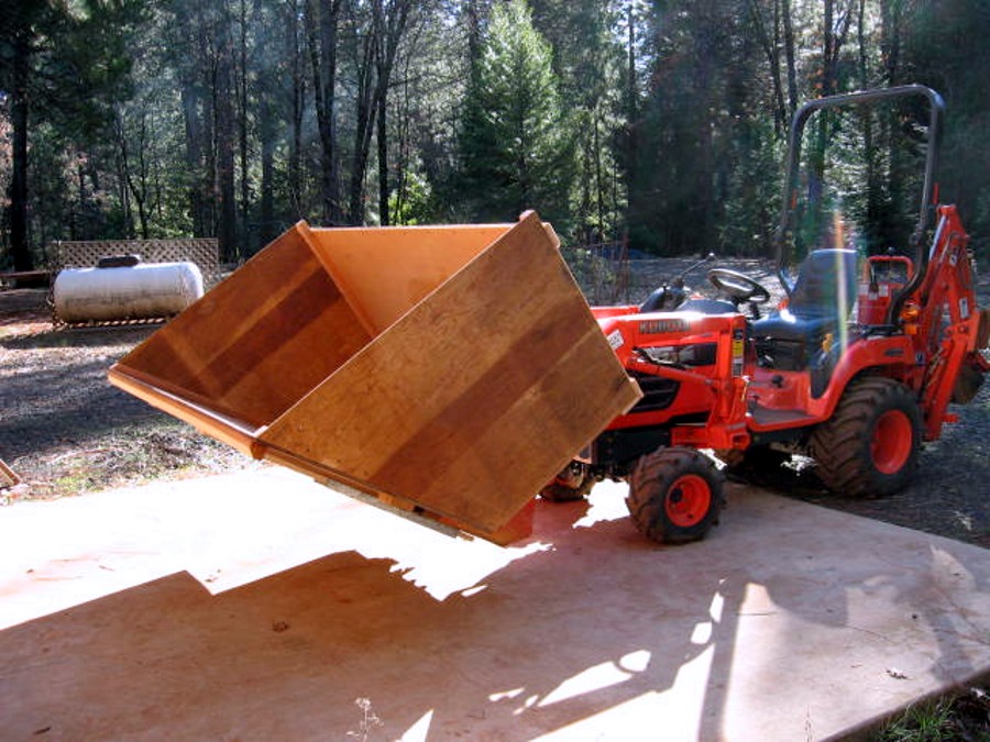

Dumps OK too

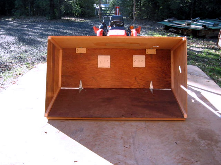

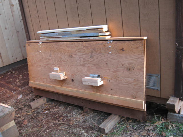

Front opening is 6'-8" wide x 3'-10" high

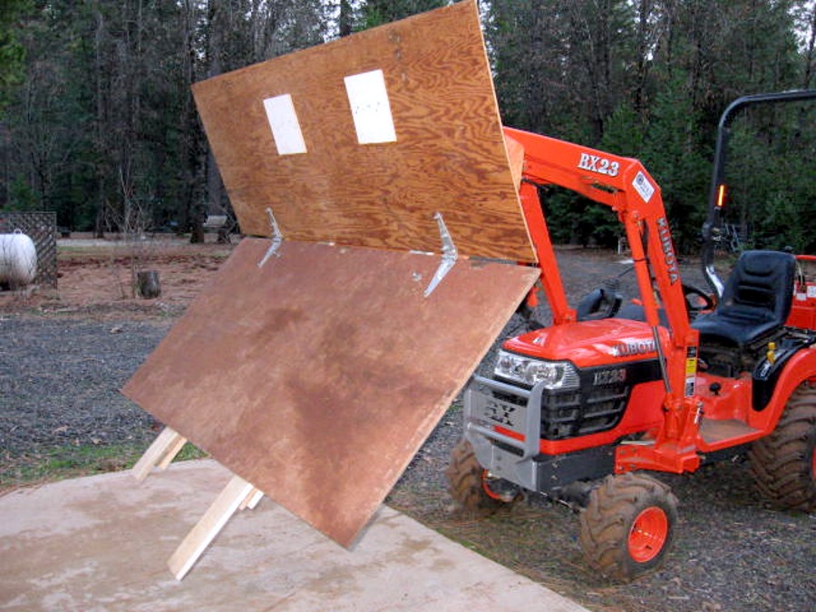

I hinged the bottom and back with strap hinges and laid against the tractor bucket to get a feeling for the size and fit

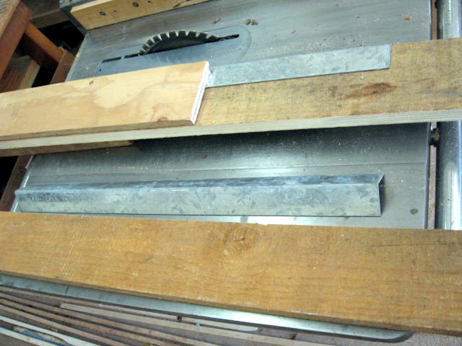

"Make-do" forks are 1x4 wood w/ spacer for cutting edge and sheet metal "L" reinforcing. I placed two through bolts just behind the spacer then the rest of the length was grabber screwed top and bottom. Not the strongest forks but they worked for the prototype.

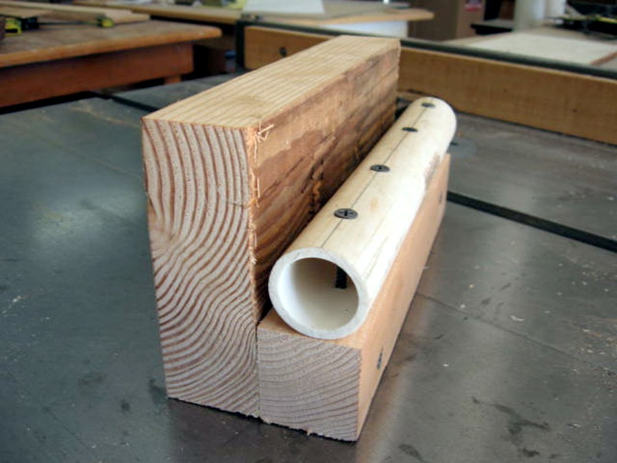

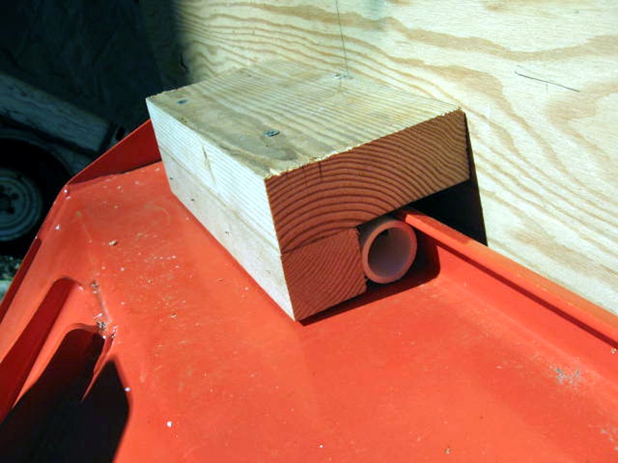

Bracket to attach back of wood bucket to top lip of metal bucket. What you don't see are two more screw in the back of the 2x6 into the 2x2
A wedge is placed between to two buckets to push the pipe forward and engage the lip. I had a little misalignment problem and the left bracket never fully engaged the lip but it ran fine this way in trials.

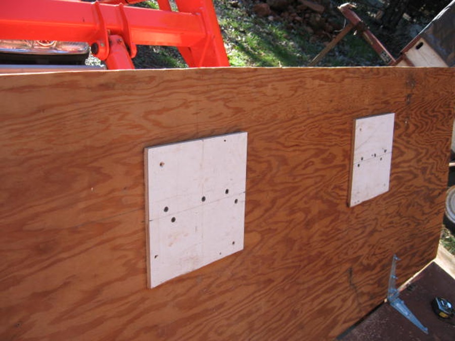

On the inside back of the bucket the lip brackets are backed by a square of 1/2" ply. In trials this was the only evident weak point and I'd run a full length reinforcement at the brackets. The reinforcing could run horizontal through both or use two vertical, one at each bracket. I'd try to make this so it did not interfere with the fold-up design concept. Of course a heavier back would be good, this one is only 1/4" ply.

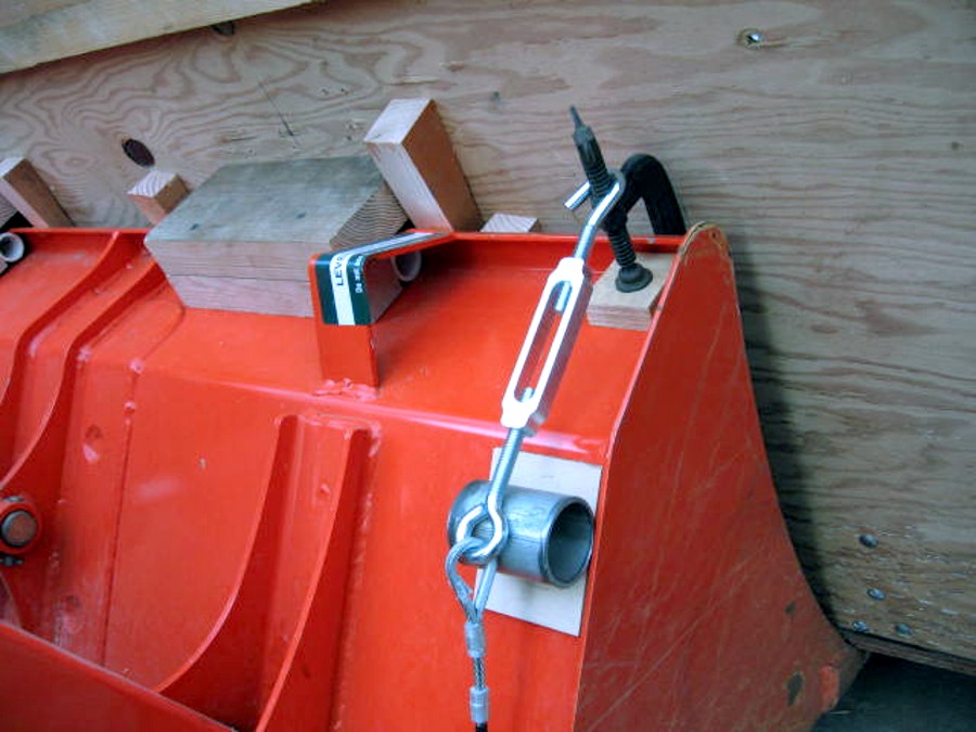

Main attachment is a cable and turnbuckle assembly that "sucks" the two buckets together. When I install my bucket forks I'll get the common, not weld-on, chain hooks so I can use the hole in the back for this attachment. But the "C" clamps worked fine too. The turnbuckles were what I had (too long) so the pipe spacer was added to keep the lead fair.

I cut the sides and attached w/ 2x2 cleats. Everything is screwed together on 4" centers
