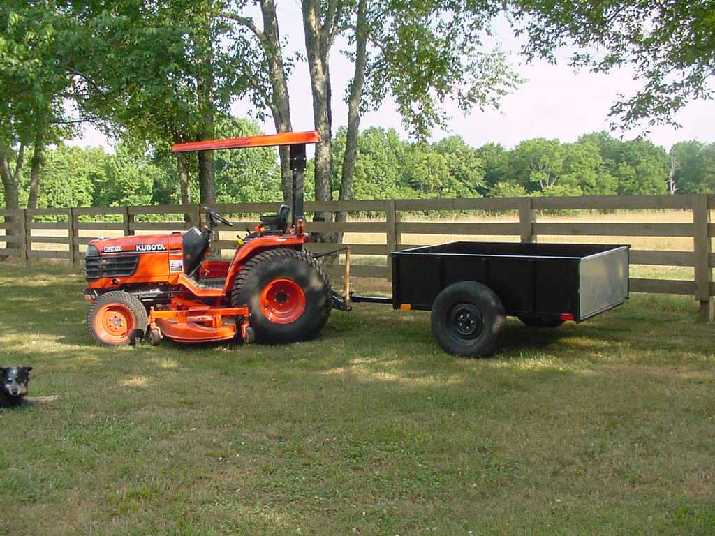

Sold my wife's riding mower and got her a B2910 Kubota. Sold the cheap, sheet metal, small sized yard cart with the rider as well.
UH-OH Didn't know how much the wife thought of that cart. Orders were - I gotta have a NEW , BIGGER cart. Ok Honey So attached is what I built. 4' x 6' with 20" high sides, and a slide in/out tailgate. Color scheme is just like she likes. Black on Black on Black with just a leeeetttttllle bit of chrome. I am back in good graces for now. Whew!

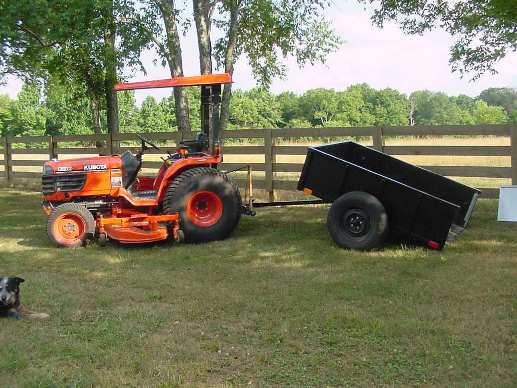

Yes of course it TILTS. The old one did!!
I wanted to paint the wheels ORANGE, but she won.

Bought it from TSC. I believe it was "Reliable" brand they carry. 2K cap. 5 bolt 4 1/2" bolt pattern. About $90. Overkill for yard cart but all I could find at the time and I had some wheels/tires to fit. 48" spring centers but no springs. Just welded right on the frame.
