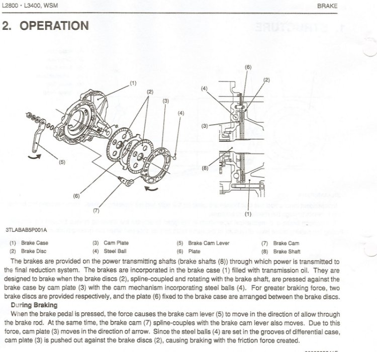

after running thru some high grass and broken branches today i have no brakes.everything under looks ok but pedal just goes to the floor with no resistance.2 springs are attached they were fine before as usual.what am i missing here.

/ 2800/3400 brakes #10
The brakes on the L2800/3400 are wet but not hydraulic activated. See the attachement of the brake system from the service manual.
If you brake pedal goes to the floor I would not think low hydraulic fluid level would cause that. I've never had one apart so I'm not sure but it does not appear that way.
My 3400 came with the fluid so full that the bubble in the sight glass was not there. I added fluid and no change in the window. I then drained it and saw the line in the window. If the glass looks just a bit yellow that is fluid. Pure white is no fluid.
Check your brake linkage for slippage.

/ 2800/3400 brakes
#13
you are correct about the mechanically actuated wet brake system.thanks for the info.i went to the dealers today and looked under another l2800 and i found that i had bent the rear bracket that holds the adjusting rod and nut sideways.i bent it in such a way as it looked perfectly factory distance and appeared factory fresh.returned home pulled the bracket off straightened it out and presto new brakes again.
