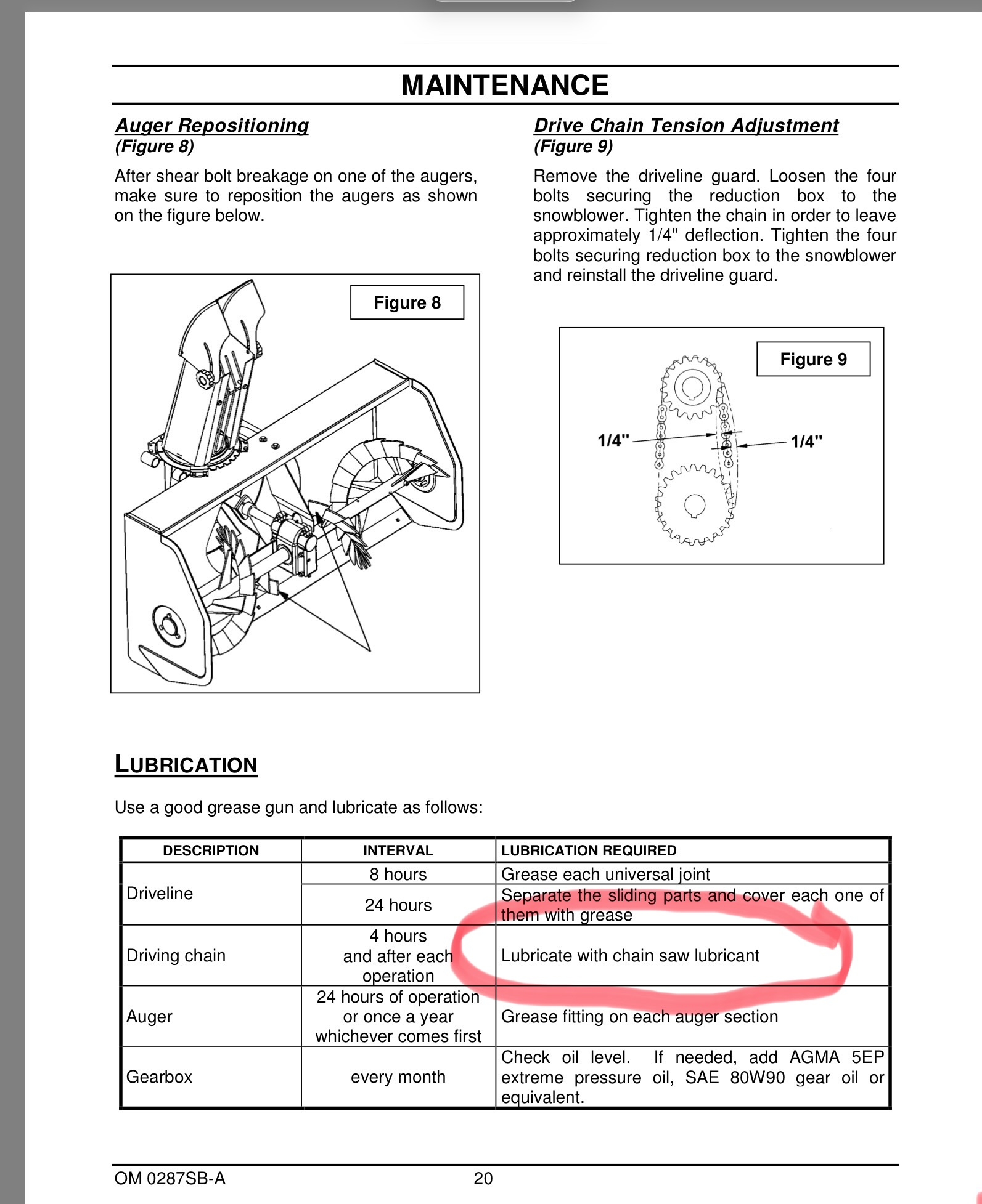

Feb 24, 2026 / 2750D #1 W whatever1 Silver Member Joined Nov 19, 2006 Messages 131 Location Earth What does everyone use to lube the chain in a 2750Dblower ? chain oil ? white grease ? ...
Feb 24, 2026 / 2750D #2 Chewwy Platinum Member Joined May 5, 2015 Messages 895 Location Upstate SC, Near the Electric City Tractor Kubota L3240, MF 265, MF383 From the operator’s manual. Attachments IMG_1740.jpeg 697.3 KB · Views: 16
Feb 24, 2026 / 2750D Thread Starter #3 OP W whatever1 Silver Member Joined Nov 19, 2006 Messages 131 Location Earth Thank You..... I have been using chain oil for the last 10 yrs. and had to make an adjustment 1st time start of this season.....

Feb 24, 2026 / 2750D #4 D diesel85 Veteran Member Joined Jun 7, 2017 Messages 1,189 Location Vernon, NY Tractor Kubota BX2200 I use Kawasaki motorcycle chain oil on my snowblower.
Feb 24, 2026 / 2750D #5 N number two Veteran Member Joined Apr 2, 2007 Messages 1,409 Location Northern Lower Michigan Tractor Kubota B3030HSDC Kubota L2501HST A deceased biker friend told me he had tried everything. Said Lucas Oil Treatment was the best. Part #10001 for the quart bottle. I have to agree-sticker than bar oil and lasts well. Good Luck!
