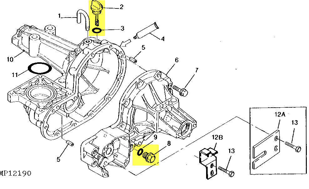

Hey all. I got all my parts/fluids in to do my first service on the 265. I don't have a manual yet so have a couple questions on the procedure.
-Is this as simple as removing the drain plug, changing the filter, and filling to the correct level on the dipstick? I've read that some other GTs have multiple fill and drain locations.
-Any good rule-of-thumb tips to make it easier or better? I plan to drive it around the yard a little to warm up the fluid before draining. Isn't there some kind of purge method after a fluid change?
Anything else?
Thanks for helping a noob! :thumbsup:

Two different oils were used. If red; use JD all weather hydrostatic oil or type F ATF. If honey colored use Low Viscosity JD HY-GARD. Takes about 2.6 quarts.
One drain plug.

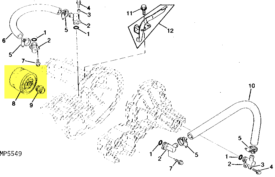

My manual shows the filter horizontal, not vertical and upside down as your drawing shows. It is that way on my machine too (1989)
Coat filter seal with clean oil. Fill 1/3 to 1/2 full of correct oil. Quickly install. (I am not sure if this applies if you have the "upside down" filter.
Fill with correct fluid. Start check for leaks. Check for correct oil level. Correct if necessary.

Thanks for the info. The filter is actually shown on a different diagram. Mine is indeed horizontal and on the right side. The first diagram I attached just shows the dipstick and drain plug.
I bought a gallon of the low-vis hy-gard. Do I need to stick with Type F if that's what comes out?
Here's the filter diagram.
