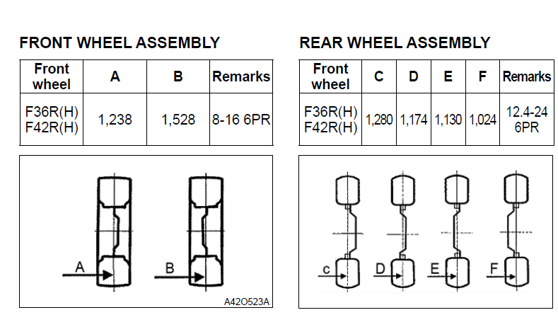

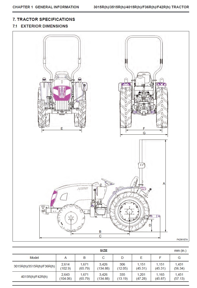

I can share the tire tread width for the higher HP models of the Branson. This is from the manuals for the 3015, 3515 and 4015.

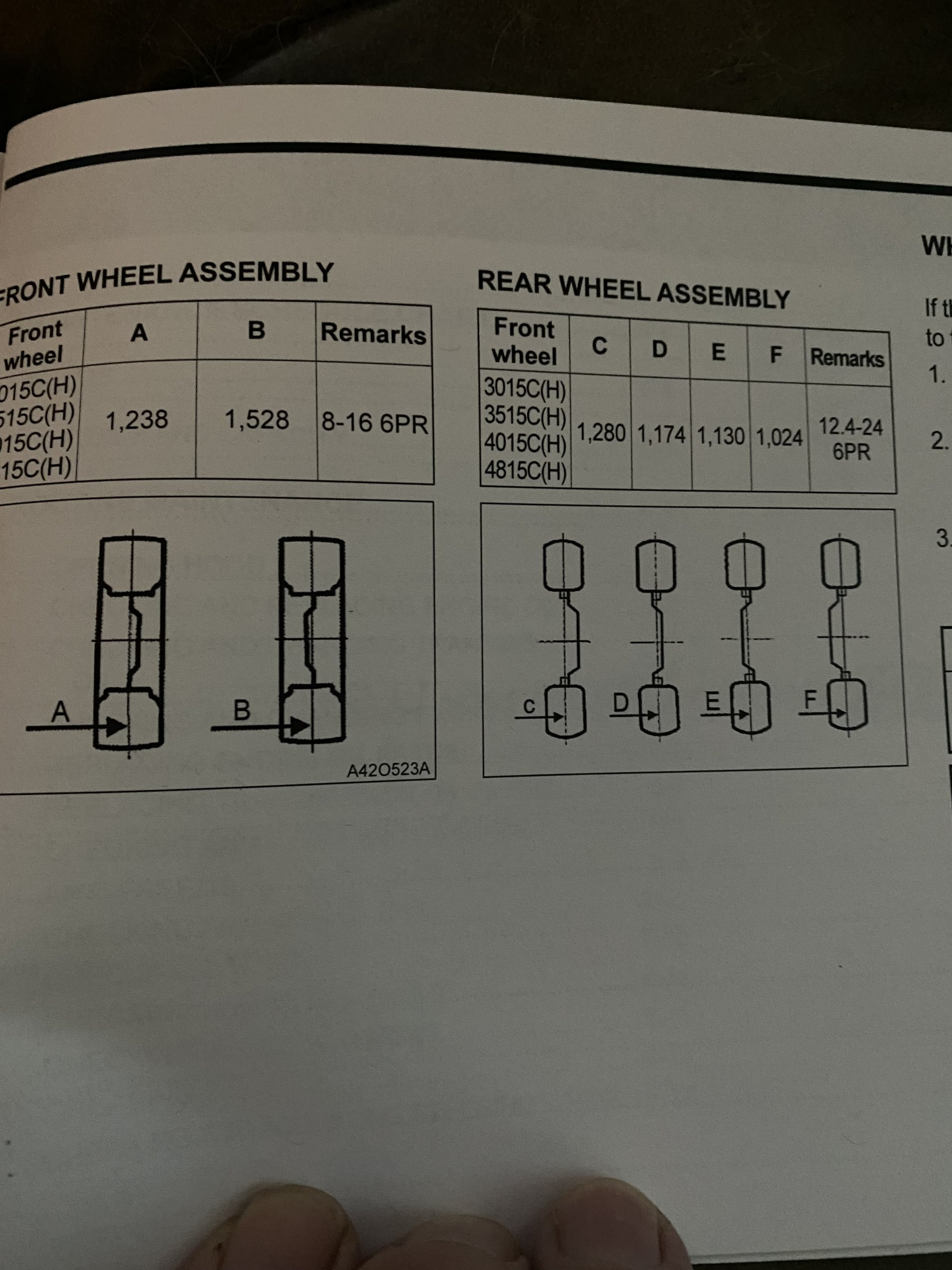

That's cool. Does the manual say how wide or narrow you can adjust them too?

Here is a picture from the Branson 15 series manual. The front is adjustable to two different positions The rear 4.
