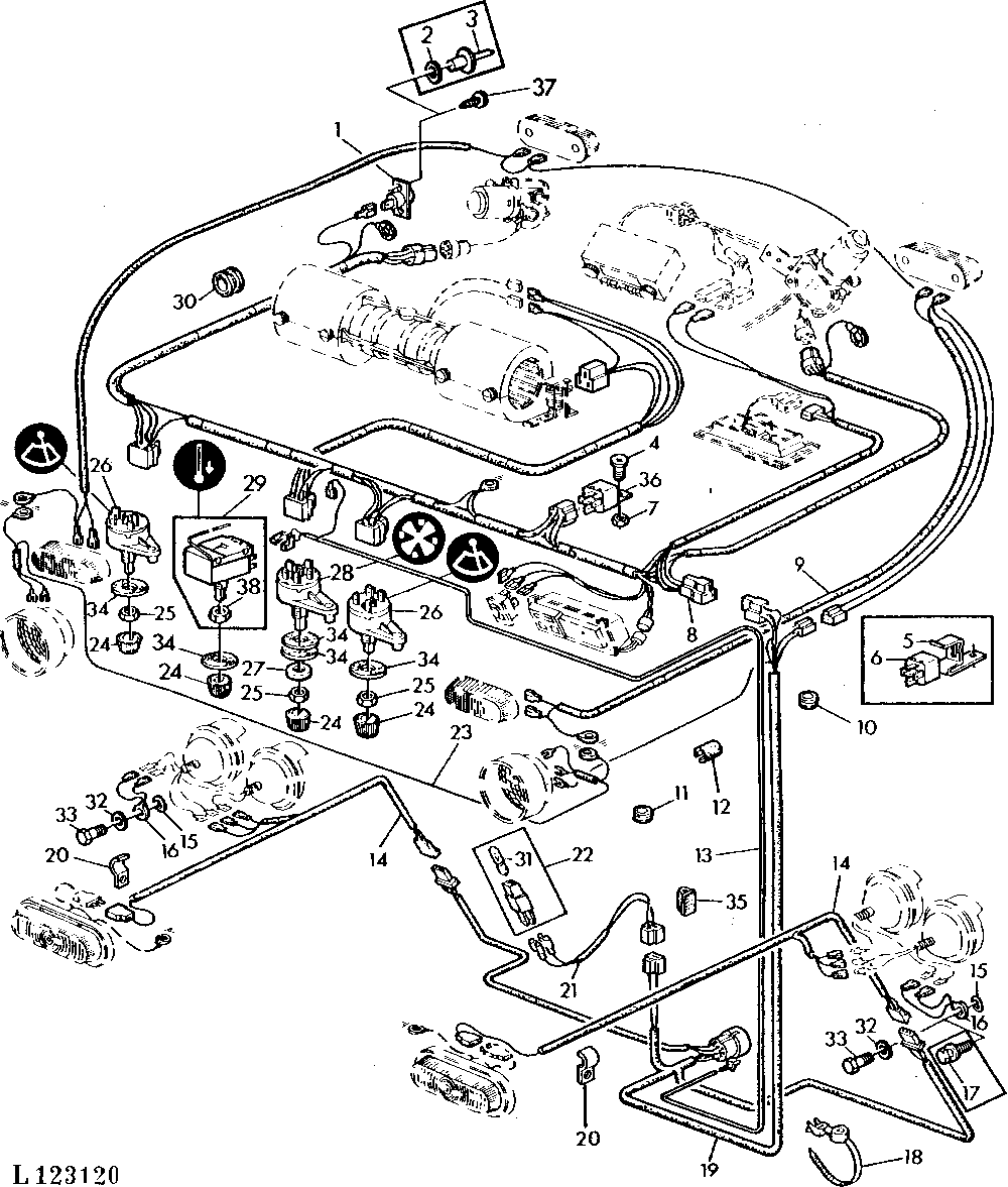

I recently just purchased a John Deere 2550 cab model tractor. My first cab tractor ever! I am trying o install a new kenwood CD player in it to replace the amazing cassette player that was in it. Only problem I am having is finding a 12 volt constant in the ceiling. Does anybody know if there is a constant "hot" wire up there or do you know where I can find one or what is the easiest route to run one up there? Any help would be greatly appreciated.

Did the radio that came out of it have a memory in it? Or was it older than that?
There should be one up there. If you have pics of the old radio and what wiring you have to work with, that would help.
/ 2550 Radio Install help #3
It's been a long time since I've thought about the wiring in a 50 series SGB(cab) but they had digital clocks as an option and I think the dome light will have full time electricity. I would even think the radio wiring had a memory wire. Without the aid of a service manual I'd suggest to remove the 3 screws under the overhang at the curved front and then remove the 2 bolts in the roof and raise roof. It will be hinged at the rear and have a rod at the front to prop roof up at an angle. Then take a test light and look for a "hot wire"

The radios that Deere used in the era when 2550's were made had no memory that required a constant hot wire. The only place you will find a constant hot in the roof area is at the dome light as TxJim suggested. The memory wire for your new radio will work fine if connected there and it won't overload the circuit.

Thank you guys for the information, I was wondering about the dome light and was thinking that might be an option. I will take the test light to it this evening. To reply to previous comments, the radio that was in it was ancient tape player that had no memory and the wiring harness only had the switch hot wire and ground wire plus the two speaker hookups in it.
