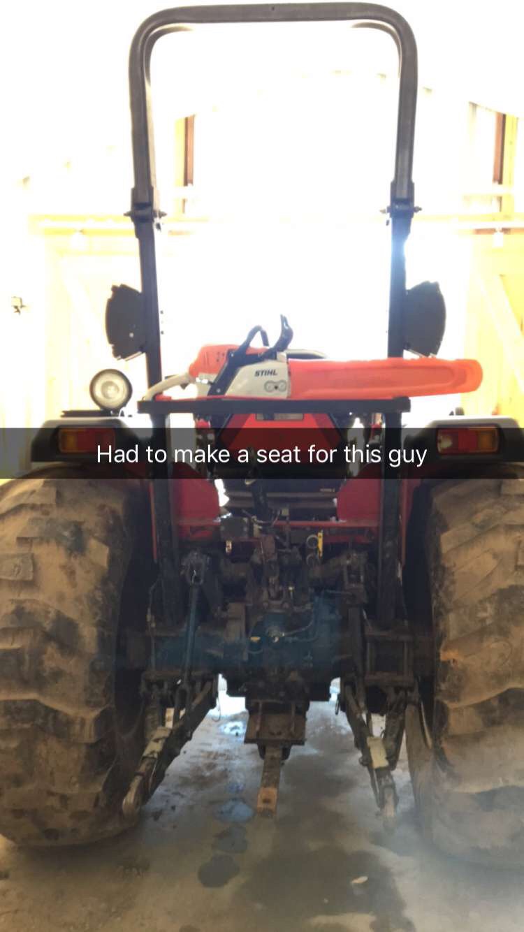

Really need a toolbox on my tractor.........
I thought about behind the seat on top off fuel tank area... any 2538 owners given it any thought?

That was one of the first things I did when I got my 2538. Placed it exactly where you indicated. I've used it multiple times already, adjusting box blade level, keeping extra pins and fasteners, as well as some wrenches, tape, and utility knife for "bandaid repairs" to get me back to the workshop.

Was an astronomical issue and eventually put my foot down and committed a half work day into solving the storage problem, chains, misc hand tools, Chainsaw. Nobody wants there saws bouncing around in the bucket when you're out clearing woods I just got fed up. So I found bolts that fit into existing bungs on ROPS and fabbed up what I guess u can call a pan from angle and sheet metal and for the chains I used pvc pipe mounted onto the plexi glass in front of the fwd/rev pedals. IMG_0708.JPGIMG_0707.JPG
