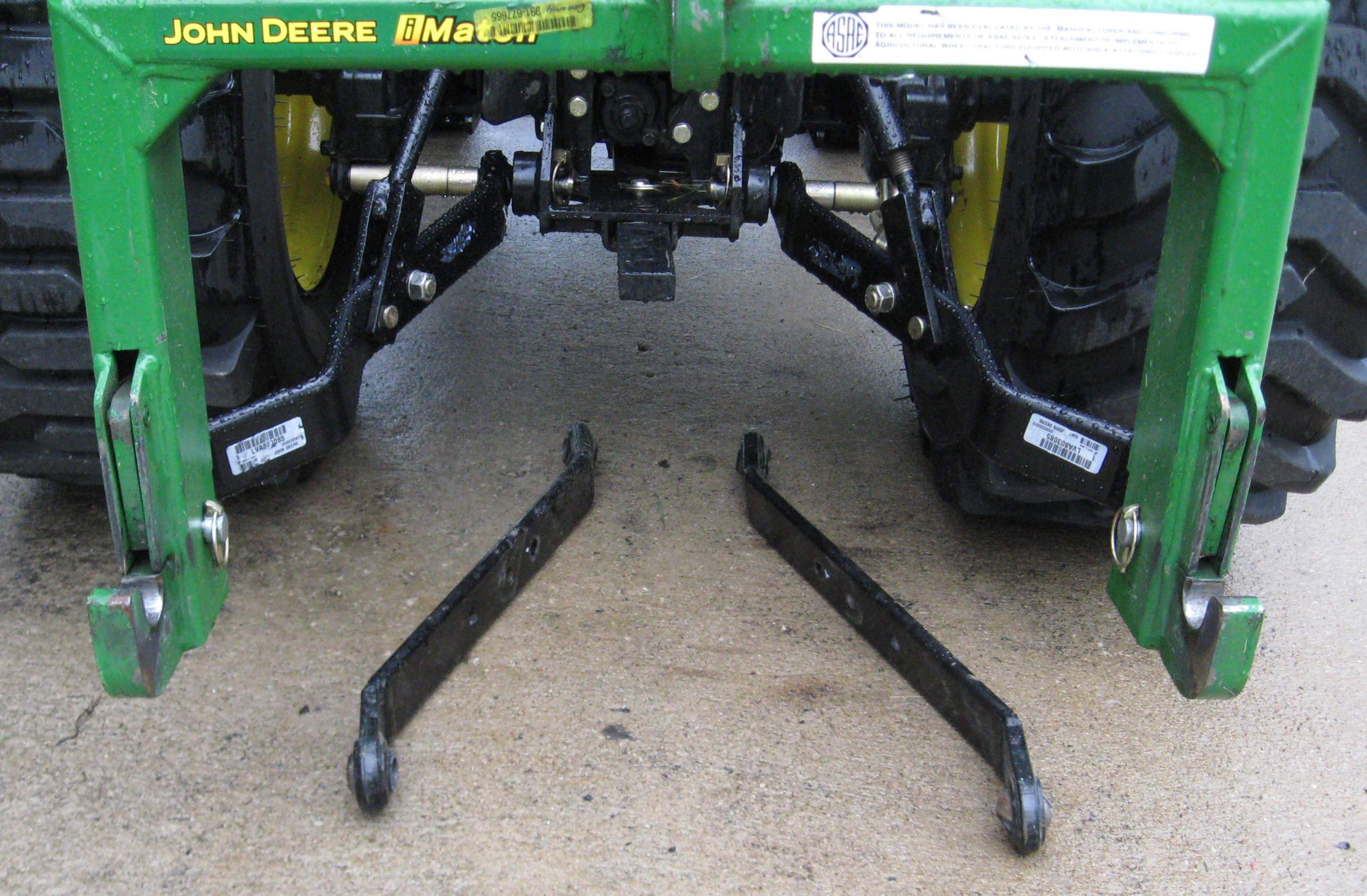

The 25/2720 have a problem with the lower 3pt arms rubbing the tires especially when you have the R4's. JD made a totally different style arm specifically for these two models. If you take care of this before you take delivery,it is a much smoother process (paperwork) for the dealer,and less of a headache for you:)

Here is a picture of the new arms (on the machine) compared to the old arms. You want to make sure they deliver it with the new ones because it is difficult to get the dealers to swap them once you've already got the machine.
Mine were rubbing even with the wheels set in the "wide" position.

Big difference between the arms. Thnku. I mow know what to look for. Just ordered the 2520 today. They discouraged me from going w/ the 61" bucket due to extra weight. Do those of u w/ that bucket on the 2520 feel the weight us a problem?
