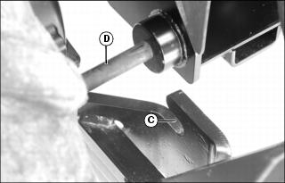

I am getting ready to buy a 2520 or possibly a 2320 with a 200CX and 46 backhoe. Looking at the 2520 it appears that the 3 point hitch has to be removed to mount the backhoe but the not all of the links on the hitch have quick releases, the lower turn buckles in particular seem very difficult to remove. Is there something that I am missing that would allow me to quickly switch from a box blade to backhoe and back again quickly.

Correct...the draft links, sway links and lift arms need to be removed to intall the hoe....no big deal once you do it a couple of times.
Below is a link to the 46 hoe manual....see the section on mounting/dismounting the hoe. This should clear things up for you.

Update; I guess the hoe manual does not show how to remove the draft links very well. Each side (draft arm, lift rod and sway link) is removed as one unit by removing pin that attaches the lift rod to the rockshaft arms. The draft arm and sway link is detached from the tractor by removing pin and sliding shaft "D" outward. This shaft slips through the draft arm and sway link. I marked each draft arm unit with a paint stick signifying Right/Left....helps me quickly get things back together when putting the arms back on the tractor.
Hope this helps........:)
