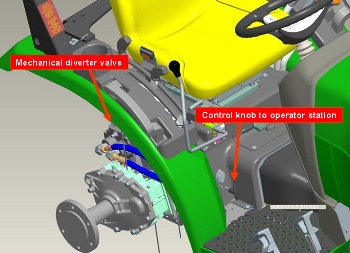

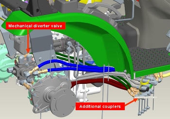

I got this in an email from my dealer, not sure of availablity or pricing. Part # is LVB25823. There is also one like it available for the 2305/2320(LVB25822).
2520 Mechanical Diverter for independent lift mid-mount mower/loader
Field install this kit to allow the hydraulic lines for the independent lift of the mid-mount mower and the curl circuit of the loader to remain connected at all times. Simply change the push/pull plunger knob on this valve from the operator station to switch functions and keep working. No more changing hoses or getting hydraulic fluid on your hands when switching between mowing and loader work.
This kit will not impact compatibility with backhoes, tire chains, or the 3-point hitch which means it can remain on the tractor with in all these applications.
NOTE: This kit is only needed if a customer has independent lift for the mid-mount mower AND a loader installed to be used at the same time. Also, note that this kit is for the 2520 only.

Very interesting, did he happen to mention a price?
   / 2520 Mechanical Diverter for independent lift #3
Neat, that would have saved me a bunch since I could also use it for a hydraulic toplink as well (albeit not as easily as a rear-facing lever). Even with two spools in the back of the tractor now I'm tempted to get it in case I decide on a front plow to support the tilt function.
The price for the diverter for the 2305 is $293. Did not ask about 2520.
   / 2520 Mechanical Diverter for independent lift #5
Just asked today and the 2520 is $393. part# LVB25823 Available in Jan. I will be getting one for sure!!
