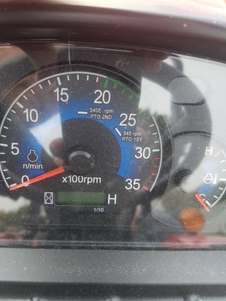

Branson guys, can you answer some questions for me? I have a Branson dealer 7 miles from me and as I was driving home from work I noticed they had a new tractor on their lot. It was a 2515R. So I stopped and took a look. They were closing so I didn't stay too long but will stop in some other time to drive it and see how I like it. I took a picture of the rpm pto meter as I was confused by it.
Question1: What is first and second pto rpm ratings?

I will answer the question 1 as I don't have a backhoe on mine, nor it's sold here.
On Branson tractors, you'll have two PTO speeds. The regular 540, which is the PTO 1st mark on the tachometer. Then you have the 540E PTO speed, being the PTO 2nd on the tachometer.
The 540E or 540 Eco, allows you to achieve the 540 RPM at the PTO shaft at a much lower engine RPM. Making less noise, using less fuel.
It's supposedly to be used with implements that don't require that much horsepower, like finish mower, sprayers, etc, but I've found that it handles higher loads just fine. I use mine all the time with both the tiller and the brush mower. No bogging down whatsoever.
This 540E, can also work as a third PTO speed by revving the engine to the PTO 1st mark, which will rotate the PTO shaft at 750RPM, but it's not that common of a speed to use. Most implements are rated to 540 RPM and in bigger tractors, rated to 1000RPM.

There's a PTO gearbox with two speeds. High speed gives you about 760 PTO rpm at 2500 rpm engine speed. "540e" engine rpm gives you 540 rpm in that high PTO gear. It can be useful when you have lower power requirements. There's less noise and fuel used.

Ok, thank you , I had never seen this so I did not know about different pto speeds

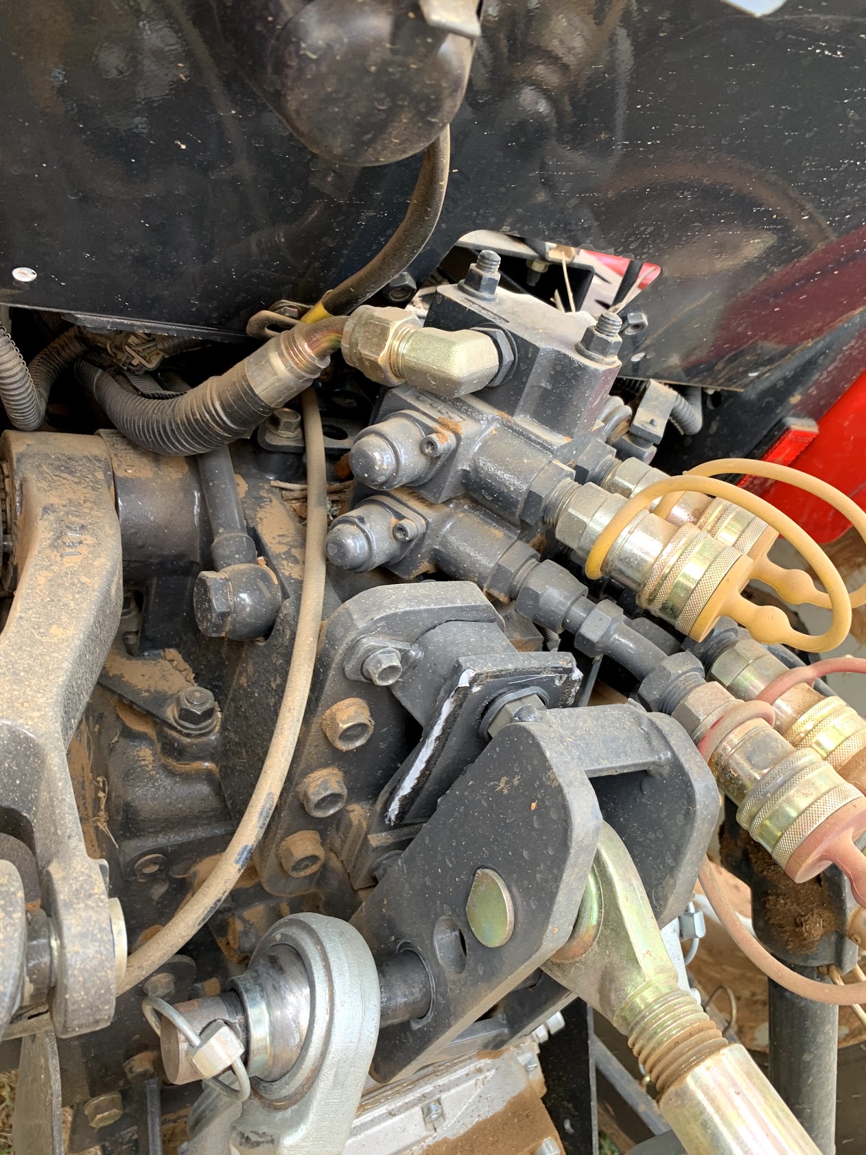

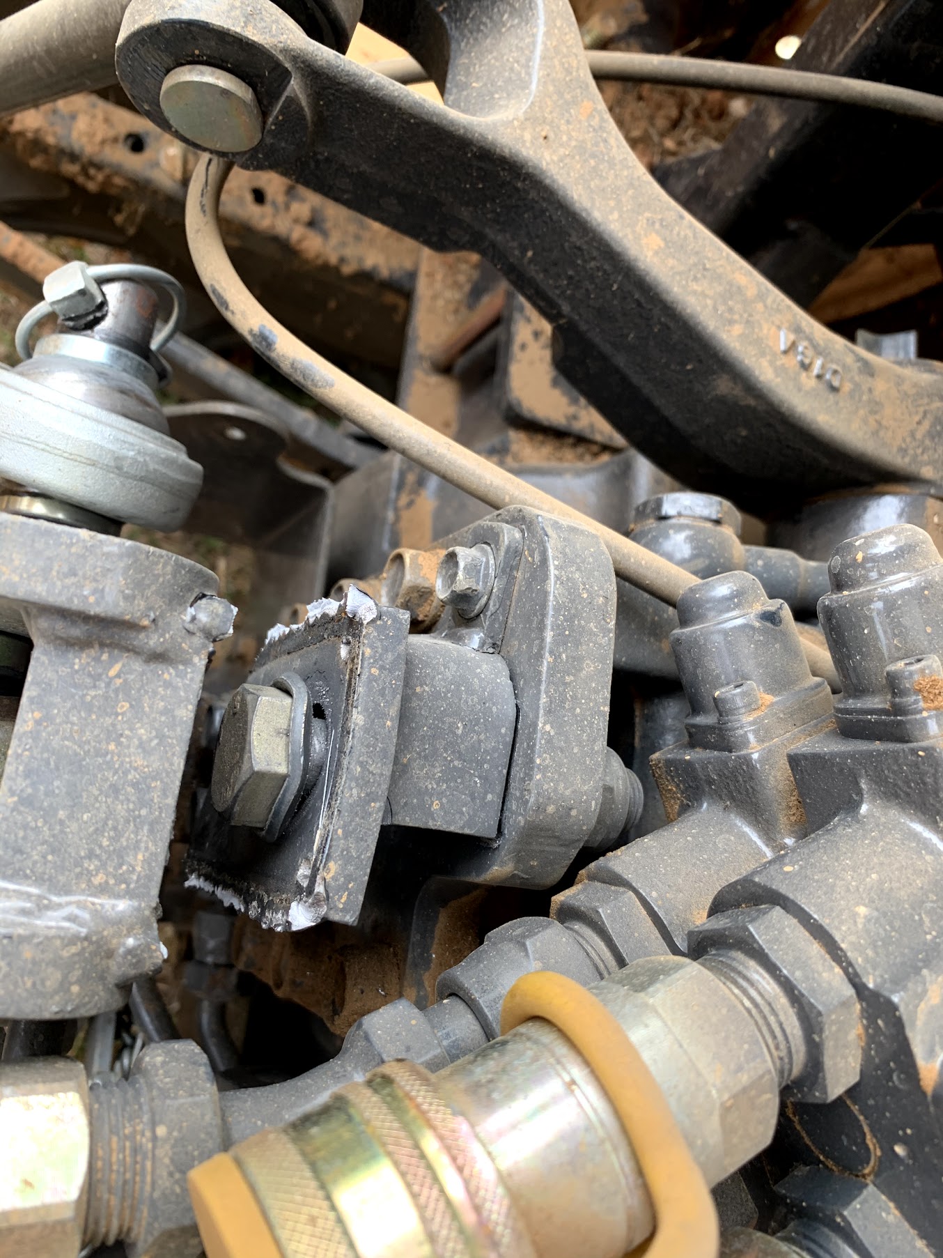

   / 2515R questions #9
Definitely avoid the 3 pt backhoes.
Here is another victim on a 3 pt backhoe.
It's a Branson 5025R and after 300 hours with the backhoe, it finally gave up. Luckily, the draft control comes standard on Branson tractors in Europe and it acted like a mechanical fuse. It only broke the welded assembly of the top link mount, which is easy to fix and reinforce. It's always better than breaking the entire top and rear diff housing.

As far as I can discover, the 2515 does not have the 2-speed PTO gearbox. It just shares the dash gauges with tractors that do.
