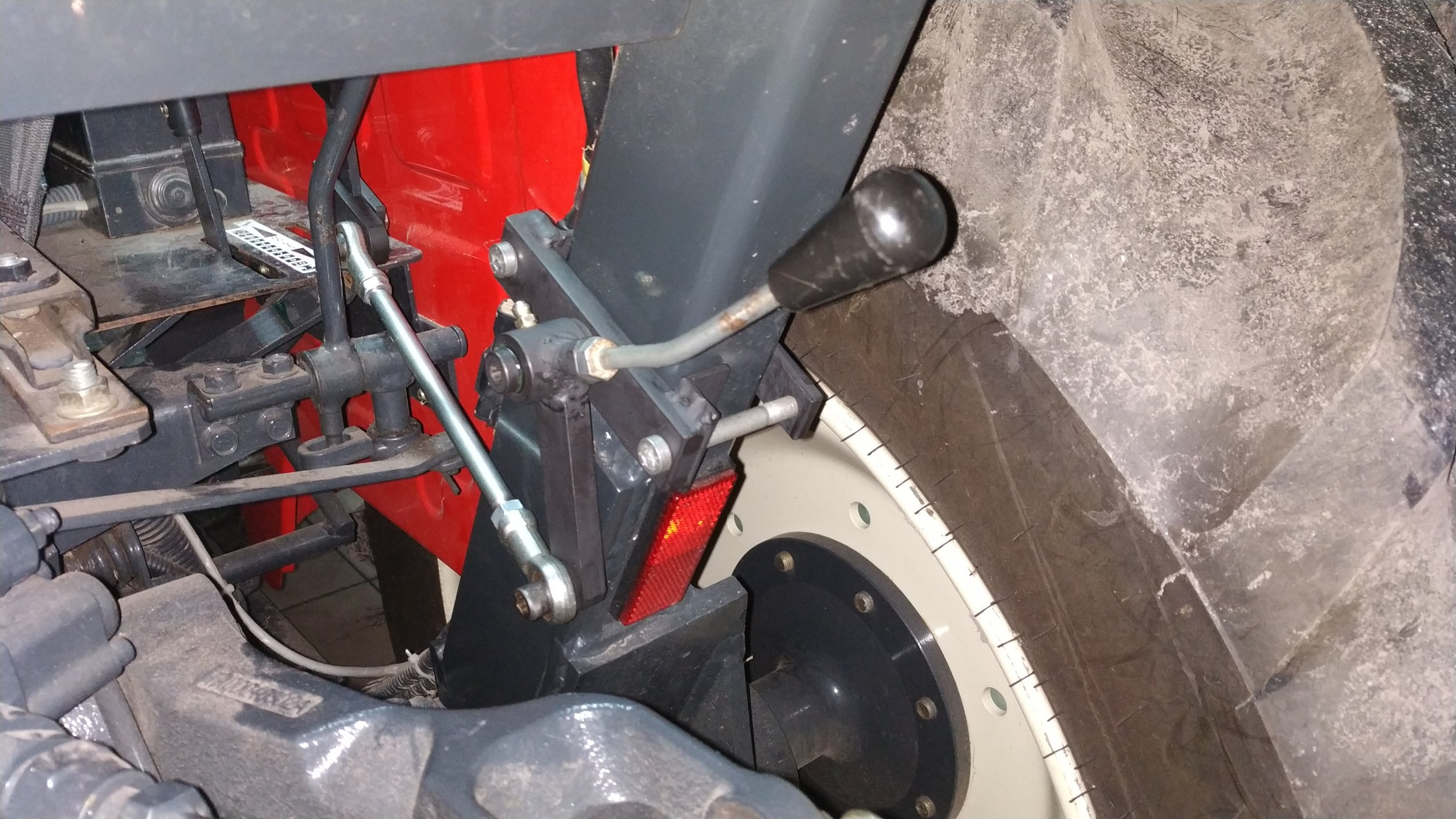

I'd love to see how you setup your 3 point lever extension and the setup for the rear adjustment from the back.

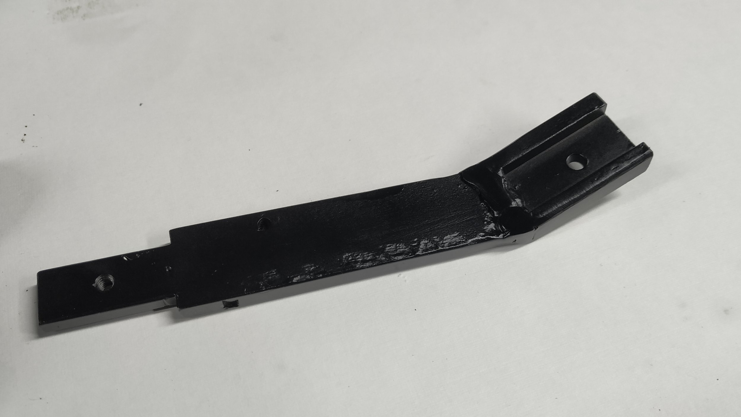

Here are some pictures of the extension. I don't quite remember how long it is, but it's between 5 to 6" long. I angled it about 5 degrees to the right to clear the seat and about 20 or 25 to the front. On the Gear transmission, the angle towards the front is limited by the gear shifter in the 4rd gear position. On an HST, it has a lot more space to work with.
In the 3rd picture, you can compare it with the Draft control lever on the left, which sits about 1.5" lower than the position control level without the extension.
For the rear 3PT lever, it's just a clamp that clamps on the Position control lever, then a rod with a couple ball ends. The pivot mount clamps on the ROPS. Everything can revert back to stock in a couple of minutes without any trace of modifications.

Wow! Great work and detail. Does the extension handle slide over the existing 3 point handle and hold with a set screw?

Thank you!. Yes, I machined a slot to fit the original handle and a single bolt holds it in place.
