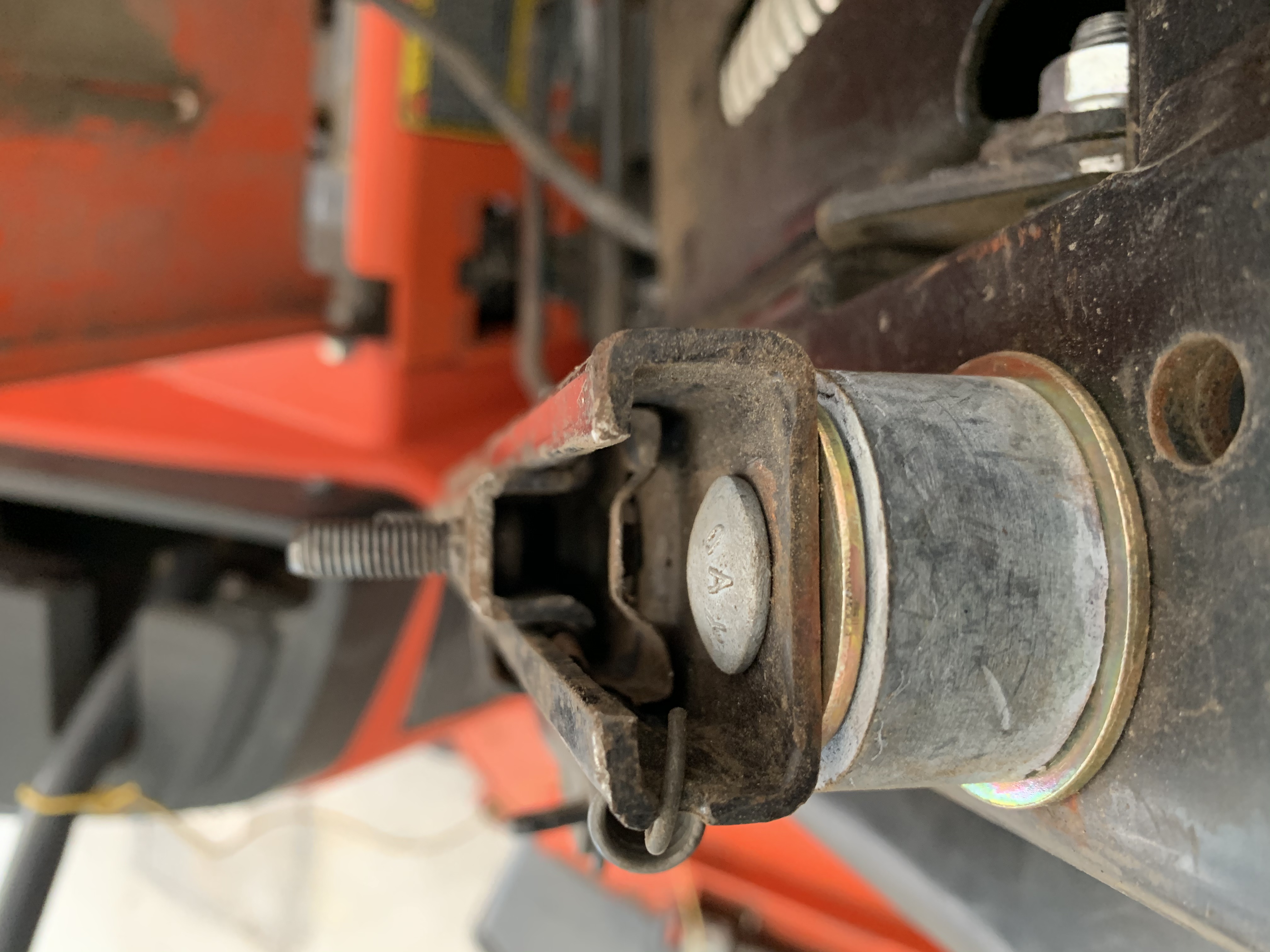

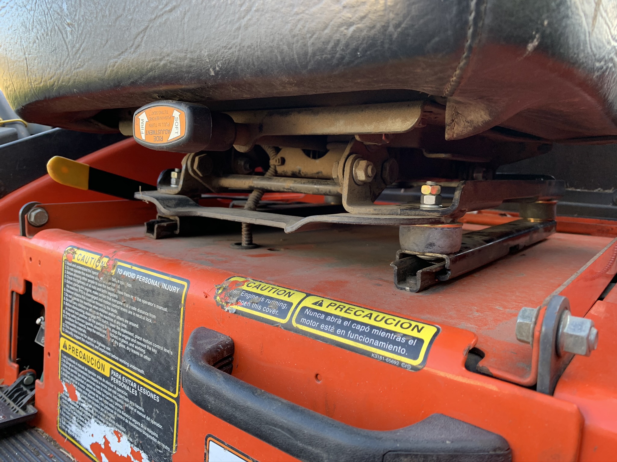

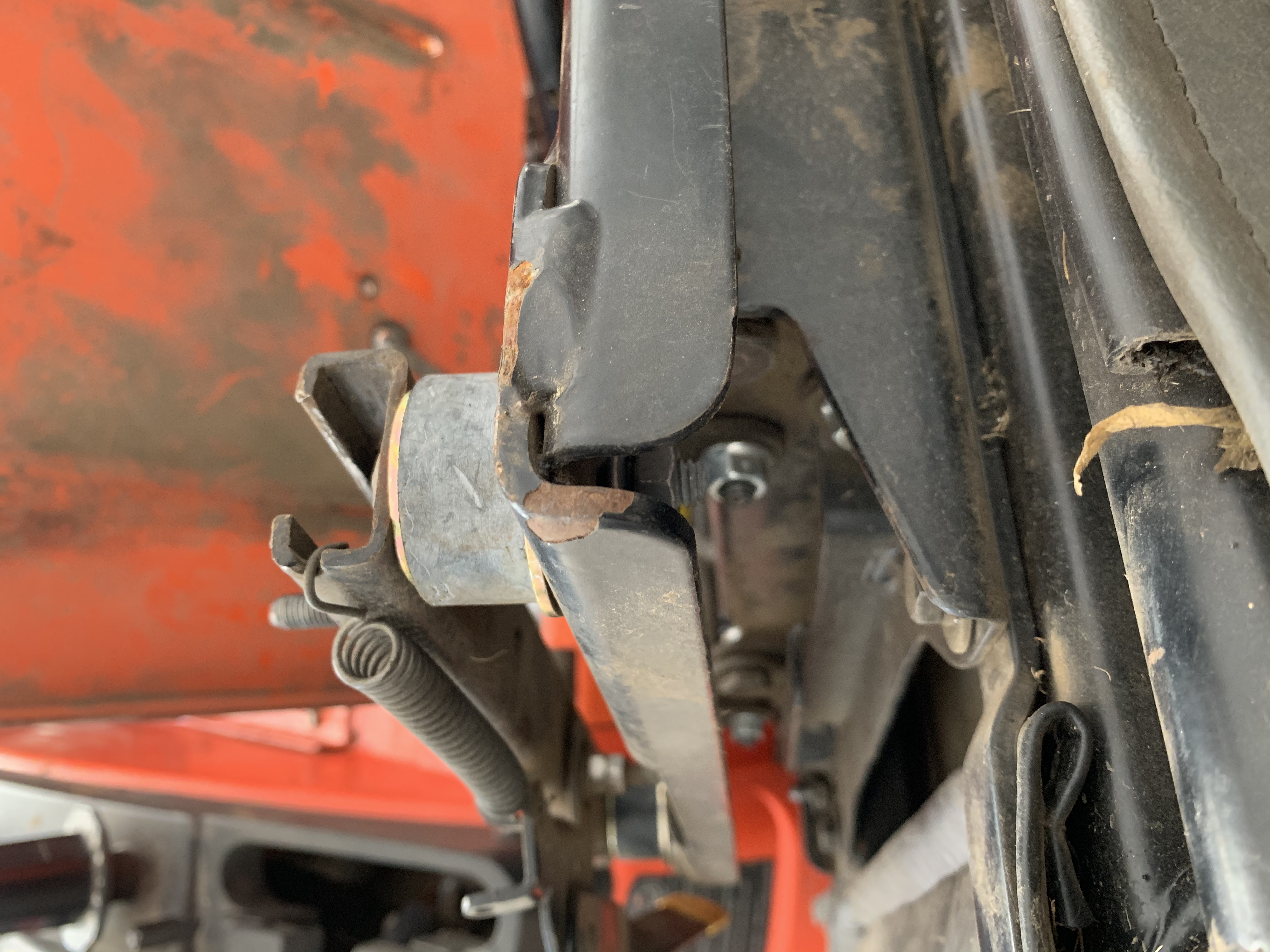

Love my ZD331
The seat suspension isnt that great for this lower back of mine (too many years of hay bales and carpentry work).
The seat sits on 2 sliding tracks.

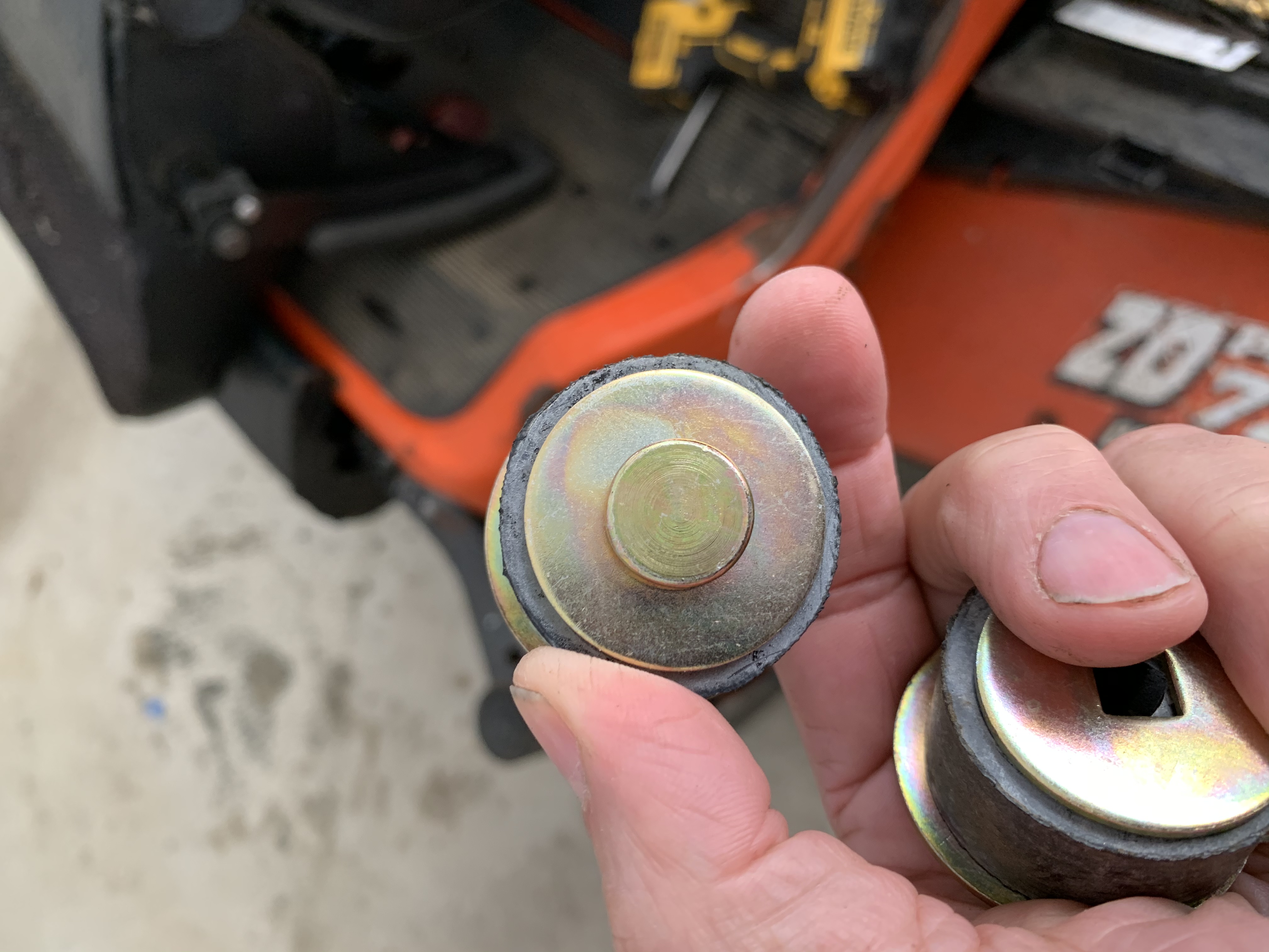

I removed the 4 bolts from the tracks where they bolt to the seat. In their place, I installed 1.5 expanding rubber plugs. These are the type that have a metal washer on the top and bottom to squish the rubber. The bolts that come with them are too short, so I purchased (4) 5/16 by 2 inch bolts, nuts and lock washers.
Put everything back together and mowed the yard.
For a small investment of $25 and 1/2 hr of time, it improved the ride noticeably. When the seat would bottom out previously, it would hit steel on steel. Now there is a bit of dense rubber cushioning.
One drawback is you sit 1 inch higher.
Only time will tell how long the rubber holds out.

My Ferris ztr seat actually sits on a spring (front part is latched to the frame and flips forward; rear portion sits on the spring).
If the rubber you put on doesn’t work, look at motorcycle or bicycle springs in their place possibly.

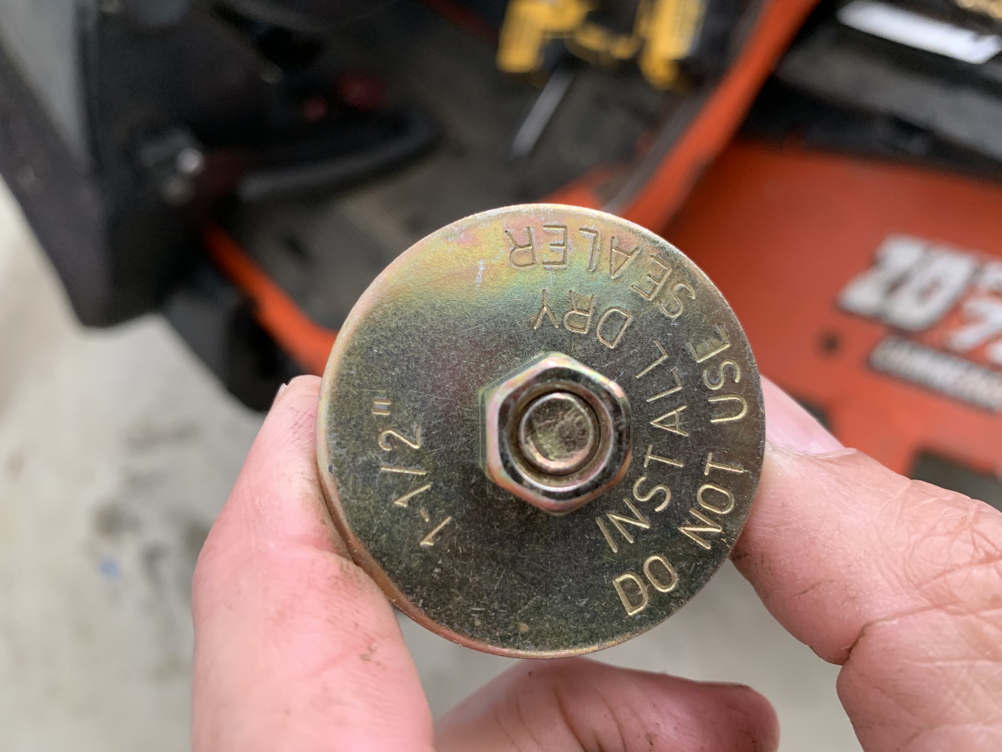

Nice idea, but I am not familiar with those rubber/washer assemblies. What do you call them and where do you find them?
   / $25 Zero turn seat mod to soften ride
They are called expansion plugs. Typically found in well stocked hardware stores. Theory is, when you tighten the nut, the rubber squishes outward, plugging the hole.
If you look at the picture of it, you’ll see a dimension on it. Say it’s 1&1/2” to 1&3/4”. That’s the size range of the hole it will plug. For example, itll work for plugging a hole in a missing tank drain plug.
Expect to pay $5-$6 a piece.

Thanks for sharing. I have the same suspension and have found that the linkage mounts start to bend over time and the travel is greatly restricted. I have been able to pry them back straight, lubes it up, then it's fine again. Just something to check for anyone that has this setup.
I'll have to find me some of those rubber pieces and try them out on my zero turn.
   / $25 Zero turn seat mod to soften ride #10
Keep the rubbers on the front and stack Belleville spring washers on the back bolts. You can tailor how much spring you have by the way you stack them.
