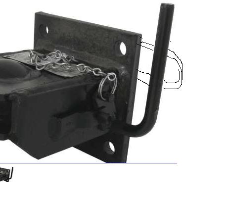

I just bought a new enclosed trailer (Bumper pull) and it has a Flat nose 2 5/16" coupler on it I'm not sure how or if you can add a lock to it, while it's either on the truck or setting unhooked, wondered if anyone else here has used this type and whats your thoughts on them.
The coupler looks like this one here.

I assume the round rod is the handle for opening and closing the coupler; can't you just weld a tab or loop to the mount plate that allows you to lock the handle against it?

   / 25,000 lbs flat nose trailer coupler help?? #5
Good idea. So simple yet smart.
