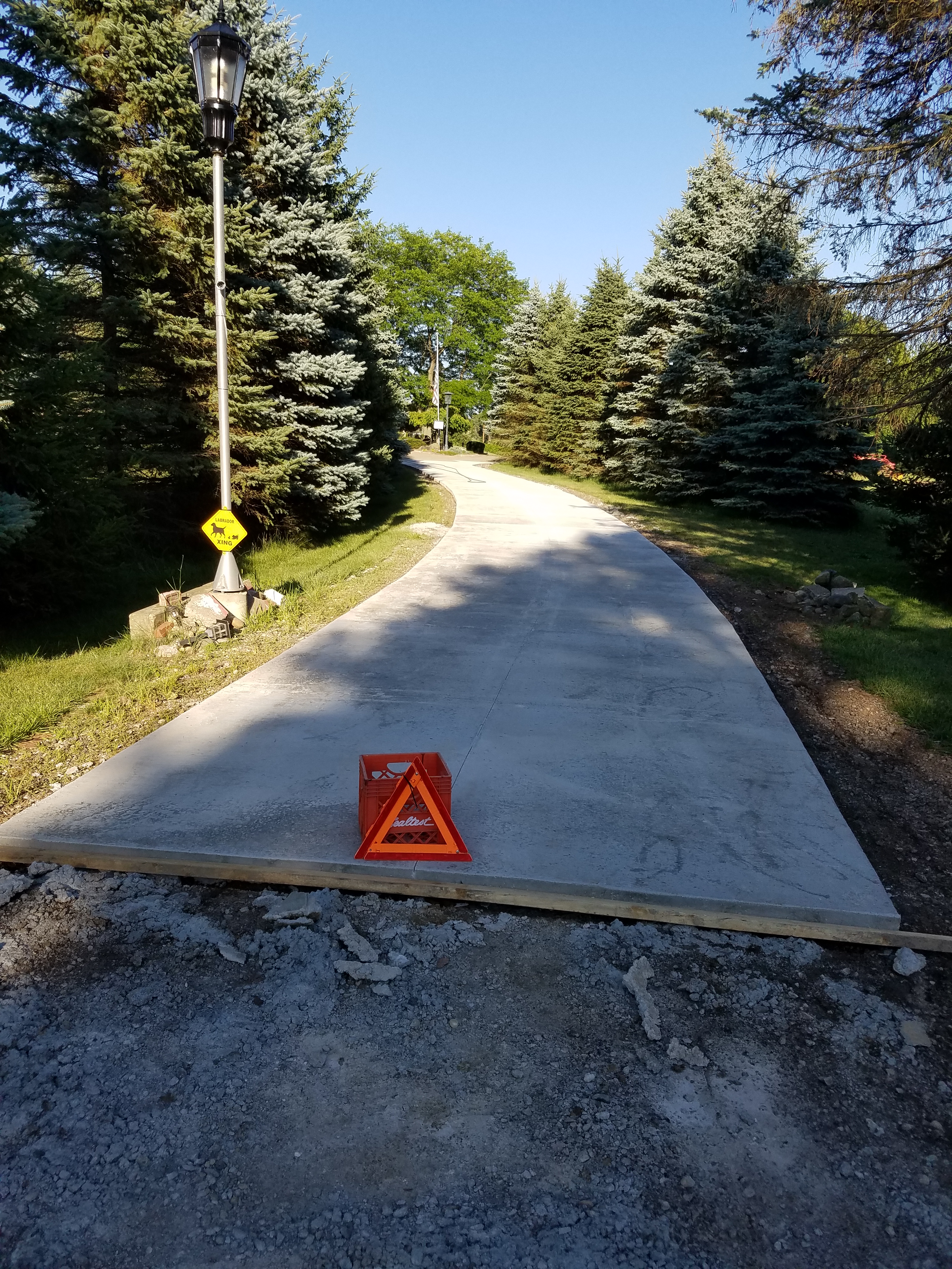

You don't need to have the concrete truck go back there. There are concrete 'buggys' which are well suited to carrying a yard of concrete at a time back to your new barn while driving over a driveway, etc.
I just had a 175' by 11' driveway extension done and my neighbor just added a slab floor to his 50 x 80 pole barn. The truck stayed on the public road and my concrete guy rode his buggies back and forth. One fills while the other runs and dumps. They have dual tires and go pretty fast. You could hardly tell where they ran. In a few places, he put plywood sheets down to keep the lawn from rutting. Usually where a sharp turn had to be made. His finishing crew was able to keep up with his delivery rate in a well orchestrated manner.
