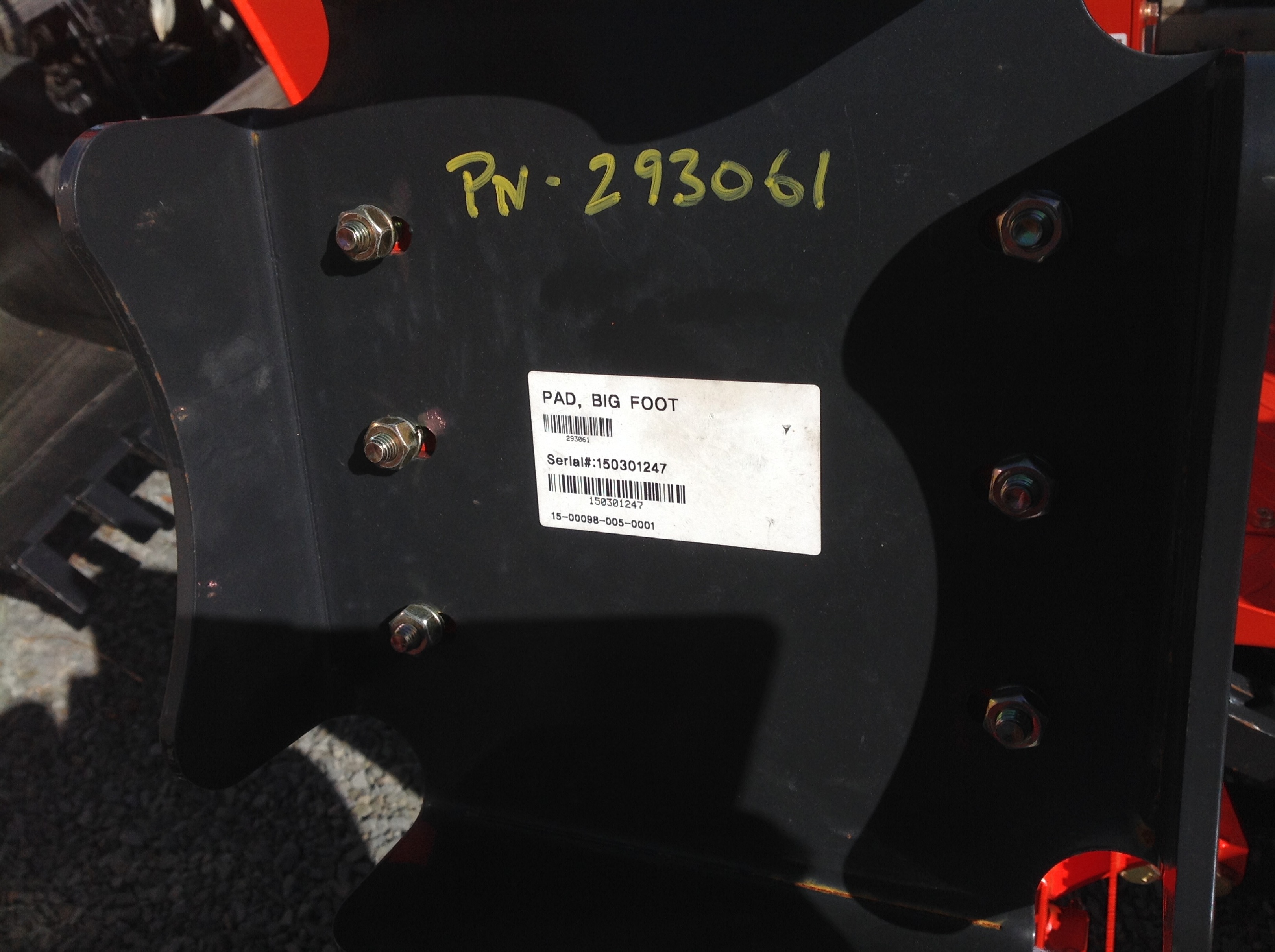

Any suggestions for commercially made outrigger pads for the 2475? Something that isn't flat as the flat ones slide around too much for my liking.

KIOTI has Dirt Claws for their backhoes. The flat plate on the stabilizer is for mounting Dirt Claws or Street Pads. Either type bolt through the holes in the stabilizer plate.

Here is the part# for the Bigfoot pads.
   / 2475 backhoe looking for better outrigger pads #5
I made my own out of 2" x 3", 1/4 " thick angle. 4 pieces per side, grind/cut the 3" leg to a triangle, weld together the 2" legs, and drill holes to match those on the bh. Just a though if you have the tools and time.
