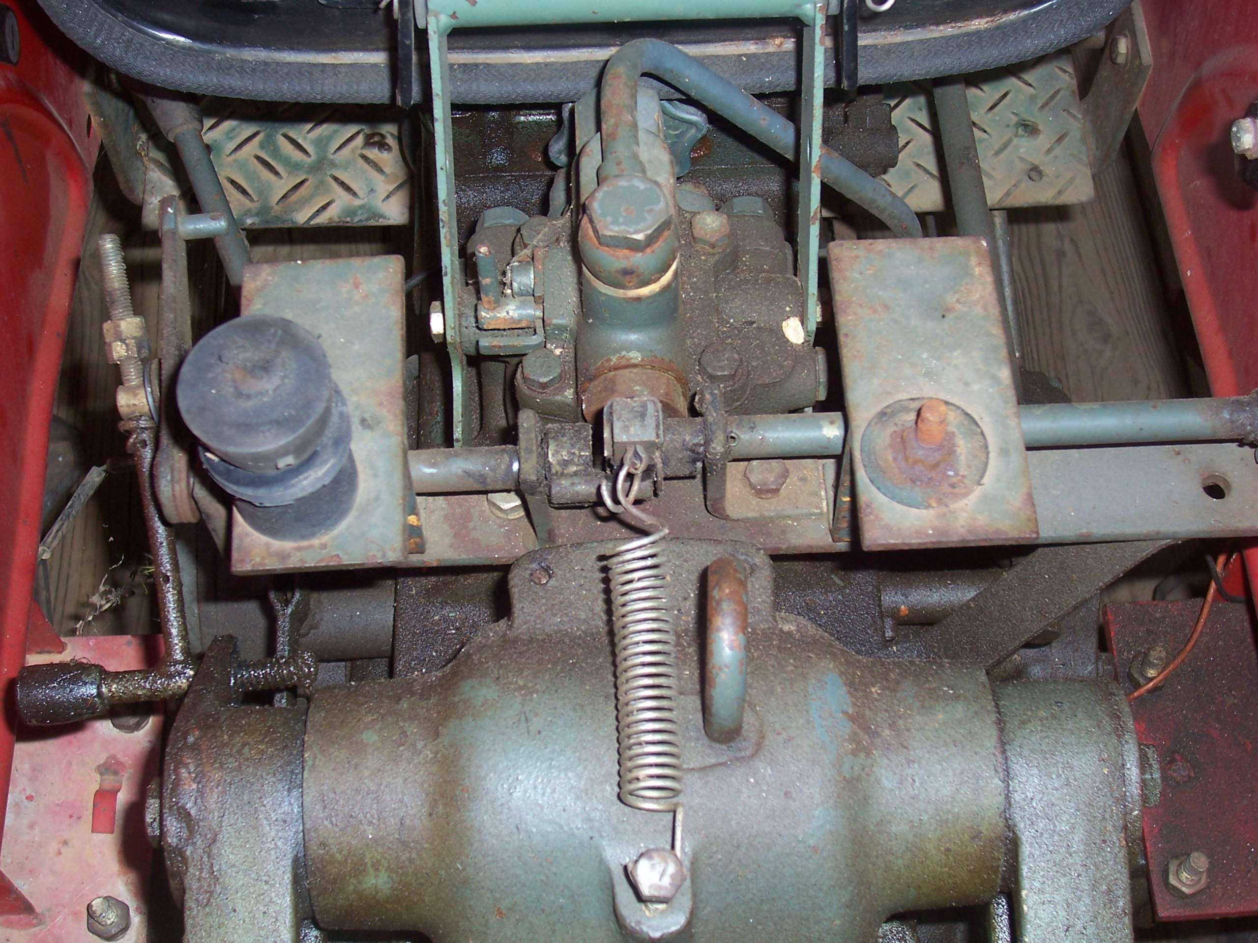

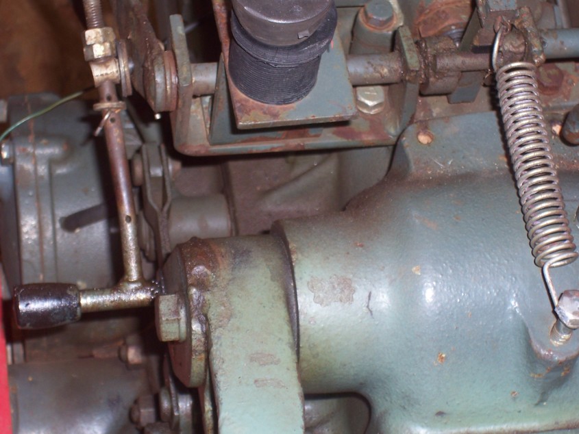

(My YM240) The paint on the double nuts is undisturbed, so the position control rod is apparently still adjusted the same as it left the factory.

I've had this come up a couple times. When the arms reach the height you want them to be at the highest point is were you set the adjustment to relieve pressure off the 3pt control valve.
